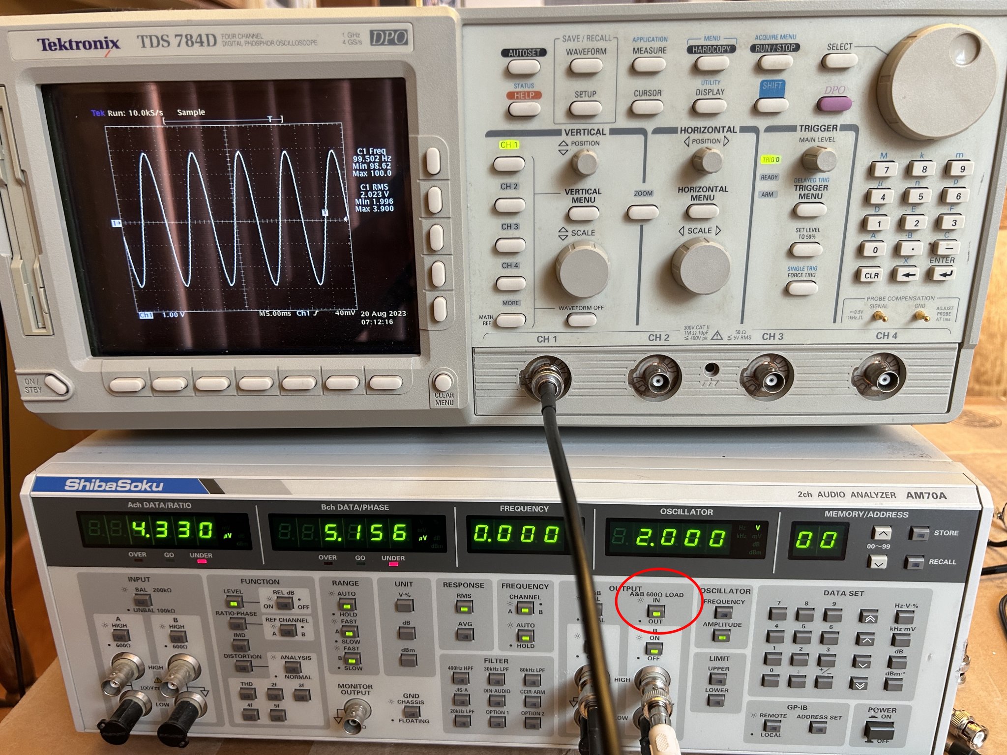

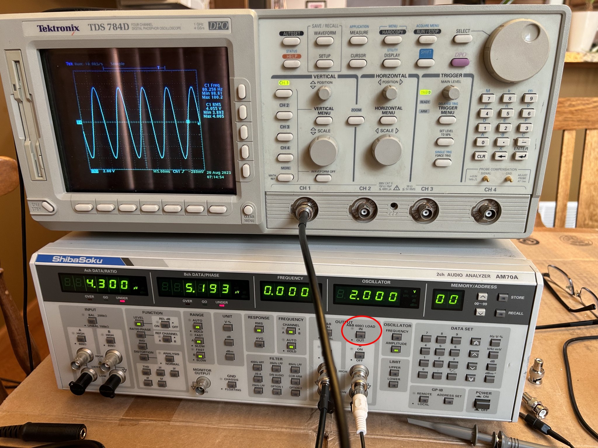

^ Thank you! I clearly have more reading to do. When I read the sentence in the manual... that's definitely not the way I envisioned what they were describing.
In the specifications section of the manual, it says...
3.1.1. Output Impedance · Balance/unbalance: 600 Ω terminator ON/OFF. Independently set for A and B channels.
In the operating instructions it says...
Push the “A&B 600 Ω LOAD” switch for turning ON (LED lights) to terminate the output with a 600 Ω resistor. When it turns OFF (LED goes out), output resistance selected is 600 Ω"
I clearly have something backwards in my brain.
With the scope set to 1Mohm input impedance.
Voltage of oscillator set to 2.000Vrms (display).
LED switched off => "600 ohm load out"
DMM reads ~4Vrms. DMM isn't terribly precise / accurate with low AC voltages.
Scope reads 4.055Vrms
LED switched on "600 ohm load in"
DMM reads ~2Vrms
Scope reads 2.023Vrms
Pics if they're helpful at all. The LED being described is circled in red.
Something ridiculous is just not getting through to me...
Mainly... I thought having the LED lit "600 ohm in" was proper because the measurements agreed, but now I'm not so sure.

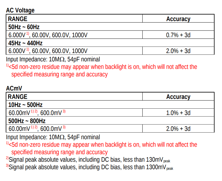

As I suspected the DMM is designed for measuring AC line, 50/60Hz, the 440Hz spec is for use in aircraft, as that seems to be the std freq that they use.
As an experiment you can measure the AC frequency response of your meter by comparing it to what you measure with the scope in parallel

Oooooooooh.... wait... did I misinterpret?
That's why I like pictures. I assumed... that the squiggle under range meant that it was good for between 10 and 500 Hz as an example with a certain level of precision / accuracy. Then... between 500 and 800 Hz it was still usable, but the accuracy / precision dropped a bit.
I always like cross-checking measurements / results between pieces of gear. I suppose it comes from my old life validating testing procedures / equipment. That's how all the questions about the mystery button 'came to light.' <groan> 🙂
When I don't even know what I'm looking at... it makes me feel a bit foolish reconciling what I used to be pretty darn good at with being a total neophyte in a different area.
^ Bear with the dodo, please.
So... I should have read the top set of specs (loosely) interpreted as...
This ACVM is intended to be used at a few common base frequencies vs. a range. Those frequencies are ~50 to 60 Hz ... OR 45 Hz OR 440Hz. Those are typical frequencies around which this thing was designed and intended for use. The precision / accuracy quoted is for frequencies near to those and those only.
It's NOT to be interpreted as...
This precision / accuracy stated is good for frequencies between around 50 to 60 Hz and between around 45 to 440Hz.
