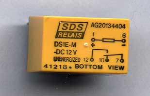

The Aromat or NAIS labeled DS series relays are designed for switching small signals. The contacts are bifurcated (forked) and made of gold clad silver. They are designed for high reliability in telecomm switching (i.e. audio freqs). They come in latching and normal types. They are relatively cheap at $3-4 each.
Relays that are not designed for the purpose can exhibit all sorts of weirdness with small signals. Contact resistance changes each time the relay closes, corrosion occurs and can cause rectification and distortion.
If you want to switch small signals, use a relay designed for the purpose.

Ric,
I am using SDS relays in my preamp (12V types). Have them for a while now, so i don't know if the type can still be purchased.
They work fine for me. Check www below for some info on the preamp.

Mark,
A couple years ago I would have wholeheartedly
endorsed the Aromat/NAIS relays for non-reed
applications. But my experiences lately have led
me to question whether anyone knows how to
make decent relays. Aromat is probably the best
vendor, and sadly their quality control has been
pretty bad the past couple years.
For reed relays, which might be the ticket for low-level
switching, I swear by Coto. One could also consider
mercury whetted, if you don't consider dry reeds
good enough.
If you want an Aromat for low-level switching, my
current recommendation is Aromat SX series, but
I'd test these after some exercising to make sure
they are staying good.
And whatever you do, if you intend to use the relays
for low-level applications, like "dry" switching of
signals in a preamp, NEVER use (or test) the relay
in a way that puts any amount of current (over a few
mA) through the contacts when switching.

BrianL said:Mercury whetted supposedly have the advantage of uniform contact resistance (though slightly higher than non-whetted) as the Mercury creates a new mating
surface each time you close the relay. Most mercury whetted reeds require a specific orientation so that the Mercury stays where it is supposed to be. I believe that Pickering makes a mercury whetted unit that claims to be insensitive to position
These types of relays are the only ones without contact bounces but infortunatly they are firbidden to buy in Europe. You are only allowed to buy them as replacement parts. Forget those!
My adwise is to use reed relays or common signal relay. I have good experience with Schrack(=ITT) and SDS (=NIAS)
http://www.elfa.se/elfa/produkter/se/20/2021520.htm
This form of relay is common and you have a couple of them to choose from. Most types are decent for audio but NIAS has always been "top of the line".
BTW: I have a couple of those at the picture for sale....
