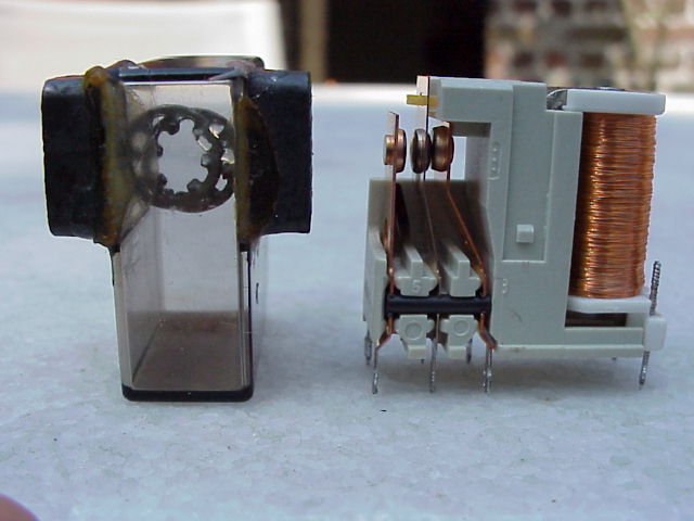

This is an output relay from a Stage Accompany SA900C.
Can anyone tell me why the two magnets are glued to the sides of the relay?
/Hugo

At a guess, it's to convert it into a 'bistable' relay. That way, a pulse of one polarity will switch it one way, and one of the opposite polarity the opposite. Saves having the coil permanently energised.
'Proper' versions are available, but are fairly expensive - this looks like a cheap bodge😉
I suspect that the magnet increases the sensitivity of the coil, so that less current is needed to operate it. This makes sense if the relay is normally permanently energised.
Some high sensitivity relays have built-in magnets; the polarity of the coil must be observed, and will not operate if the polarity is reversed. I've been caught out by this when checking relays.🙂

The magnets make the relay switch off faster.
This sounds like a plausible explanation. After all, we want it to switch off as fast as possible. The principle escapes me though.

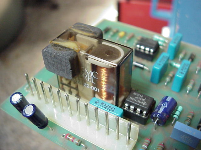

It's an EMC Soprel 011.51-22-001 but I can't find any info with Google.
The magnets are located near the contact points and the strongest magnetic field is exactly in line with them, not with the coil. Which doesn't mean your statement is incorrect.
The two washers I inserted take the natural position as seen in the picture.
If I try to move them, they always return to that same point.
/Hugo

Hi Hugo,
The intention of the magnets is to help the relay switch off a bit faster as Jacco has suggested.
It's a technique that is used in high voltage switching. The magnets pull the arc formed as the relay opens towards the magnets because of the plasma's negative charge. As the plasma formed by the arc is now curved rather than straight across from contact to contact, is breaks slightly sooner.
This is significant where thousands of amps are being switched as it saves a lot of contact material being vapourised. Whether it's of any real use for an audio power amp where the arc length is a fraction of a millimeter is debatable.
Another technique for breaking the arc is to blow the arc out of the gap between the contacts with compressed air. I haven't seen this technique use for audio amps however!
Cheers, Ralph.

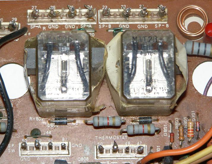

"When breaking under load, an arc is formed that can reach temperatures of up to 10,000 °C. This arc must be quickly extinguished (less than ten milliseconds) to prevent contact platings from melting. The zero-crossing that occurs every half cycle with an AC voltage is useful in this regard. Since there is no zero-crossing for DC voltages, other techniques must be employed.
An arc is essentially electrical current flowing through ionized air. Permanent magnets are used to stretch the arc and thereby extinguish it. Arc-chutes are required for higher voltages. These stretch, cool and disperse the arc. Most arc chutes are made using small metal plates and additional blowout magnets."
The picture below shows another example (output relays in an old Nikko Alpha amplifier).

Interesting, particularly the difference made between AC and DC.
In an amplifier, both conditions can occur at the same time.
From the text, I understand that the magnets have most effect in a DC fault condition.
Nice picture of the Nikko amp. It looks rather end of life though. 🙂
/Hugo
Magnetic blowout relays are also produced for lower voltage ratings.
Lifespan is supposed to be highly lengthened, or DC-load can be very much higher with equal life expectancy. See Tyco Agastat relays for an example.
There are also serial production magnetic latching relays, with permanent magnets within the relay case, the magnets are placed in line with the relay contacts. The magnets in these relays constantly pull the relay contacts, enabling faster switching times.(but higher switch-on response time) Supposed to be good for chatter, an RC seems a simple chatter cure.
