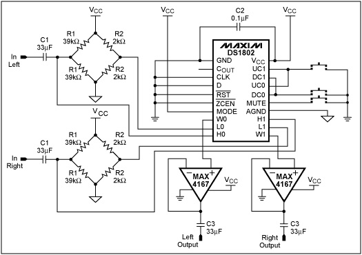

I want to change the alps 100k volume pot that my preamp has. I'm sick with the channel balance difference that most of the pots have especially with low volume positions. Whenever i measure a pot there is always a difference with resistance values between left & right channel 😕. (even with expensive ones).
So i was thinking about a relay switch board & i have 2 things in mind from ebay :

Another possibility I will try next days
a volume control with Maxim DS1808
no software only push buttons only unbalanced, Nelson uses it in XP10 so the sound must be good...
a cheaper try than the TKD pot and many steps....
only disadvantage it works only up to 2V input sources and at the output you need a very high impedance, best 1 Mohm..
