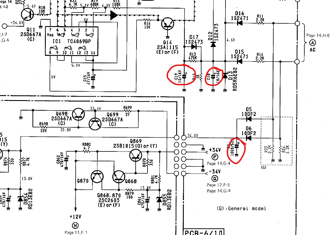

The relay, RL1, in my Citation 25 has an erratic function as it doesn't always close (click) when changing programs and if I don't make sure it clicks (closes) through quick program changes before shutdown then DC leaks to the output stage which makes it "pop" " in the speakers.
It seems that the control current to the relay is not sufficient? Which component(s) could be to blame for this?

The relay seems to be a normally closed type which shorts the audio to ground to mute and so it should immediately drop out on power off. Its possible any issue could be cap related in the area that detects presence of AC power.
The relay coil is switched across the -34 volt rail to power it but with current limiting by the series resistors. It is a bit of a bizarre looking circuit tbh 🙂

I think you need to take some voltage readings beginning with the voltage across D18 which will show what the relay sees. It would need to be zero volts to close what we assume is a normally closed relay.
When you turn the power off by the mains switch that has got to remove all voltage but one question is how quickly it falls. Again see what happens with the voltage across the relay.
You have to start somewhere 🙂 and some initial tests might get a handle on what is happening.
It looks like the base of Q13 needs to be pulled 'low' to turn the relay on and unmute. To mute the base will be at 5 volts and Q13 off.
It seems like power off by the main switch does not remove all voltage quick enough, but pulling the plug out of the socket does.
Something is holding the relay at power off by the main switch or remote control.

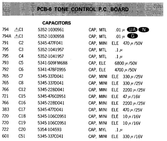

That cap may or may not be critical with regard to how quick the rail collapses on power off.
If the unit has a hidden history and has been recapped with caps higher in value than the design spec then that could cause issues. Bigger isn't always better.

Not only 2 x 270 Ohm but also Q698 and Q699. Someone wanted desperately to have the relay connected to -34V.
Checking if a 1000 or 470 µF is used is the first to do I think. And what is the relay type and its working voltage? If it is an open type it may also be dirt/dust delaying its action.

So number '5' is worth looking at. Try and see what triggers the relay driver has and what the driver output does.
You could begin by looking at pin 6 of IC1 and confirming it behaves differently when the fault happens.
Also C15 and D12 and D891 look to provide a means of retaining power for a very short while on IC1, long enough for it to set pin 6 at 'high' (same voltage as pin 14). Lets see if all that works. C15 is critical as it works as a battery keeping the chip powered.
You have to look logically at all the 'inputs' to that relay drive circuit and see what is different when the fault occurs. It could be a passive part like a leaky diode or bad cap or it could be that the circuit is working 'correctly' but in response to a faulty input such as the mute function to Q10. You have to look for what is different when it fails to work.
Definitely check that supply to IC1 though and that the supply remains present for a little while on power off. It may only be for a couple of seconds but that is enough for the other supplies to collapse and for the relay not to be able to pull in (and pass the pops)
I mean measured in DMM diode mode. If it is unreliable it would not let the hex inverters input voltage dropping to 0V fast enough at power off. Honestly I am guessing as the circuit is complicated with regards to error possibilities.
