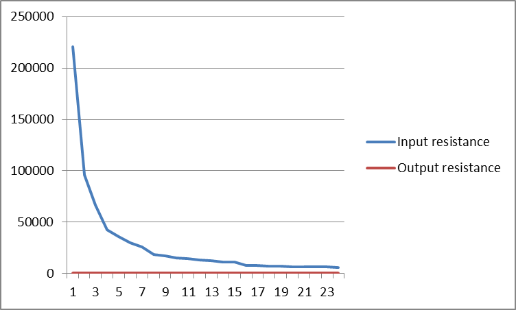

I have just tried one of these:
Advanced relay volume control board / HIFI volume board / relay volume board | eBay
When inserted into my 2P29L based pre-amp there was no switching noise, except for one position which was at about 2-3 oclock on the dial. This didn't seem to bad to me as I would anticipate the system to be deafening by this point! So that was good.
When I played music through it, certainly not bad at all (I haven't had time to give it critical listening). Still I am encouraged.
The big issue I have had so far are the steps. I cannot get beyond the first 6-10 steps out of 256 before the volume is ludicrously high! I guess I need to change the resistor values to provide a decent range. However, I haven't yet fathomed the switching order to work which to change and to what value.
Any thoughts?

The simplest remedy would be to provide additional attenuation until you get a more usable range
I did a volume control using CD4066 switches for 1024 steps. I had to logarithmically adjust the counter to get smooth volume. sounded great with no switching noise
I did some measurements for the input and output resistance. So far I have only measured the first 30 steps or so. The graph looks like the image below. The output resistance is around 300 ohms. If I advance the control a lot it eventually peaks at about 47K, but only for a few settings. The input resistance varies considerably, but on some settings goes as low as 300 ohms. I am no expert but 300 ohms seems far too low to be driven properly.
The resistors are through hole, so they could be replaced. Problem is I am not sure how it has been configured. I will try and trace the wiring.
Any thoughts on the values or how to correct?

Looks indeed not good.
After you figured out the diagram of the device you have, use this to find the correct resistor values:

When measuring the resistances how are you connecting your multimeter? Do you have anything connected to the input or output?
When measuring, I disconnected the board from the pre-amp, so it wasn't affected by the grid leak resistor. I then put the multimeter either between ground and one channel input for input resistance or ground and output to measure output resistance. I also measured series resistance by measuring from input to output.
