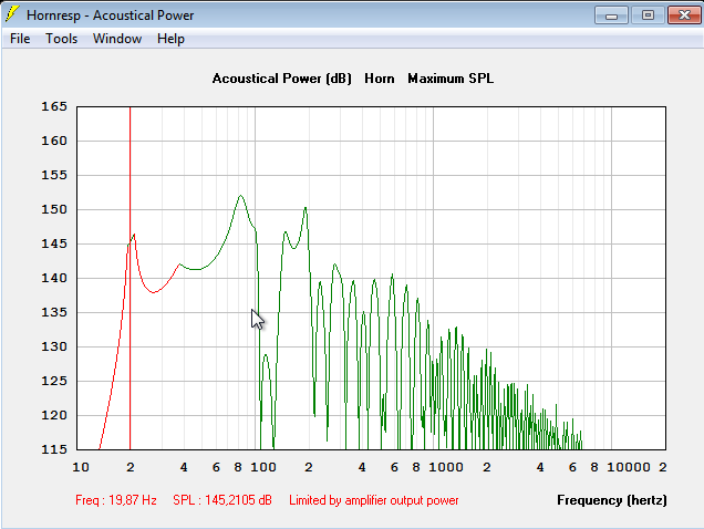

Thanks Art, in my case the horns indeed are against the wall.Zwiller, horns are not much of a friend in a small room, unless the horn mouth is against the wall, spacing out from the wall can be a mess.
Art
