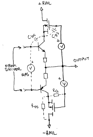

Eva said:
[BJT-MOS cascode output
ilimzn: could you draw it?
Here is an example - of course, this one uses 'complementary' MOSFETs and BJTs.
Note that Cbc and Cgs, drawn in the pic, are actually the internal capacitances of the BJT and MOSFET. For LAPT transistros such as 2SC2922, 2SC5200 etc, Cbc is not small, neither is reverse collector leakage, but even so, typical Cgs of a MOSFET in the position as drawn will overwhelm both, essentially there is no path for the Cgs to discharge or the MOSFET remains 'stuck' on, and the cacode does not work.
Because of this you have to add Rg and/or Rds as shown in the lower part of the drawing.
The cascode voltage sources can of course be capacitors in a bootstrap arrangement. The voltage on them defines the maximum voltage the BJTs will see across C-E, and in order to be inside the SOA and get good gain, and accounting for the required Cgs of the MOSFET, this will usually be about 10-20V. As long as this voltage is at least somewhat below 20V, the MOSFETs do not need extra gate protection zeners, and can be driven into Rdson region, by the gate voltages being bootstrapped over the rail voltages, so you get very little rail loss.
Even so, gate zeners can be used on the MOSFETs to provide current limiting. A remote way to short the MOSFET gate to source can be used to switch on/off the output stage completely, eliminating the use of relays for output protection.
As amp power goes up, over about 35V per rail, most dissipation has to be endured by the MOSFET, and they can easily be paralleled for that, or more current. Since gate drive is not a problem (it's driven from the output of the amp where current is abundant) very large MOSFETs can easily be used.
