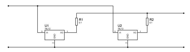

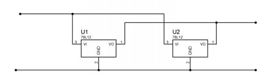

I dun think that will work...coz one regulator will tend to take all the current...and just shut itself down...letting the other take over...and then shutting it down as well...
Possibily...you might want to try tweaking the resistor value to get faster better response...I would try 1ohm first...

make sure (if you're going to use 1 Ohm resistors, which i DON'T recommend) that these resistors can dissipate enough...
Grtz, Joris

You MUST use that series resistor or you'll see your 7812's burn one by one, but I would use something between 0.1 and 0.2 Ohm, that should do the job.
Grtz, joris

Can you switch to 7812 instead of 78L12?
You can probably connect them brutally in parallel because they have current limitation but they are not indestructable. If you add resistors they will probably share current better but if they don't misbehave without resitors, don't use them.
Switch to 7812 seems to be a better solution if that's possible.
ummmmm...the series resistor goes on the input
the 78 series regulators have built in current limiting so the resitors on the input act as a current sharing load
and I reccomend a pass transistor also
a pass transistor is cheaper and you don't have to worry about one regulator hogging the current. In fact, you can get a linear regulator to oscillate even without trying. (Nat Semi does have an application note showing the LM317 as a switching regulator!)

Pass transistor it is
Then Pass Transistor is is!
