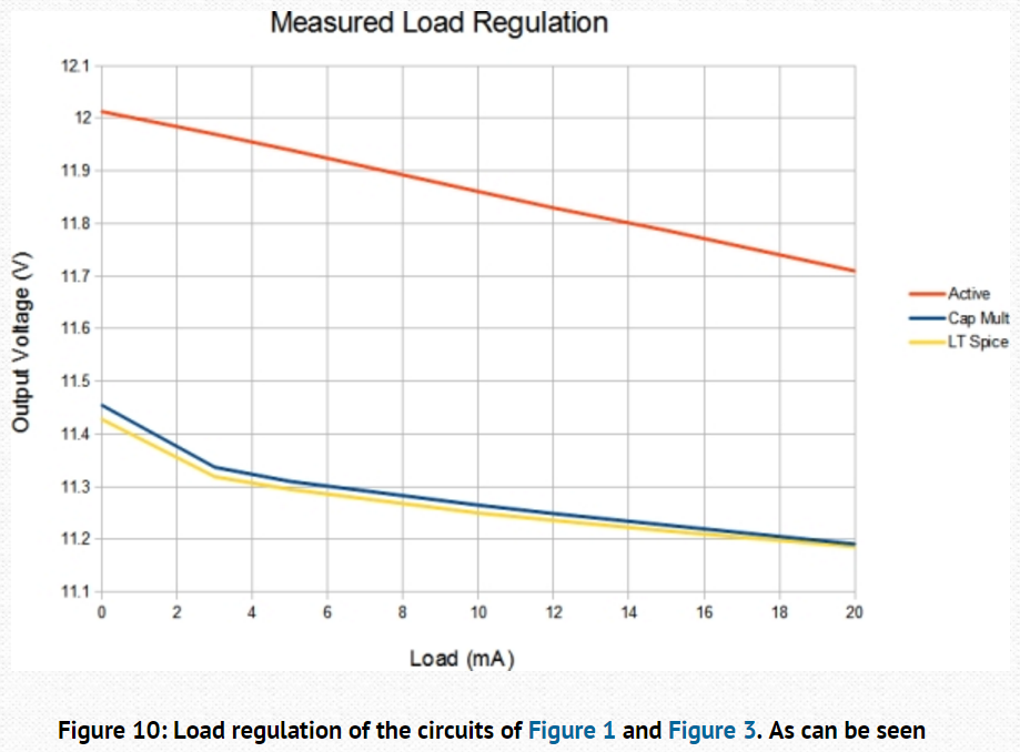

I think it is a terrible idea to increase the regulator's output impedance to 15 ohms.
Output Impedance = slope = delta_V / delta_I = 0.3V / 0.02A = 15 ohms

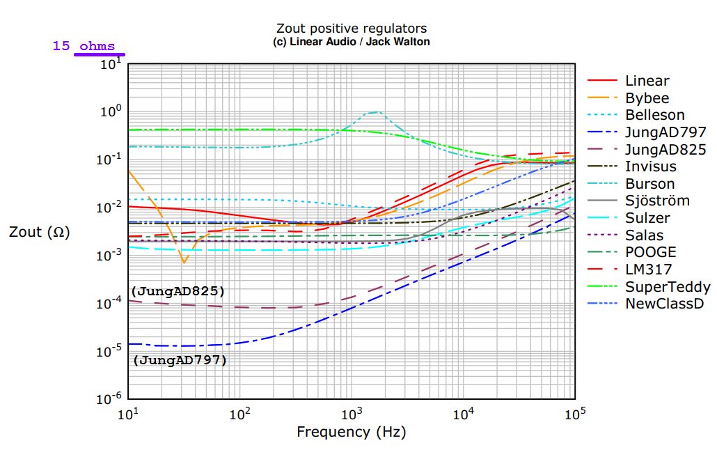

I think Walt Jung had much better ideas for achieving ultra low noise voltage regulators without compromising output impedance:
I've copied the Measured Output Impedance graph from the Linear Audio downloads page, and added a line at Zout=15 ohms. As you can see, this is much much worse than any of the tested regulators, and six orders of magnitude (a factor of a million) worse than the Jung design.
