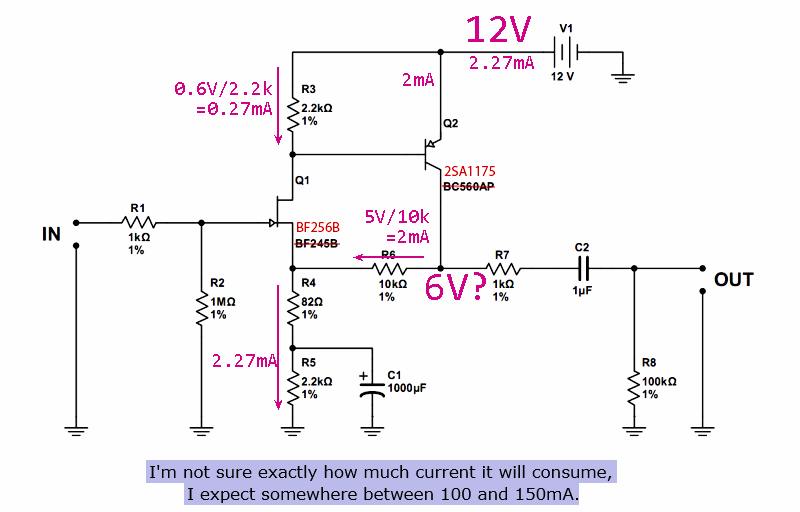

I've built a pair of this simple JFET pre-amp, substituting a BF256B for the BF245B and a 2SA1175 for the BC560.
I'm wondering how to power them, what sort of regulator to use, there are so many options from the humble 78xx IC to really complex fully discrete circuits.
I'm not sure how exotic a regulator this circuit needs to sound good, I like the idea of a discrete circuit rather than an IC, but would that be overkill for this pre-amp?
Is there a discrete circuit that offers better performance than a 78xx or LM317 that is pretty simple with a fairly low parts count?
I'm open to suggestions and in need of guidance.

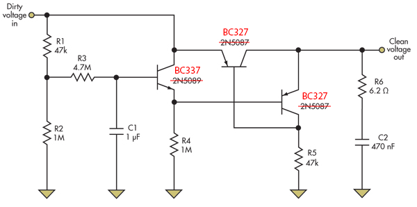

I don't have BC560B and BC547C transistors, I do have BC327 and BC337. Looking at the OnSemi datasheets, they look to be direct equivalents but OnSemi calls the 560 and 547 'low-noise' whereas it doesn't use that label for the 327 and 337.
I also have SS8050 and SS8550 transistors I could use, but I have no idea how these various options compare in terms of noise, they all seem close enough in electrical characteristics to work in this circuit.
Any thoughts or info on transistor selection before I go ahead and build this circuit?

....I'm not sure exactly how much current it will consume, but I expect somewhere between 100 and 150mA.....
Even if both transistors are dead-short, it's all like 10k and 2.2k resistors. 100mA in 10k is a thousand volts. You only got twelve.
For quick estimation, assume the final device and its resistor split the supply "50:50". It may be 33:66 or 66:33 but no great difference.

Now you see my purpose in building this thing - I am only a beginner and really don't know what I'm doing, despite all the study I've done thus far, so I thought it was a good idea to build some simple circuits using a small number of cheap components like common small signal transistors and 1/4w resistors as a learning exercise - if it blows up, sets on fire or melts, I haven't lost much in monetary value but have gained much in knowledge and experience.
So, that simple preamp circuit has a consumption of 2.27mA, I'm not sure I understand how exactly you calculated that, I need to learn more in that area, clearly.

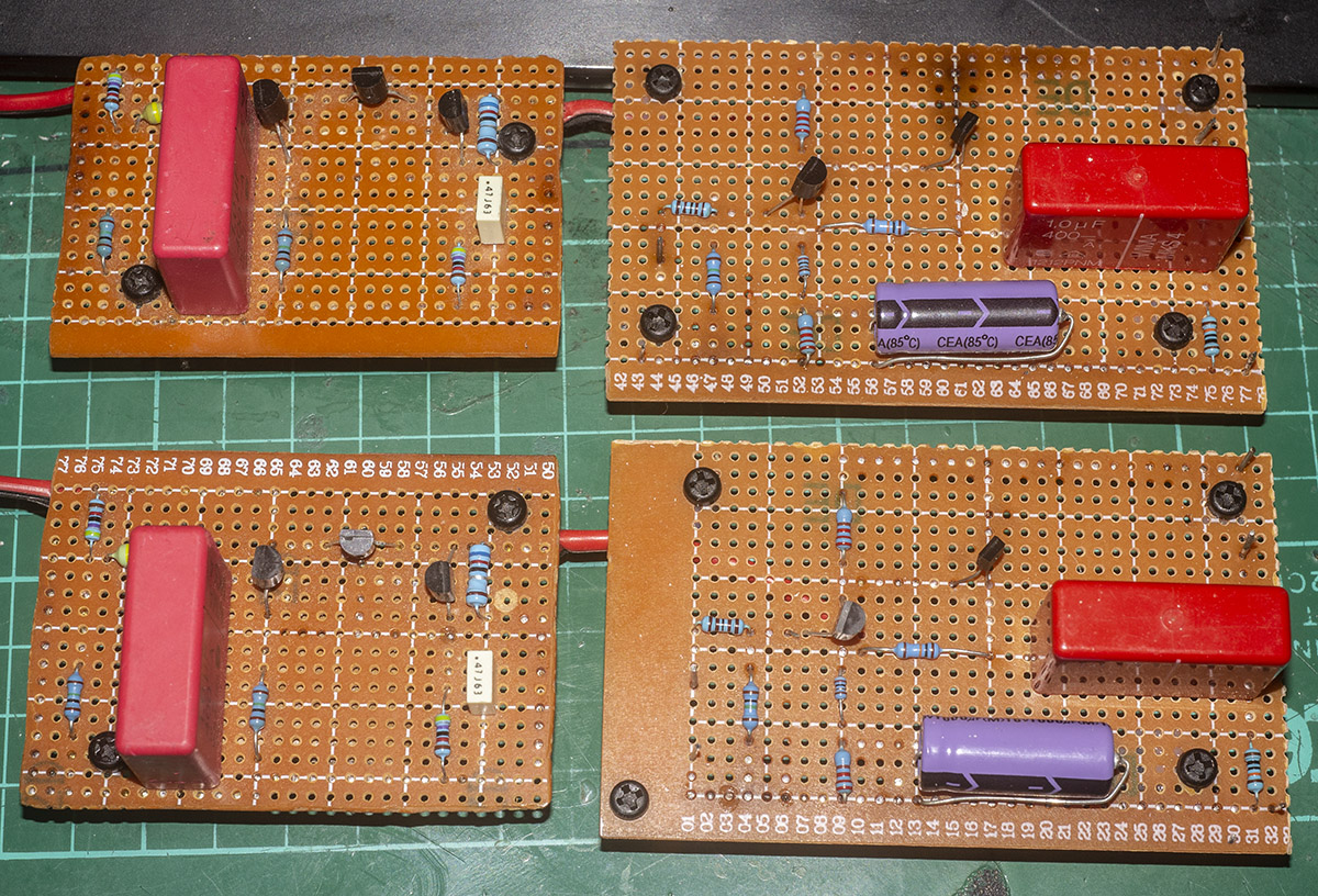

Here's the circuits I have built so far, the two pre amp modules on the right, the two on the left are ripple eaters I built a while back and never used, I used BC327 & BC337 trannies instead of the 2N5087 & 2N5089.

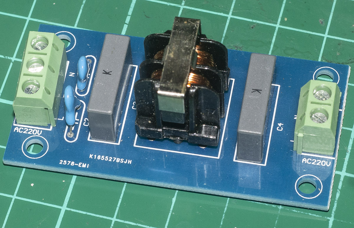

The other pic is the RC filter I have. I hadn't thought about a speaker protection circuit, wouldn't that be placed in the power amp?

The RC filter you show is a mains filter. RC exists of R and C or a low pass filter to prevent non audio signals coming in.

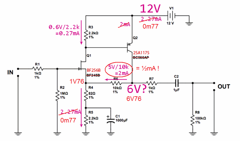

Rapid estimation IS a useful skill in DIY. It saves you from coming back from the lumberyard with two tons of wood for a small doghouse.
I am afraid your doghouse will be out of proportion, 5/10 = 2 😱
And the values don't go well with the BF256B data. Not enough -Vgs and up goes the current saturating Q2. With a BF256A it is more like it.But with the spread of the properties of fets, best make R3 adjustable.
And who needs the over 100x gain 😕
