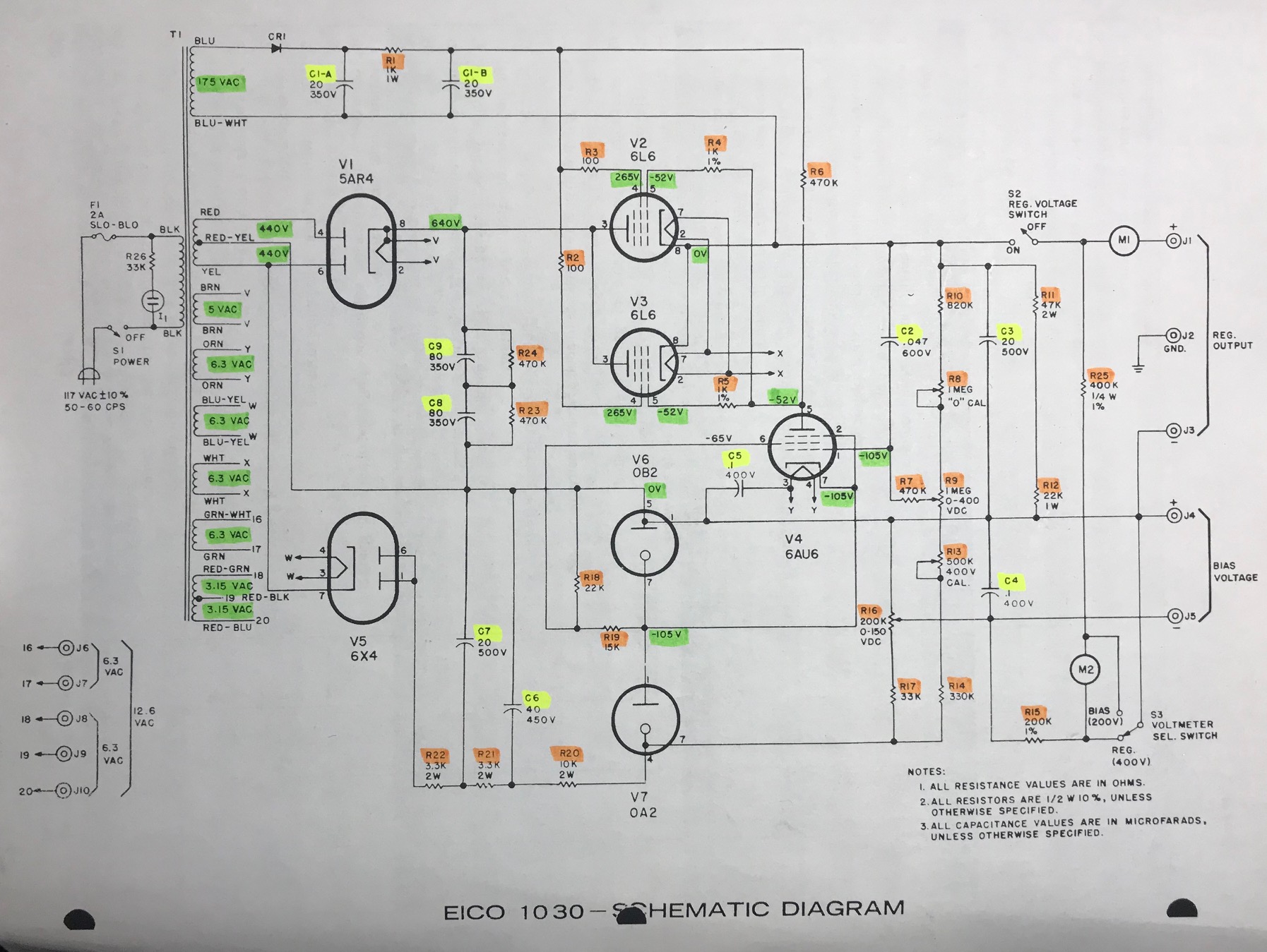

I recently acquired a Conway Electronic Enterprises Model PS-1 Regulated Power Supply. It is very very similar to the PACO B-12 but I think identical to the EICO 1030.
http://jlandrigan.com/files/EICO%201030%20schematic.pdf
Here are my observations.

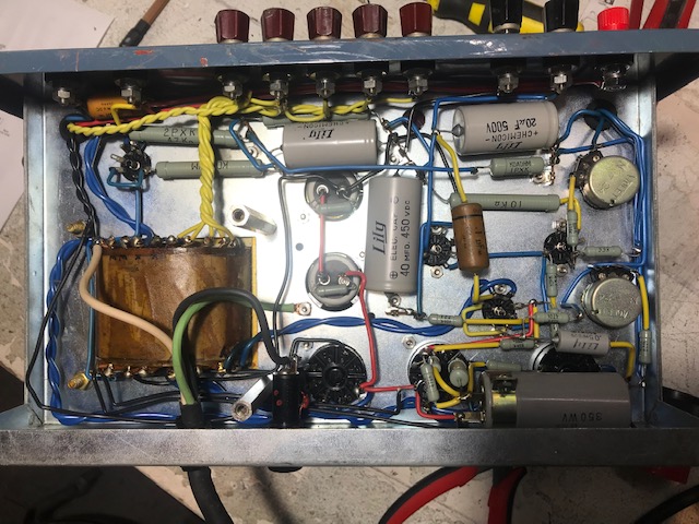

The Bias supply seems to not be providing voltage from either the pos or neg terminal, but seems to accurately provide positive only voltage when measured between the pos and neg terminals.
The Heater supply works fine, as do all the other heater lines that feed the tubes inside. In fact all voltages out of the transformer seem good.
The Regulated supply does not appear to do anything.
The build quality is excellent and all the components are original (ie over 50 years old) so I figure I'll be swapping out the electrolytic and wax caps, but my understanding of this circuit is incomplete and if anyone has an idea of where I should I should begin I would be very grateful.

The photo is poor, but there appears to be a white line (indicating a connection) between the bias positive output
and the negative regulated output. Measure between the negative regulated output and the bias positive.
Do not use ground for measurement, as it is not connected to anything unless you add an external jumper.

Check all the tubes. Then measure all the internal node voltages wrt the negative regulated terminal.
The floating supply (blue leads, around 270VDC) could easily cause failure of the regulator to operate
properly, if it is not working. Look for an open resistor or a bad connection.
Ok so the bias voltage is working fine when referenced to the reg neg. The 5AR4 seems to be only pulling 590V instead of 640V, and the screens of the 6L6's are seeing 209V instead of 265V, while the grids have -107V instead of -52V. I'm also reading around 2 meg of resistance across C3 the last 20uF 500V cap (out of circuit) before the reg voltage switch, which I think means it should come out.
Check the line voltage spec (117 VAC) and compare with yours, which could be different.
Try it on a Variac set to spec input AC line. Also capacitors just after a rectifier tend to go first
due to heating, and cause lower DC than when new. But, tube circuits can have 10% variation
without much harm. The CR1 could be bad/weak, as could C1A/B or R1.
What was your voltage reference for those measurements? On the schematic you will notice that 0V is labeled as the voltage on the cathodes of the 6L6 tubes. In other words after the rectifier and 6L6 plates, all voltages listed are relative to the 6L6 cathodes, because the grid and screen voltages are biased up by the voltage on the cathodes (which voltage is user adjustable).
For an accurate (relative to the schematic) reading of those voltages quoted you need to measure with pos meter probe on the point you want to measure and neg meter probe on the 6L6 cathodes.
Now, you may still determine the HV supply isn’t working correctly, but you must do the measurements with proper voltage reference first before coming to that conclusion.
