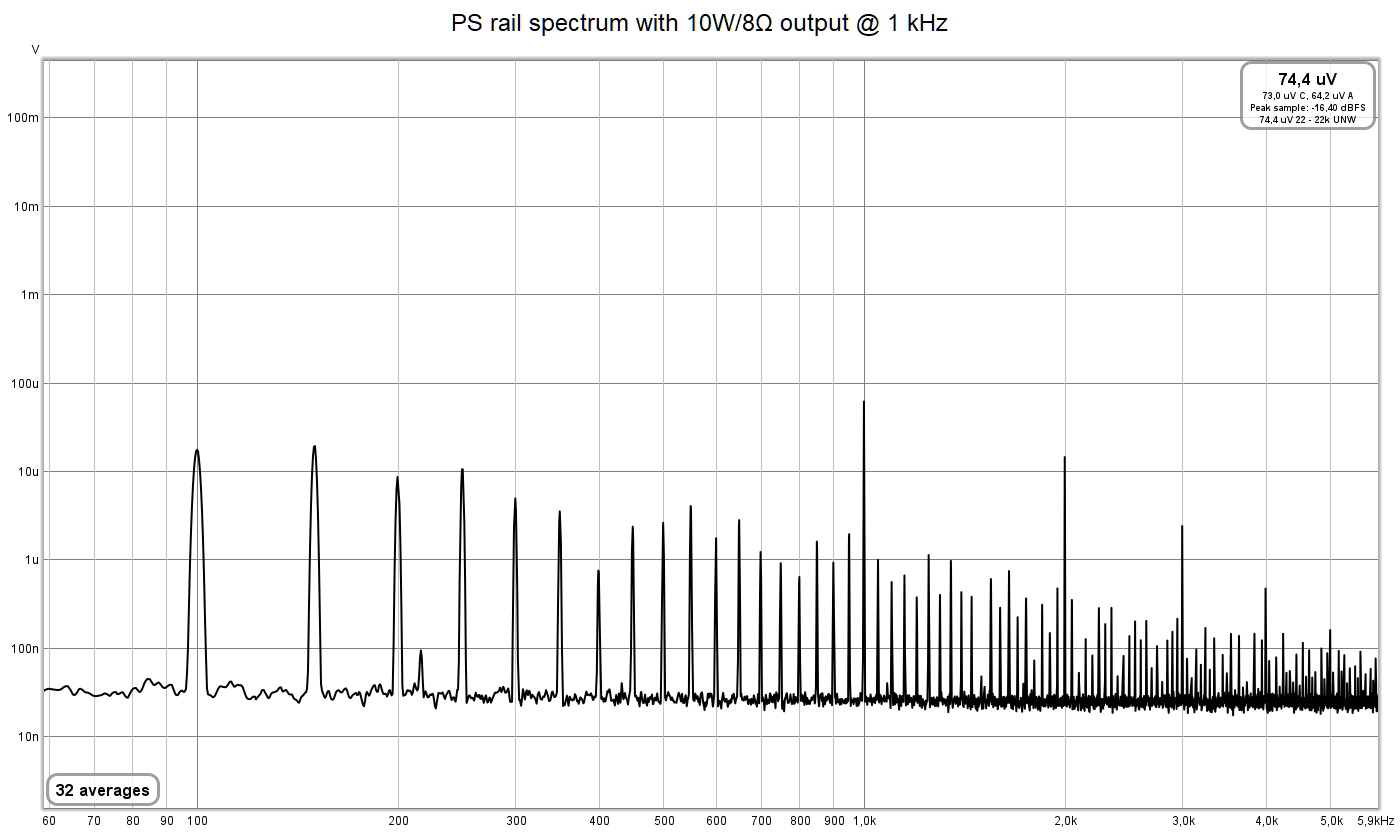

According to my measurements, this is absolutely unnecessary. In example, regulated PS rails modulation at 10 W/8Ω is about 70 uV.in the specific application hum and noise was never the issue .
