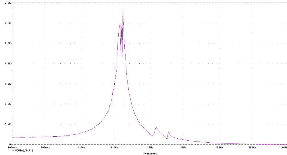

SY’s point about low impedance down to DC is so very important. A problem with variations on the “LC…LC” theme at low frequencies is this: The impedance of the power supply will not only increase, but worse, it will show the resonant effects of those Ls and Cs. Whenever Ls and Cs cohabitate, a resonant circuit is created. With multiple Ls and C’s, multiple resonances are created. The goal is to make sure that these resonances are at very low frequencies and are well damped by resistances. I have built some nice sounding circuits using LCR variations, so please know that I’m not dissing the genre. The nature of the circuits being powered by this kind of PS does make a big difference. Some circuit types are more susceptible to low frequency PS anomies; others are relatively immune.
Attached is my simulation of an LCLCLC supply that I came across once. This is a real world, fairly typical, case, although not an optimum design in my book. A lot of DIY’ers live with these effects, perhaps unwittingly. The Y-axis is magnitude of impedance (the phase of the impedance varies too, but that’s a whole other story). The exact values of the components are immaterial; this is only an example! What you want to see is a very low impedance at all frequencies. Obviously you don’t get that. For most of the audio range the final cap determines the PS impedance, and it goes pretty low at the upper end, as expected and hoped. But in the sub-bass range, the resonances show up as nasty impedance peaks. How much these would bother the supplied circuit depends on that circuit, as I said earlier. Furthermore, if the supplied audio circuit use plate chokes, transformers, or cathode bypass caps, these reactances can interact with the supply reactances in even more complicated ways.
If you were ever tempted to wrap feedback around an amp that was powered by such a supply, you might soon learn the definition of the word “motor boating”. Again, I’m not against this time-honored genre of supplies; I’m just urging caution, and the consideration of an alternative: regulation.
A well-implemented regulated supply can drop the PS impedance to below 10 ohms, perhaps even below 1 ohm, from DC to daylight. Some people eschew regulated power supplies because many of them use feedback. I think a lot of this is simply a stigma carried over from the experience of feedback in audio stage, and, yes I know the PS is part of the overall audio circuit. Many people prefer the simpler regulation attained via shunt elements like gas regulators and even zeners. So there are many options to consider besides LCLCRCLC...
