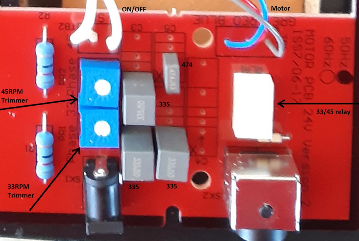

Made a good deal on a NEO-TT-PSU so I recently installed a 24V motor to take advantage of it. Will post some pictures later. They should suffice for reverse engineering the REGA motor PCB.
The board has two inputs, the standard AC input for the 50/60 Hz transformer that came with the deck. The other is similar to the old S-video/4-pin mini-DIN for the TT-PSU connections. NEVER CONNECT BOTH, the manual explicitly warn against this.
There is a relay, 2 resistors, 2 trim-pots and four capasitors on the PCB. One trimmer for 33RPM playing and the other for 45 RPM.
I may be wrong, but it was always assumed that the TT-PSU outputs sine waves of different frequencies depending if you are playing 33 or 45 records The NEO-TT-PSU allows fine tuning of motor speed with a resolution of 0.01RPM and changing between 45rpm and 33rpm by flick of a switch.
For turntables fitted with a 50Hz motor pulley; 50Hz for 33 RPM and 67.5 for 45 RPM. My assumption was always that two pins on the DIN connector is used when playing 33RPM records and the other two when playing 45. I further assumed that voltage on the "45-rpm" pins would activate the relay, selecting the "45rpm" trimmer.

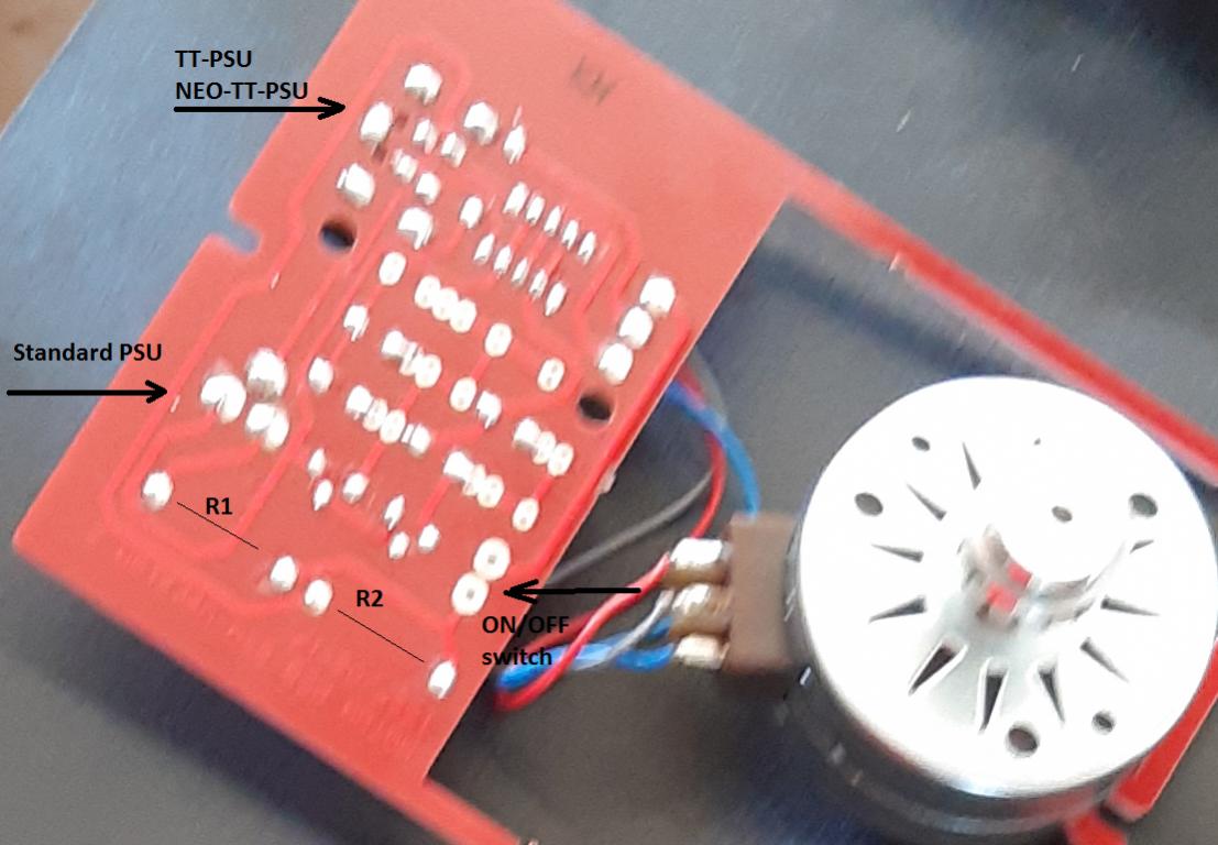

Indeed, looking at the pictures on my old camera it seems my assumptions were wrong. On the (Neo-)TT-PSU there is a single AC output on two pins of the mini-DIN connector, with frequency determined by selected RPM. The other two pins drive the relay that select either 45 or 33 RPM phase network on 24-volt motor PCB.

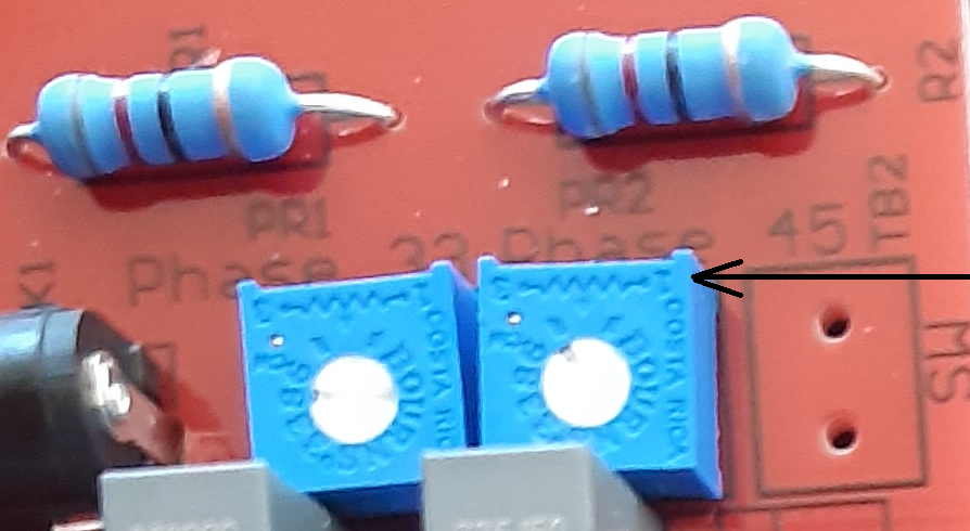

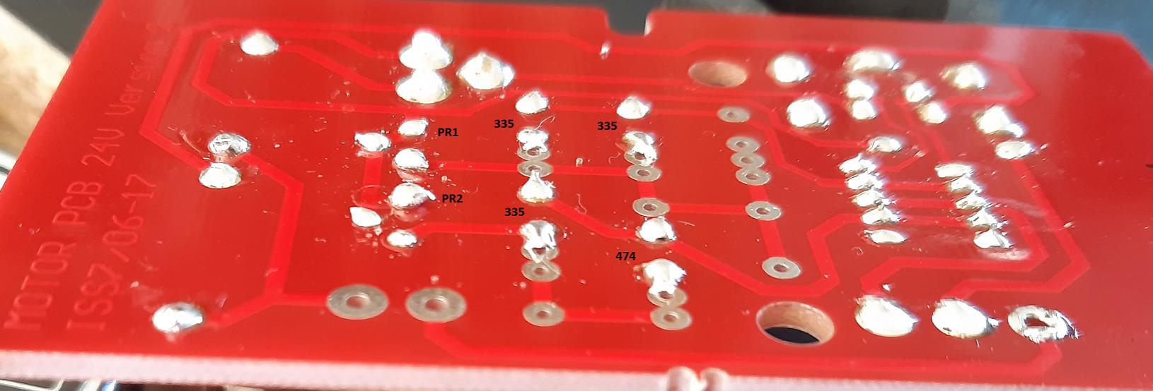

If my reverse engineering is correct, the networks generating the "missing" phase is a Bourns trimmer in series with a capacitor (actually 2 capacitors in parallel).
I have not been able to identify the values of the Bourns trimmers, see attached images for capacitor values.

Most definitely trimmers are resistors, see attached picture.
Unfortunately no picture showing values of PR1 or PR2.
On that picture I also notice that the 45rpm pot on my PCB is maxed towards one end-stop. Almost as if the board was not trimmed for this speed.
R1 and R2 seem like 82 ohm.

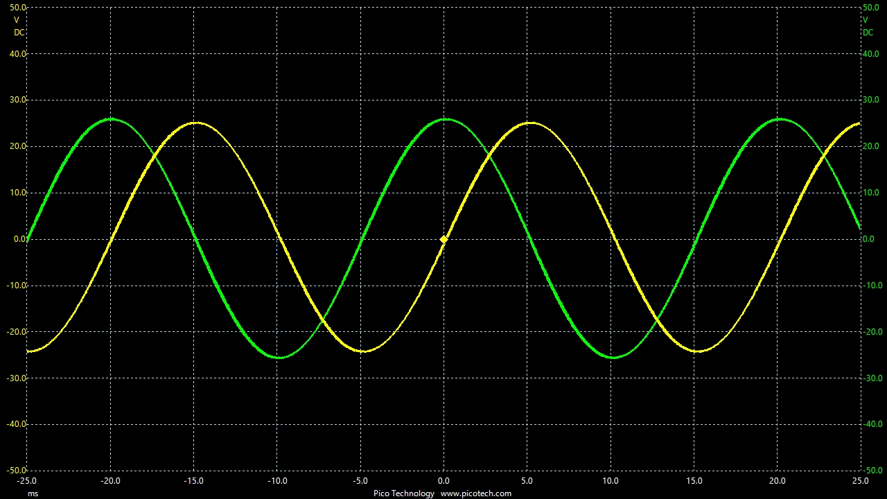

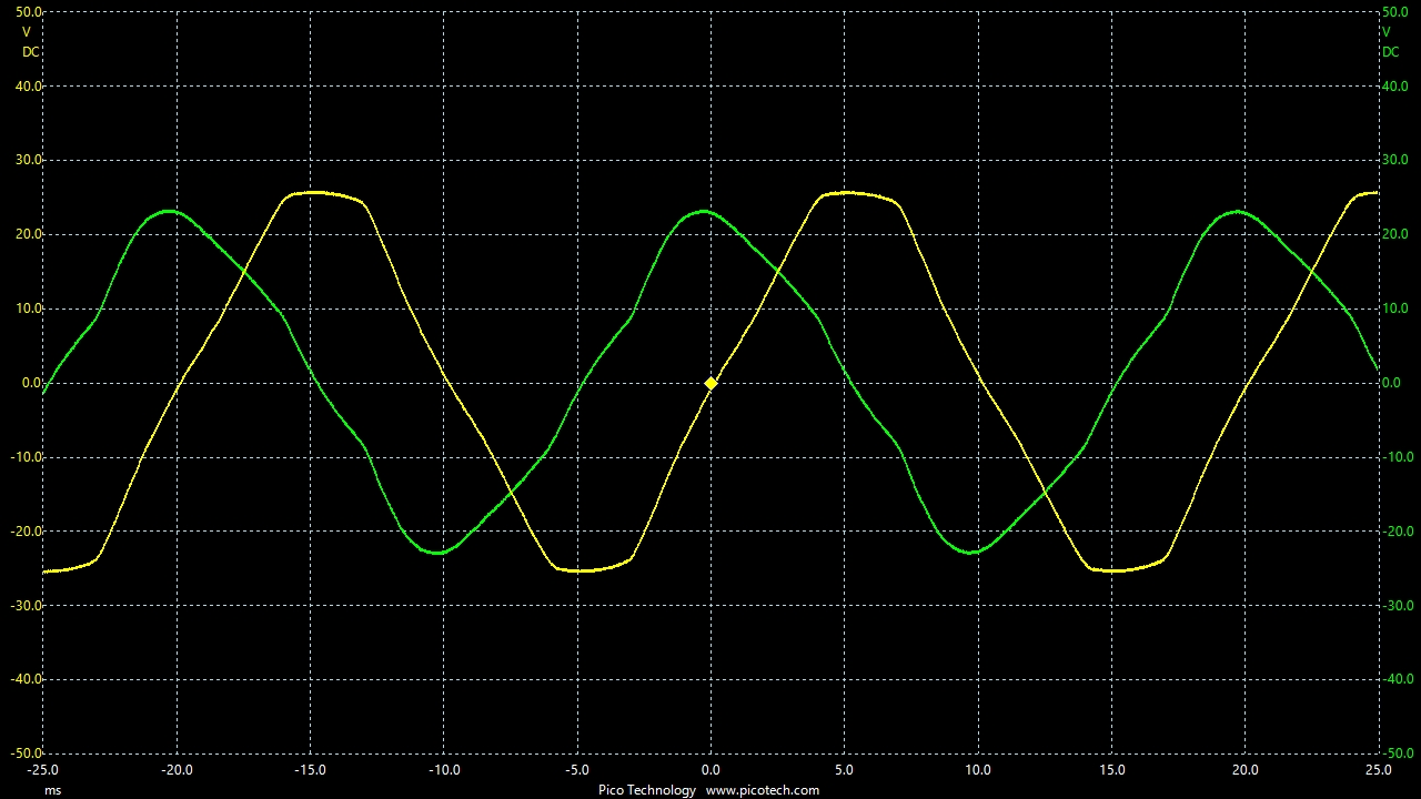

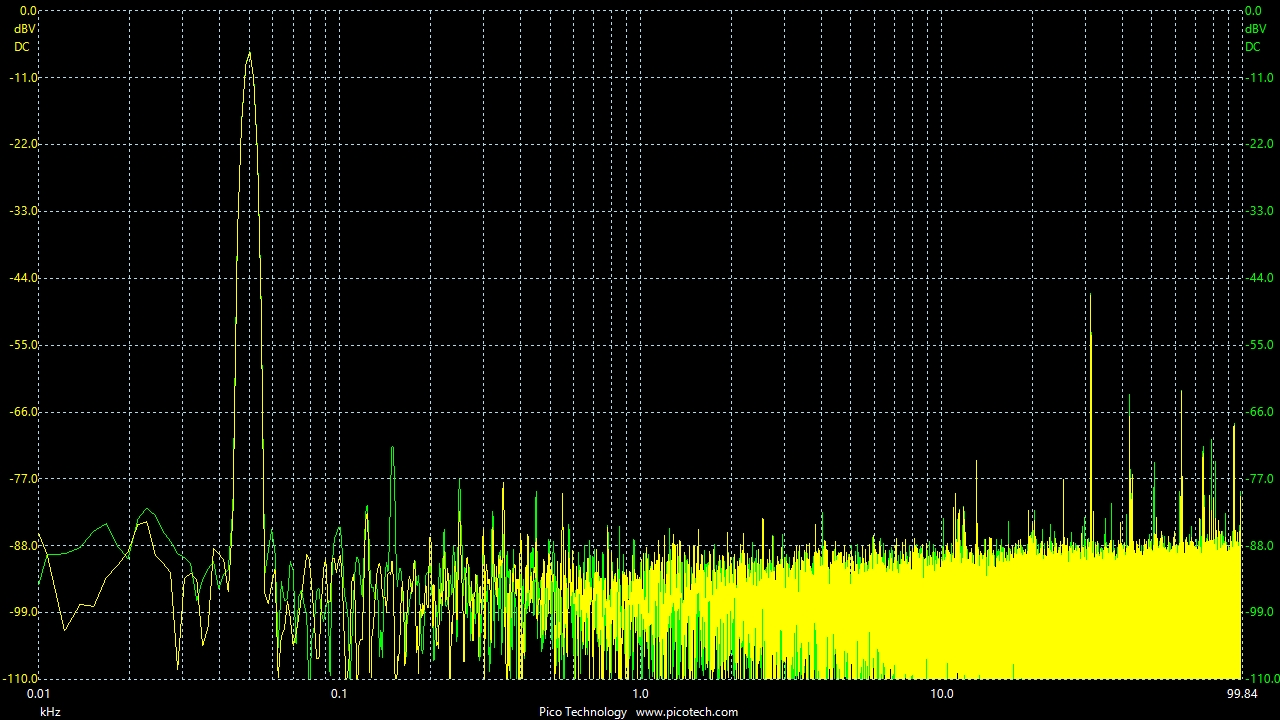

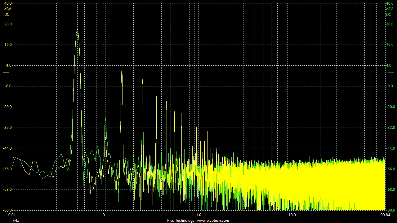

For reference, I looked at the two motor phases when using the standard set-up. The first picture is the voltage waveforms, where yellow = direct input, green = through phasing network. Pretty shonky for 'sinewaves' I thought! Spectrally, they can be seen in the second picture, lots of 3rd harmonic as expected.

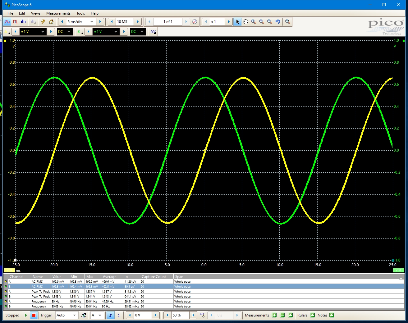

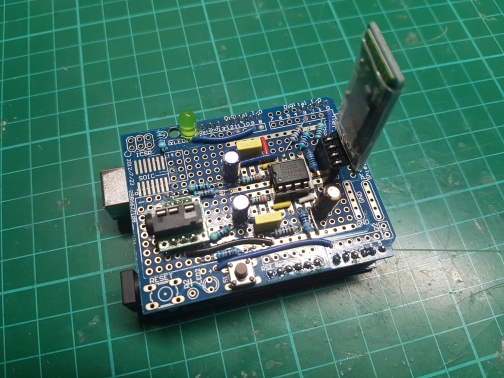

For the sinewaves, I thought I'd see what I could get using an Arduino Uno and filtered PWM, driving through a stereo amp with voltage rails sufficient to get to around the 25v peak (50v p-p) of the standard set-up.
Using the default 510-cycle phase-correct PWM at 16MHz to give a frame rate of ~32us/31kHz, a 1024-point sinewave lookup table, and first-order low-pass filters with a cut-off at ~500Hz and gain of x0.275 to reduce the amplitude from 5v p-p to 1.375v p-p for the audio amp, gave the outputs shown in the third picture, with spectrum shown in the fourth. Pretty respectable looking sinewaves, with the dominant PWM-related tone at ~31kHz as expected. The output of the audio amp is pretty similar as shown in the fifth picture, but with additional attenuation of the 31kHz tone by setting the treble tone control to minimum (this has a cutoff at ~1kHz).

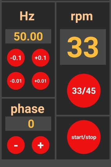

The sixth picture shows the prototype squeezed onto a shield. I'm using a bluetooth interface using the excellent RemoteXY control app to give a tuning interface for the 2 speeds, as shown in the seventh picture.
I'm pretty happy with the overall result, it drives the turntable motor well, with little noticable vibration using the 'finger-and-thumb' test.
