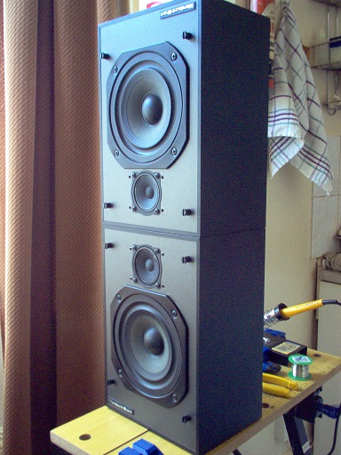

Last year I bought a pair of Rega tweeters for $10 on CL. I recognized them as Vifa and thought that even if they were blown, which they were, I could get new voice coils from Madisound as I had before for my other Vifas. Well. it turned out that Fred Flintstone had owned these and new VCs are not available. But I kept them and tried a few things to see if I could get them to work. Then I stumbled on an ad on eBay for two 19mm voice coils with silk domes from China for $10. I said what the heck, if they don't work I can't say I didn't try. It took two weeks for them to get here and after some VERY careful positioning, glueing and soldering I have a nice working pair of tweeters for a total cost of $20. I built some cabinets out of scrap 1" MDF, bought some Infinity 2-way L-pad crossovers, and mounted them with a pair of PSB 5t woofers I had laying around. Everything sounds great except that even with the tweeter knob turned all the way up they not very bright. My question is if the resonant chamber on these Regas lower the resonance frequency, if I remove the chamber will that brighten up the tweeters? They are crossed over at 3000 Hz. Thanks!

You can wire 4 speakers as a set of 2 series wired speakers (16 ohms), connected in parallel with another similar set. That's actually 8 ohms overall. But some strange things might happen if they are not all the same. A picture below of a configuration that can be wired series or parallel and sounds good. That's all one speaker, in effect.
