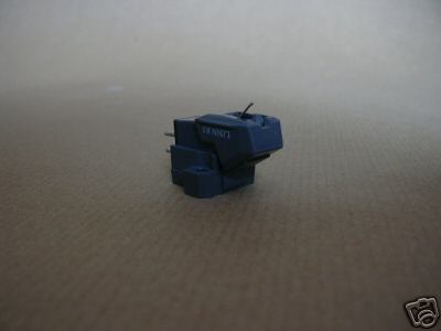

The only thing I don't know for sure about is the Linn cartridge, it's many years ago I bought this TT and a weak memmory tells me it's an K7 or K9...?
The "housing" of the cartridge is partially of yellow/orange plastic.
Does anybody know anything about Linn cartridges and how I can identify my cartridge?

To my knowledge there was never a K7, so its probably a K9.

dnsey said:Isn't the K9 a rebadged AT95E, or is my memory playing it's usual tricks?
The "yellow" model in the Linn Basic, which is a very apt description.
A basic Audio Technica cartridge.
Somewhat worse than the excellent Audio Technica AT95E,
£23 from Mantra Audio in the UK.
There were two better models, the K5 and K9, pretty similar
except the K9 has a better stylus, both have metal bodies
as opposed to the usual plastic, made by Audio Technica.
Somewhat better than an AT95E, one would hope.
An Audio Technica AT120E/T is an excellent budget alternative
to the the K5 and K9, the nude stylus is K9 quality level.
(Buy a spare stylus with the cartridge - its very cheap)
http://www.garage-a-records.com/atcart.html
Apparently the AT95E stylus fits the K body,
but with a gap at the front I think.
The Grado Prestiges are are a good choice if you like
a richer sound with restrained treble, worth importing
from the states, the Black is a $35 bargain.

Sreten,
your post made me unsure if I really have a Linn cartridge, as I wrote my cartridge is partilly of Yellow plastic, actually it's the front end, as in your attached picture.
I guess that's the stylus which is sitting in the yellow plastic part whatever it's called, the cartridge body is metal.
So do I have still a K9 or could it be something else, as it's probably 15 years ago I bought it I don't remember very well but the seller talked about Linn.
My cartridge looks like the one on the picture you attached except the blue collored part is on my cartridge yellow, there is no text but on the front end is a "K" laying down inside a circle.
/Michael
http://www.superfi.co.uk/index.cfm/page/moreinfo.cfm/Product_ID/189
AFAIK the yellow Linn is this spherical tipped Audio Technica.
It its not, that is stylus mounting does not have the
"hook", then checkout to see if the AT95E stylus fits.
If it does have the "hook" the AT110E stylus should fit.
Both of these will be an upgrade (for a 15 ! year old stylus).
Try mantra audio UK for the styli.
🙂 sreten.

Hi Sreten,
thanks for all those colorfull pictures! 😉
I actually took my stylus of to look closer and it reminds fully the green one you attached, but precisely below at the point where the diamond on the needle is attached, is an opening like the yellow one has.
It also has a slight "bump" on the right side as the green one.
I did check my junk box with couple of diffrent cartridges and I found two Pickering XV-15 but without the stylus.
Surfed the net and it seem to be possible to buy a replacement stylus which seem to be in the range of 40-100 British Pound, http://www.pickeringuk.com/stylii.html
Checked also a couple of other pages and it seem that the Pickering XV-15 is a DJ cartridge so I wonder how much Hi-Fi value it is in that cartridge....

Well forget about the Pickering IMO.
Checkout mantra audio and their exchange offers.
for ~ £80,
Denon DL110, Goldring 1012GX (exchange)
are both excellent choices for a P3.
For outstanding value import a AT120E/T or AT440ML from the States.
Buy a spare stylus at the same time.
The Goldring tip and even more so the AT440ML tip will
last much longer than the elliptical DL110 and AT120E/T.
🙂 sreten.
