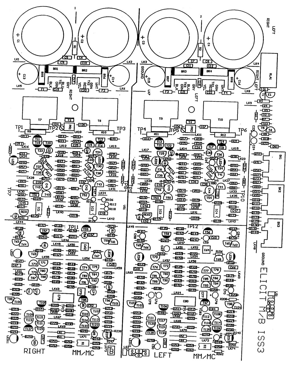

Diagnosis: The amp was dead, no power. So I opened it, and found blown fuses, and quite some damage.
I took a photo of the incriminated section, which is on the power side of the left channel. Ouch!

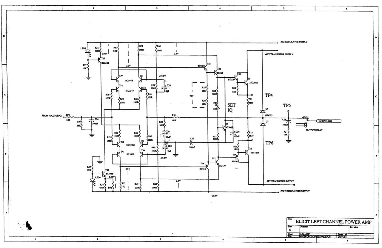

Following the schematics I made some basic tests with a multimeter and a transistor tester. I've found and replaced a list of parts that were damaged, which include the finals (2SC2922 and 2SA1216), the BD139 and 140 which were totally blown (T14, T17, T18, T13, T21, T22) as the 100uF capacitor C30, the big resistors R11 and R12 (blown!) as well as R18, R36, and R49, and some zener diodes. T48 on the -39.5V was also tested bad, but with no visible damage.
I remade some tracks that were vapourized (ouch), I tested the other small transistors too (only in the amplification section of the board), and they were all good.

Sure enough, after less than 2 minutes, there was the POP disconnection sound, much louder at the left speaker (the one that I repaired), and the sound went mute. Power cycling the system "resetted" the protection (the DC one?? I've read that the thermal protection turns the "Elicit" front LED red, but I'm not sure about more localized protections, if that was a protection at all) but the issue persisted, so I opened it again and found R36 and R49 burned again, on the left channel. Was that for the impedance of the left speaker, the one that was blown and repaired, not being high enough? Was it the crossover's fault, or the amp still has some issues?
And that's where I'm now. I also found a cold solder at LED3. That is to see the +39.5V, and it's the only led that turns on slow and turns off fast. Maybe that was only that solder joint that triggered T25, which caused the pop?
There are some big capacitor which hold a lot of charge, and don't think they'll discharge after days, like I did: you need to discharge them, I learned the hard way 🙂 but when holding charge, the finals show short?? I don't know.
