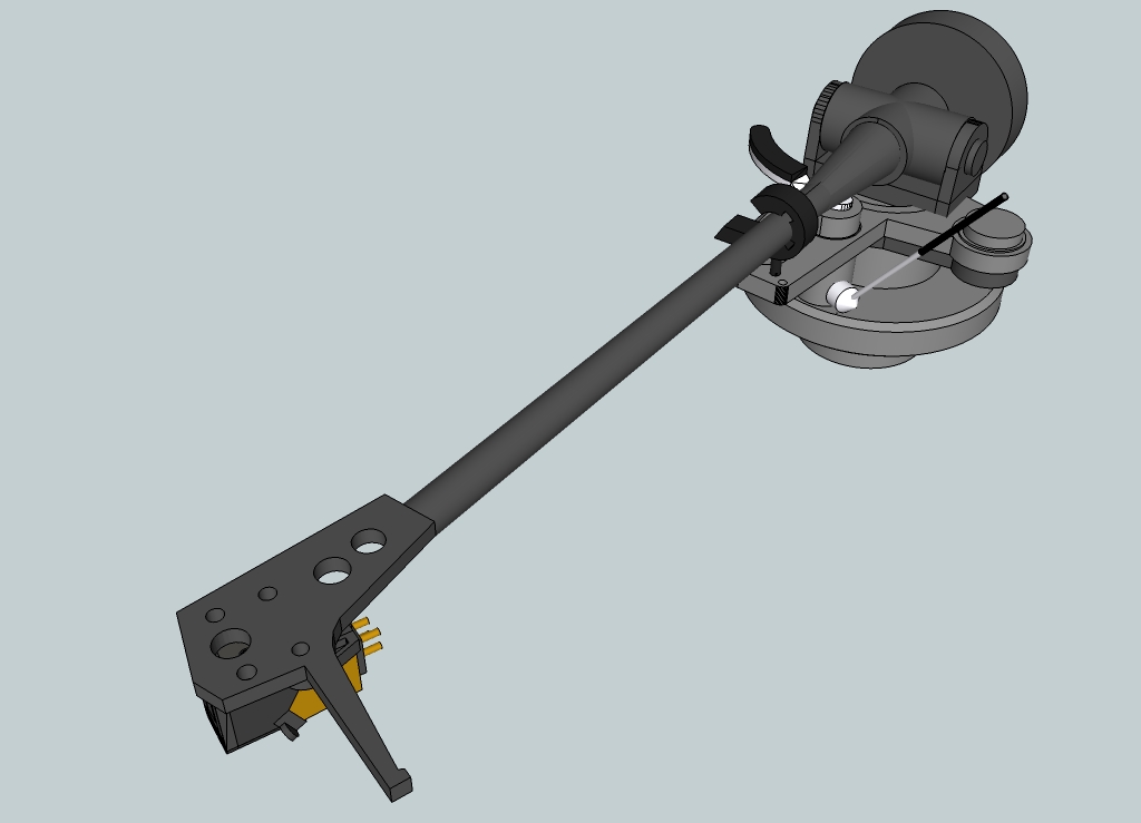

I'm in the process of designing a turntable that will use a Rega tone arm (RB250). Does anyone have a CAD drawing they could send me of such an arm - Auto Cad 2000 or .dxf format preferably.
Also I know the distance from the spindle to the centre of the arm 's mount is 222mm but what is the ideal angular position? Visual it appears to be 45 degrees clockwise from the top (ie rear) but is this correct?

Karl it makes no difference where the arm sits, 222mm is 222mm regardless, you just locate it according to how wide/square/rectangular you want to make the plinth.
you'll find a full set of measurements on vinyl engine, or at least the arm length, the counterweight stub is about 30mm long and exits from a boss roughly 12mm from the bearing centre.

ArcProtractor for Rega RB-250, "WARNING" First of all, you must be absolutely sure to have the same mounting distance on your turntable than on the ArcProtractor.
MAXIMUM error on this dimension must be within +/-0.5mm. Otherwise, it is useless trying to align.

oops, back to an RB300 drawing...I managed to hack this together today.

Attached ArcProtractor Rega Family RB-250 to RB-1000.
Enjoy.
Merlin El Mago
Dave, I have a specific ArcProtractor for Rega RB-300 in png format, but is too big so can't be attached, if you send me a pm with your e-mail I will send.
