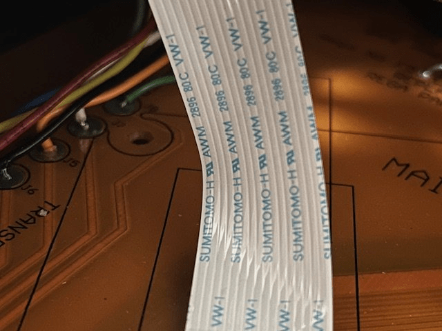

I just received a Rega Apollo (wide, early version) that I knew had problems. I played it tonight and it suddenly stopped as I was told it would. I started it up again and the problem did not reoccur (and has not in daily use for two weeks) and it sounded fantastic. I assume I will replace the transport ( SF-P101N) which is readily available for very low cost. The ribbon cable (which apparently also can be the source of problems) is not so easy. I am not very familiar with these and could use some help finding or specifying. I was hesitant to remove the existing cable but I opened the mechanism enough to read "SUMITOMO-H AWM 2896 80C VW-1" Since I did not remove it I do not know the length (8"? 200mm, guessing with 16 contacts)

How is it terminated - it appears to just be a brand of flat-flex. Measure the pitch and then you'll be able to search for equivalents.
Thanks, i was hoping to find someone that had ordered one since it seems to be such a common point of failure. That way I would be prepared when the inevitable happens. I will research the codes on the ribbon further.
Before replacing the ribbon cable, closely inspect the cable contacts for any sign of wear and clean.
