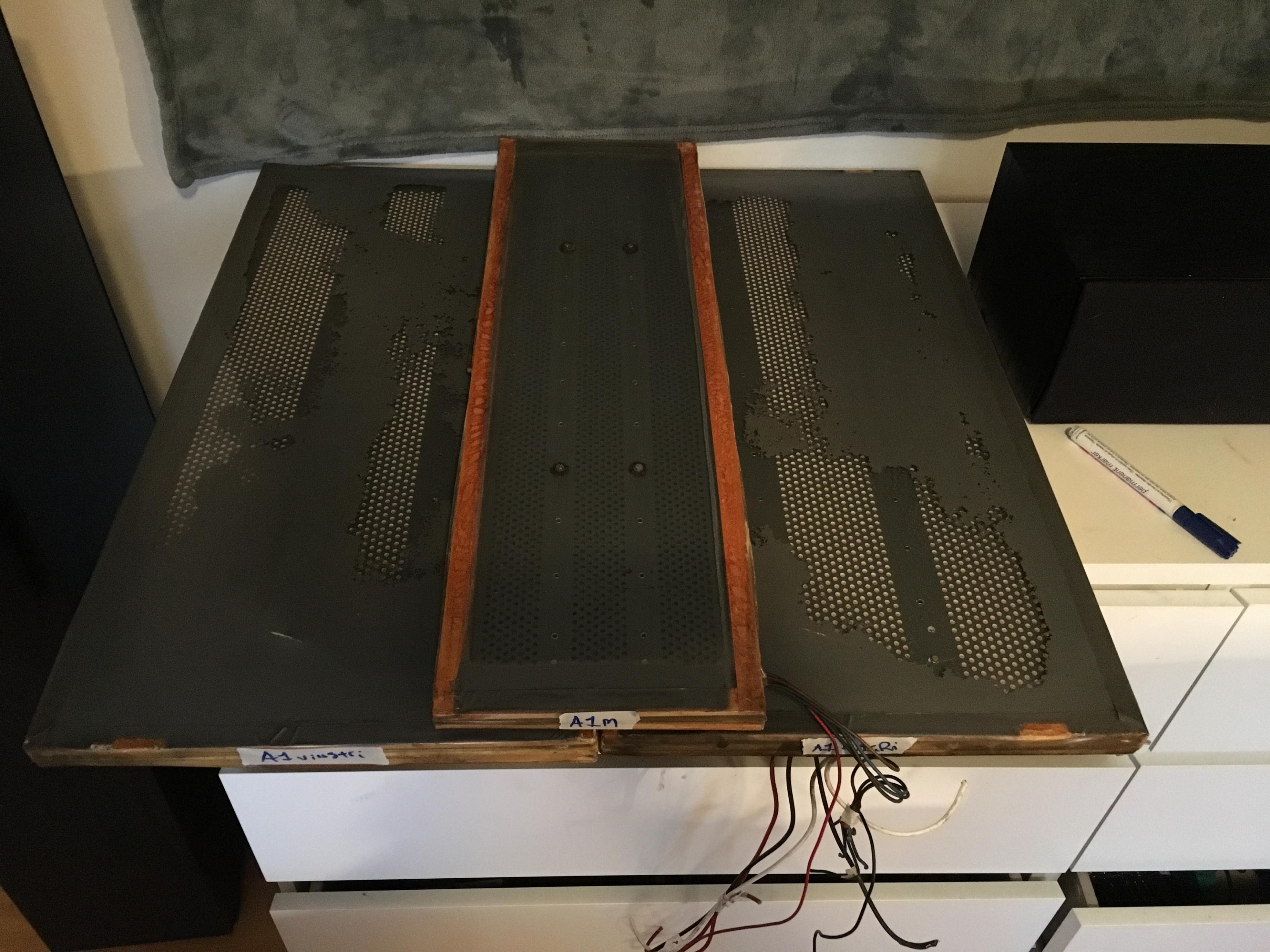

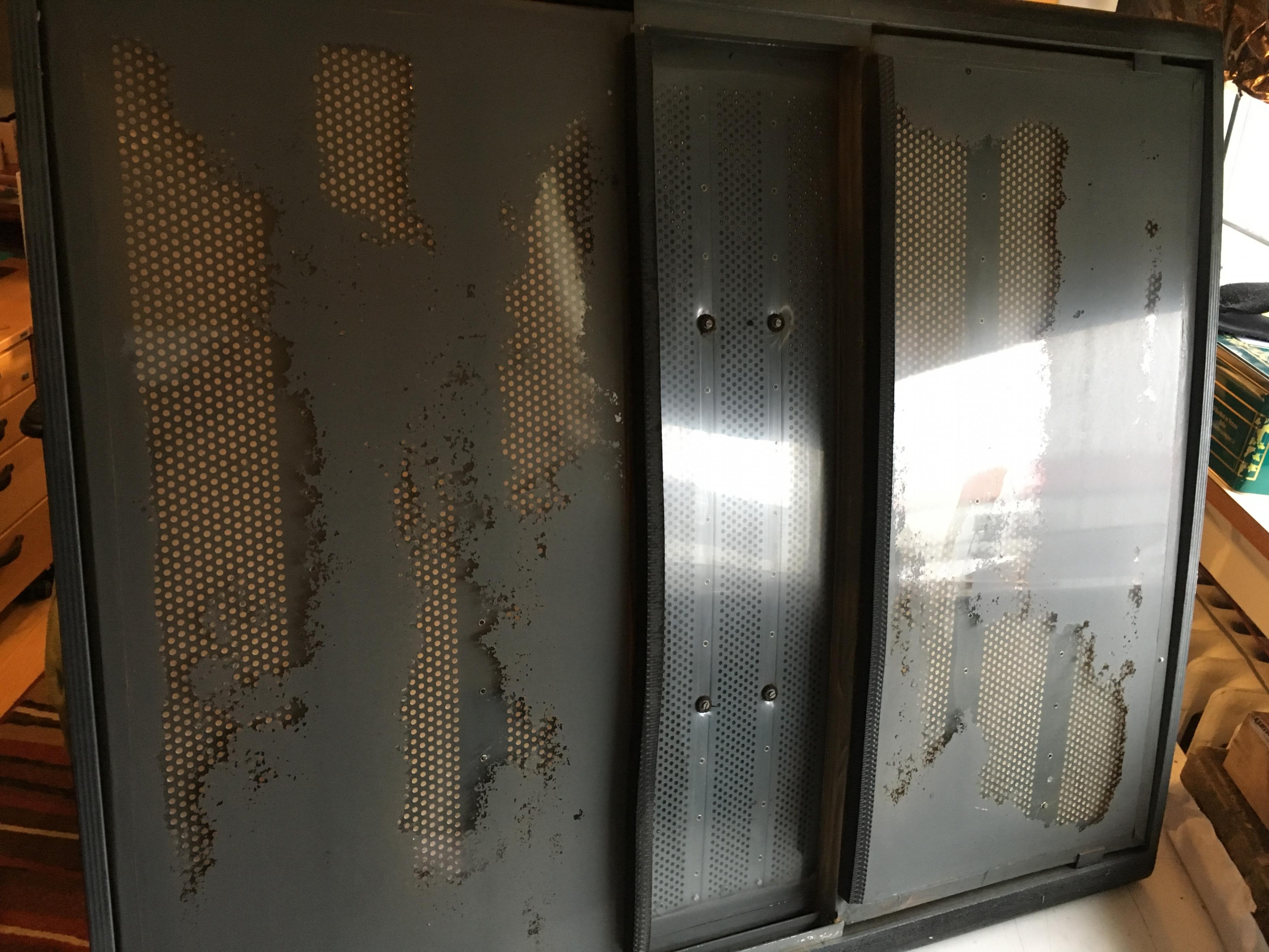

i all, i recently acquired four Quad ESL 57 that i want to refurbish. Number one pair is´74 and second pair '75 according to the serials that i want to refurbish. Number one is being disassembled and cleaned. I have a question about the resistors that i will replace, found some on digikey but not totally sure which ones to by? I would appreciate links so i can get the wright parts.

Thanks i will buy these, the first one has no damage on the membranes so i will just clean them and and replace the resistors for now. I did not plug it in and test it before i dismantled it.

Melted the beeswax from nr one EHT unit whith a hot air gun for eletronic bord work nice results.
