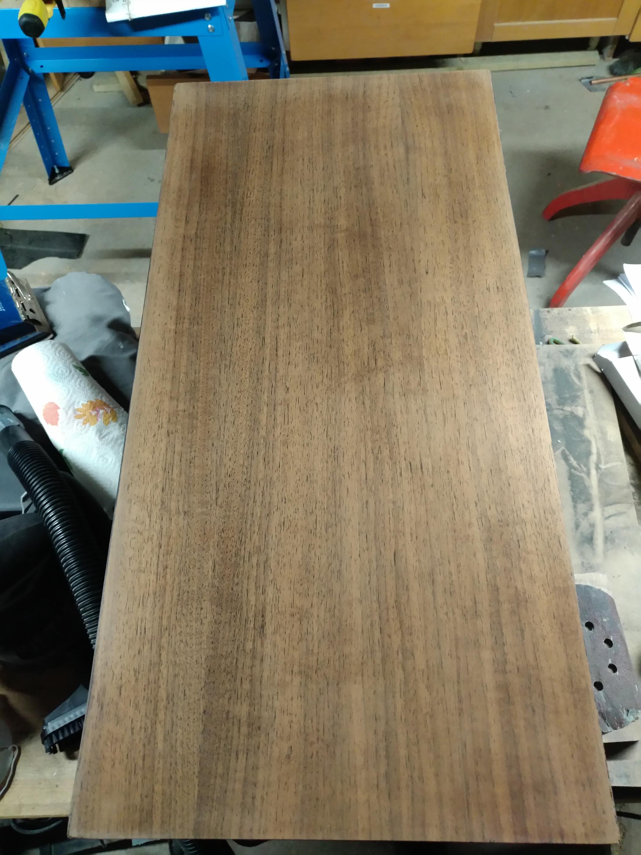

They got overpainted too. I will again try to sand down to the walnut veener (i think its still visible through the Paint. If i have success - fine. If not, i will reveneer them. Maybe with swampoak and a high gloss finish.
But first they get new surrounds and a listening sessions!
Surrounds arrived today and i tried to get rid of the black paint and it seems it works fine. Hell lot of work but i think the 4412 will look perfect in a while.

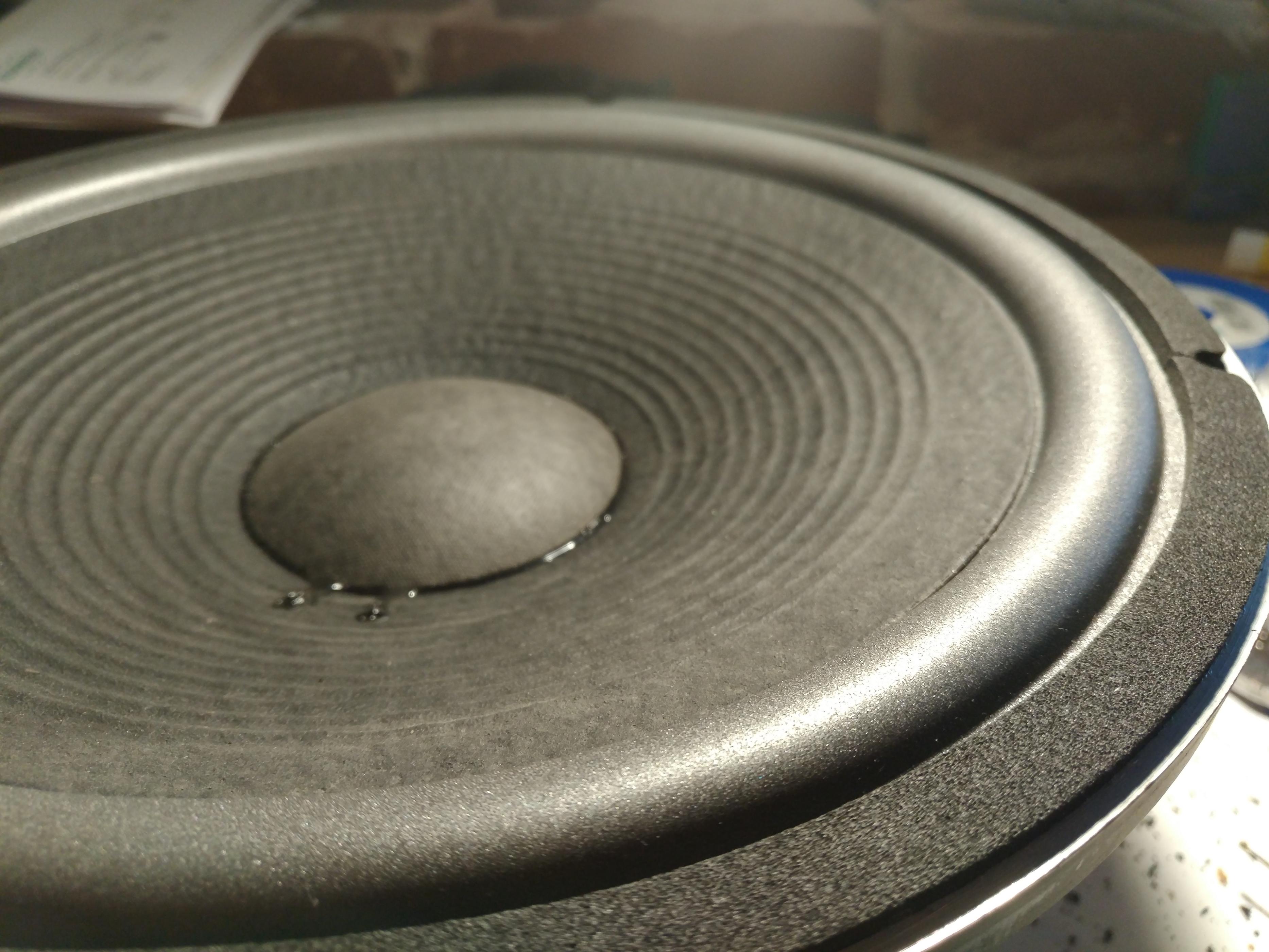

Hi guys! I refoamed the 128H-1 and both are working fine again. Had a little bit of trouble with the glue syringe.. the needle popped of and the glue.. everywhere.. but at least not on the cone (as you can see).

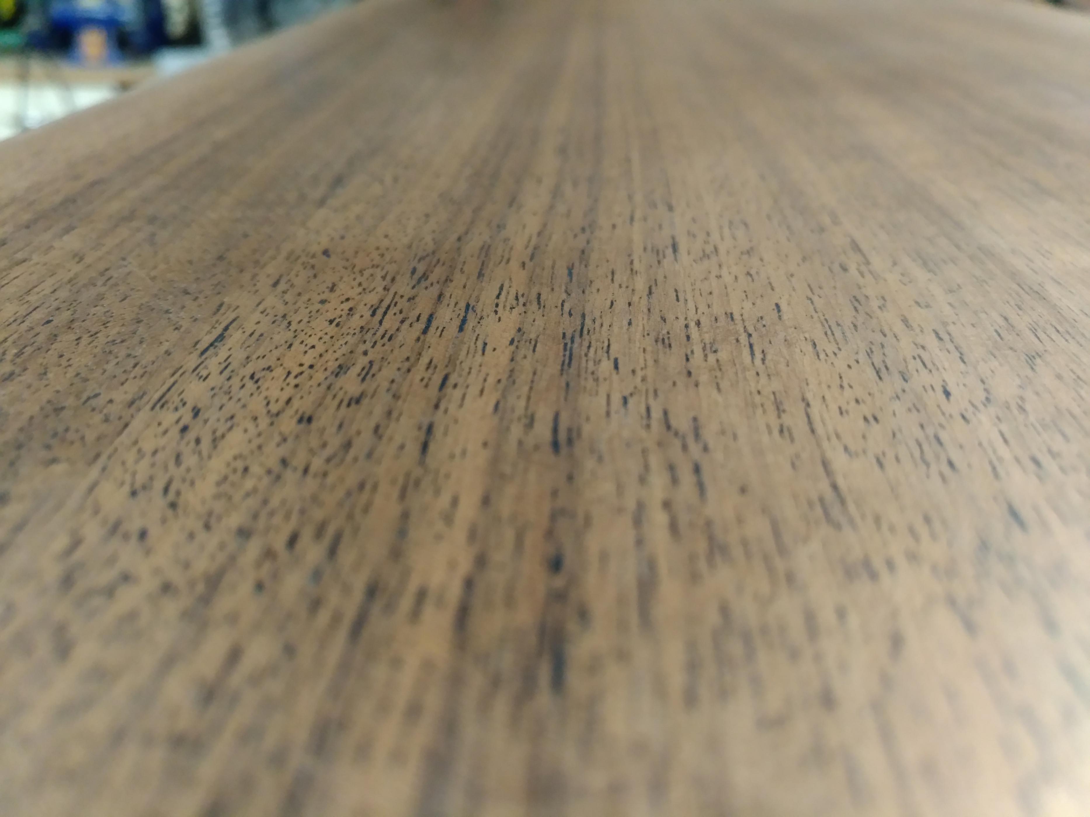

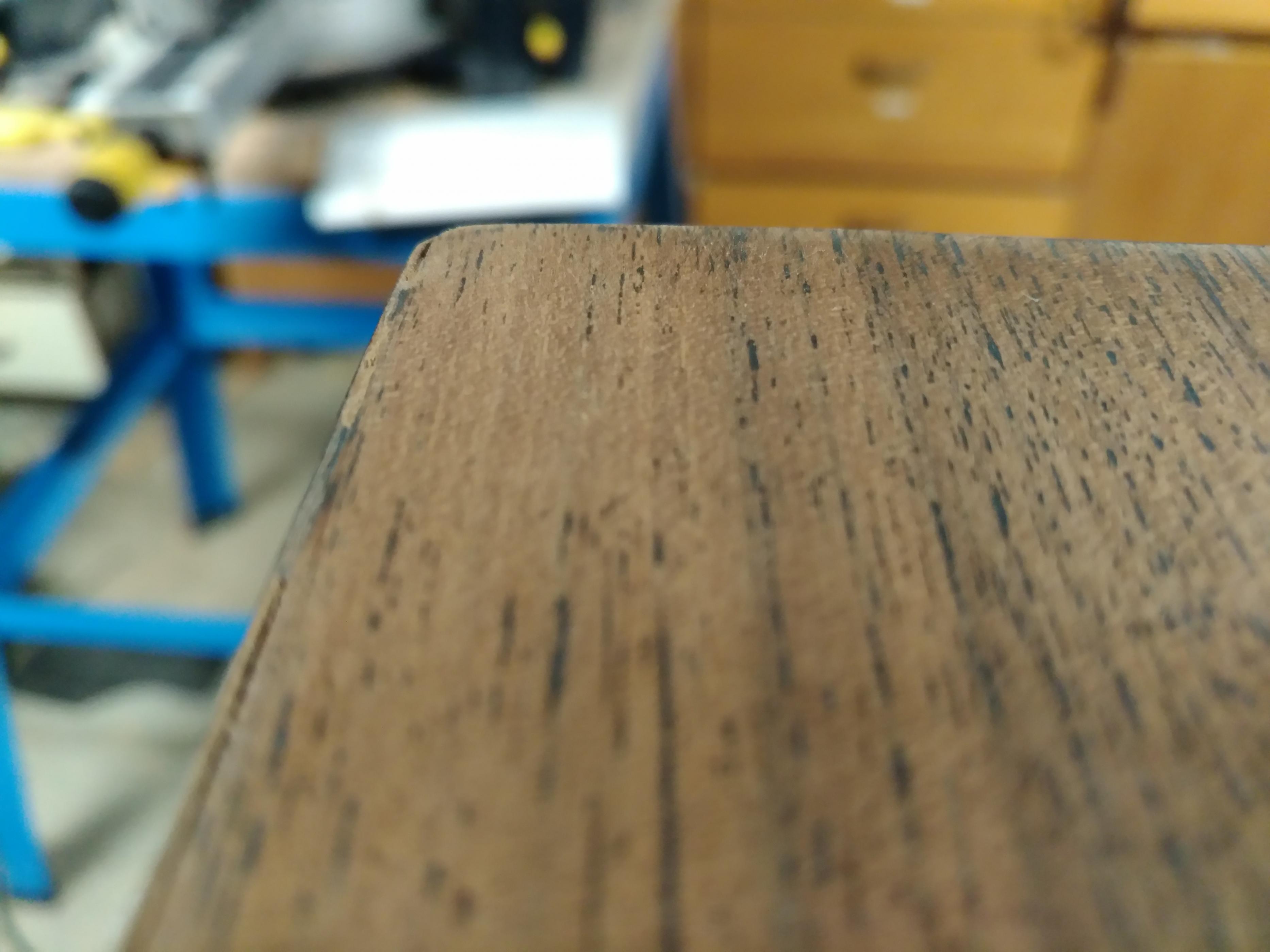

I kept on sanding down the first 4412 and this is how it looks like:
As you can see the overall veneer is still very stained and not really smooth. The pores are filled with black paint and i`m not sure how to move on now. If i keep on sanding it will look like the corner (without black paint pores) but i`m afraid to sand through the veneer destroying it..
Don`t know if i can live with this stained appearance if i could maybe had the chance to remove it.. 😀
What do you think?
"leave it stained and with black pores!"
or
"sand it down until you get a clean and smooth paint free walnut venneer!" - with the risk of destroying it...

Try using a green 3M scrubby pad with paint thinner and a light touch to see if it will remove the paint spots in the pores, rubbing with the wood grain. Try a test section on the bottom of the cabinet first to see if the thinner will discolour the veneer or make it lift (by thinning the veneer glue).
I would NOT use steel wool for this as the fine steel wool particles may become airbourne and go through the port into the voicecoil.
I can't help but wondering how much better the JBL 4310s would sound if tri-amped......??? Anybody ever try it?
I would be tempted to try some of the toxic paint stripper and see how it works to remove the paint residue. Maybe on the underside of the cabinet?
I suggest the "green" stripper rather than the old methylene chloride stuff, which dries too fast. Also the auto paint store has gray abrasive pads which are less aggressive than the green or red. Third, just stop and call it good when it isn't working and find a stain which will mask the leftovers. Sometimes the gel version works when some concealing needs to happen. Too bad Watco doesn't work for everything.
Not a fan of Minwax products. Varathane used to be better but both are on the same display at Lowe's these days so who knows?

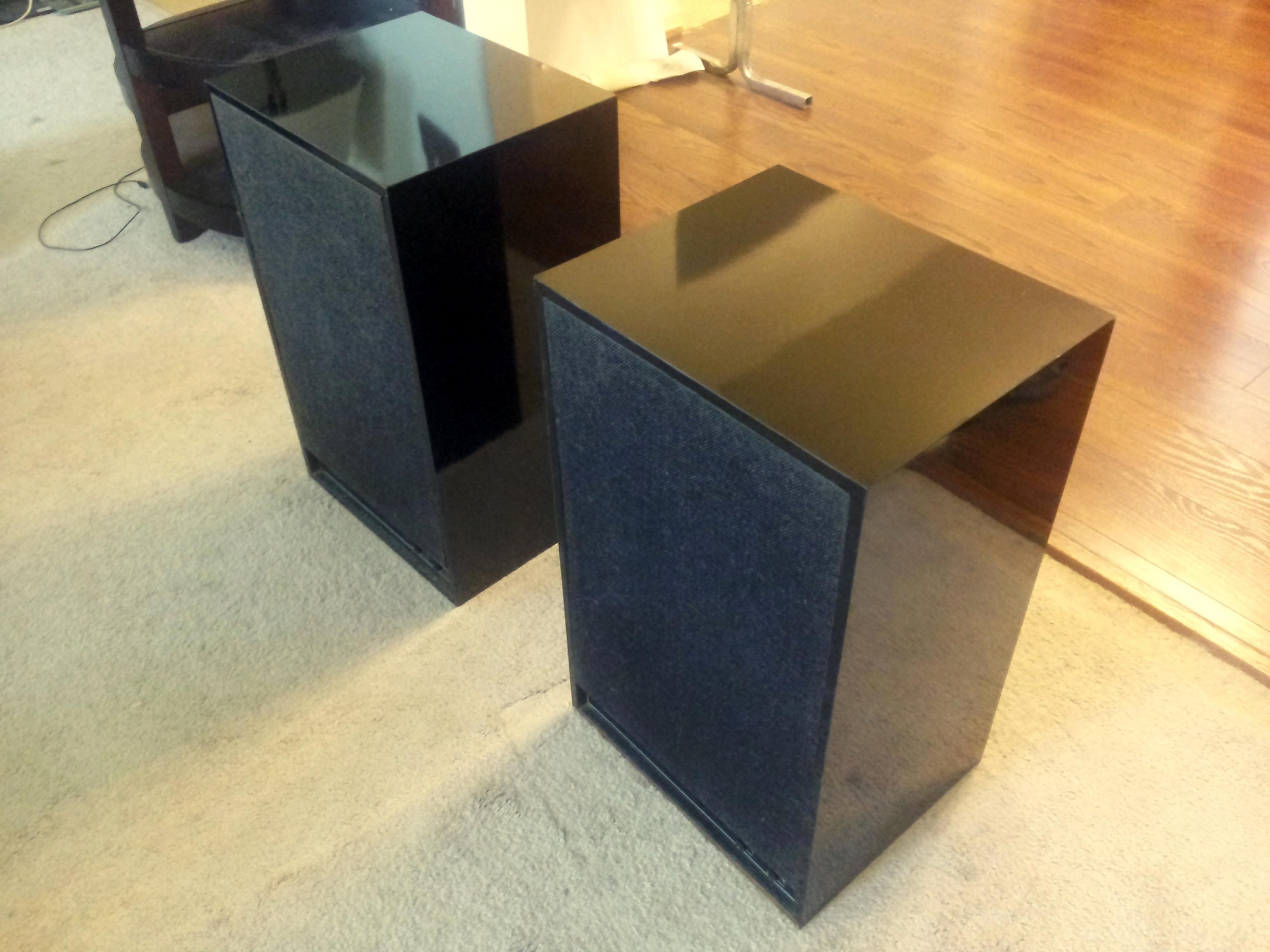

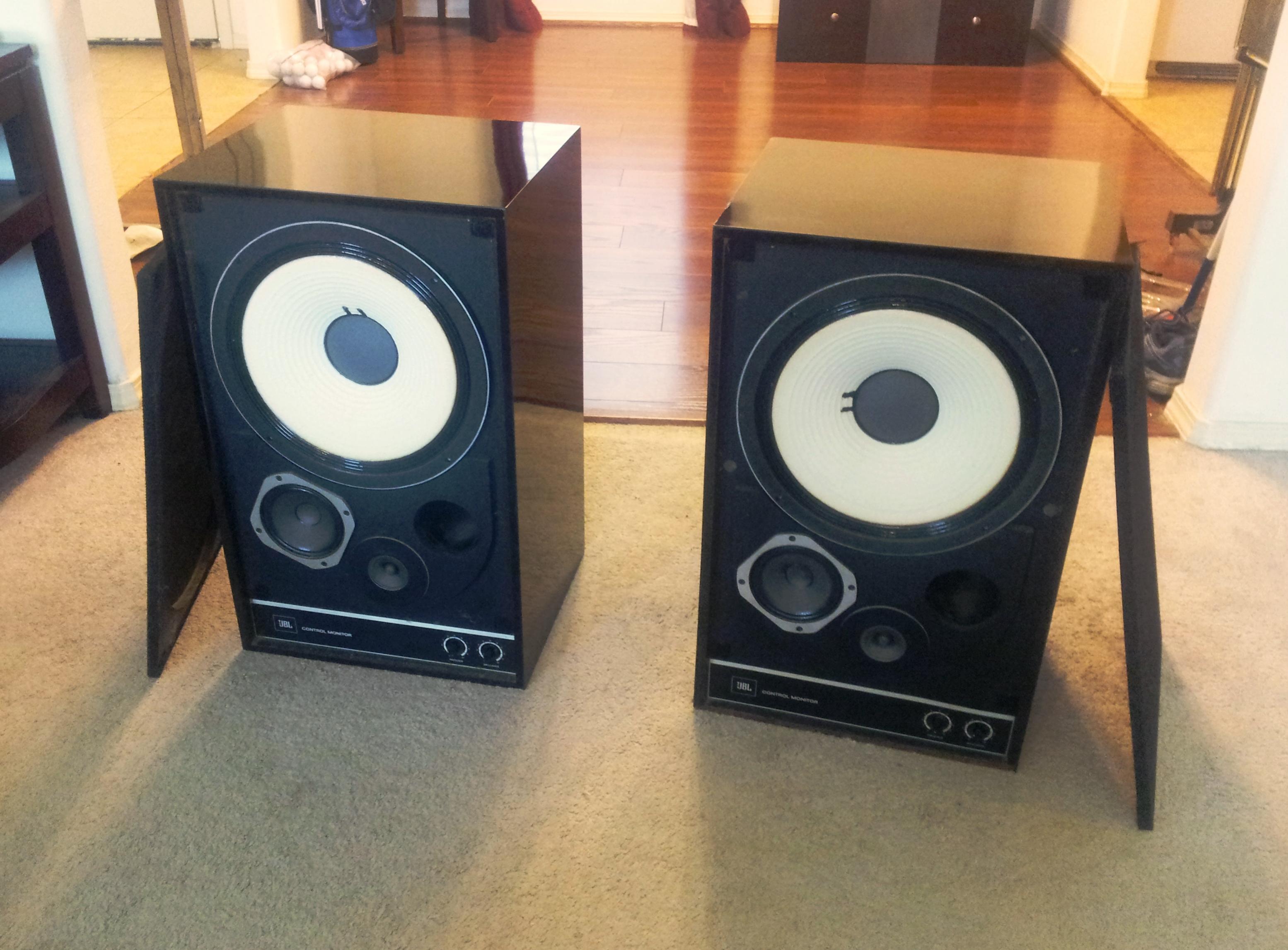

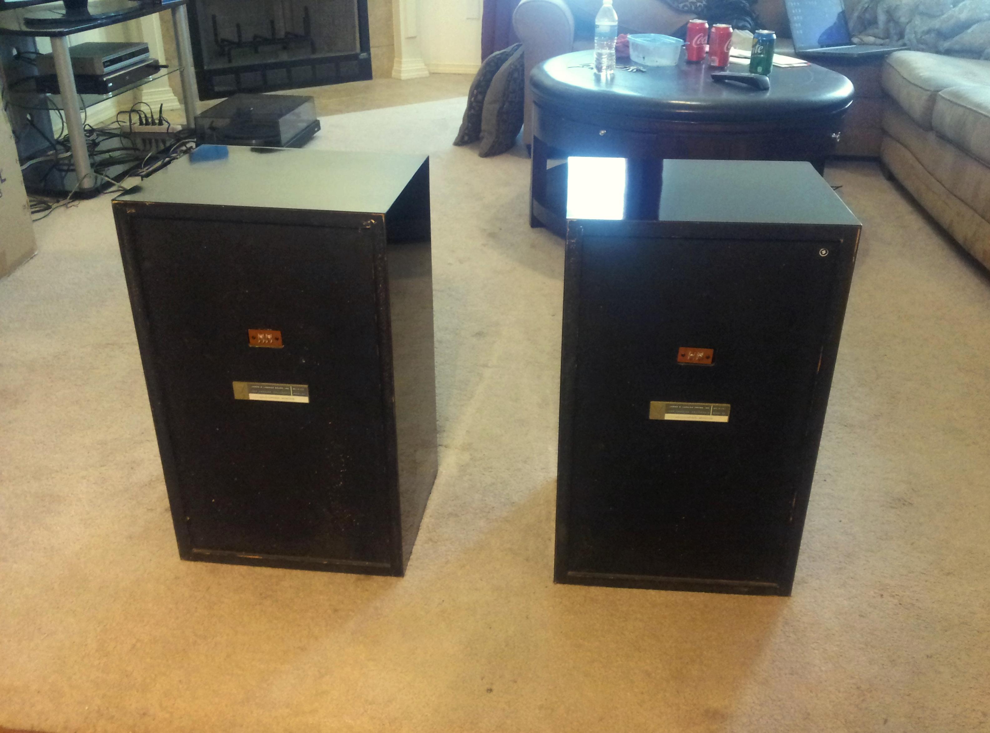

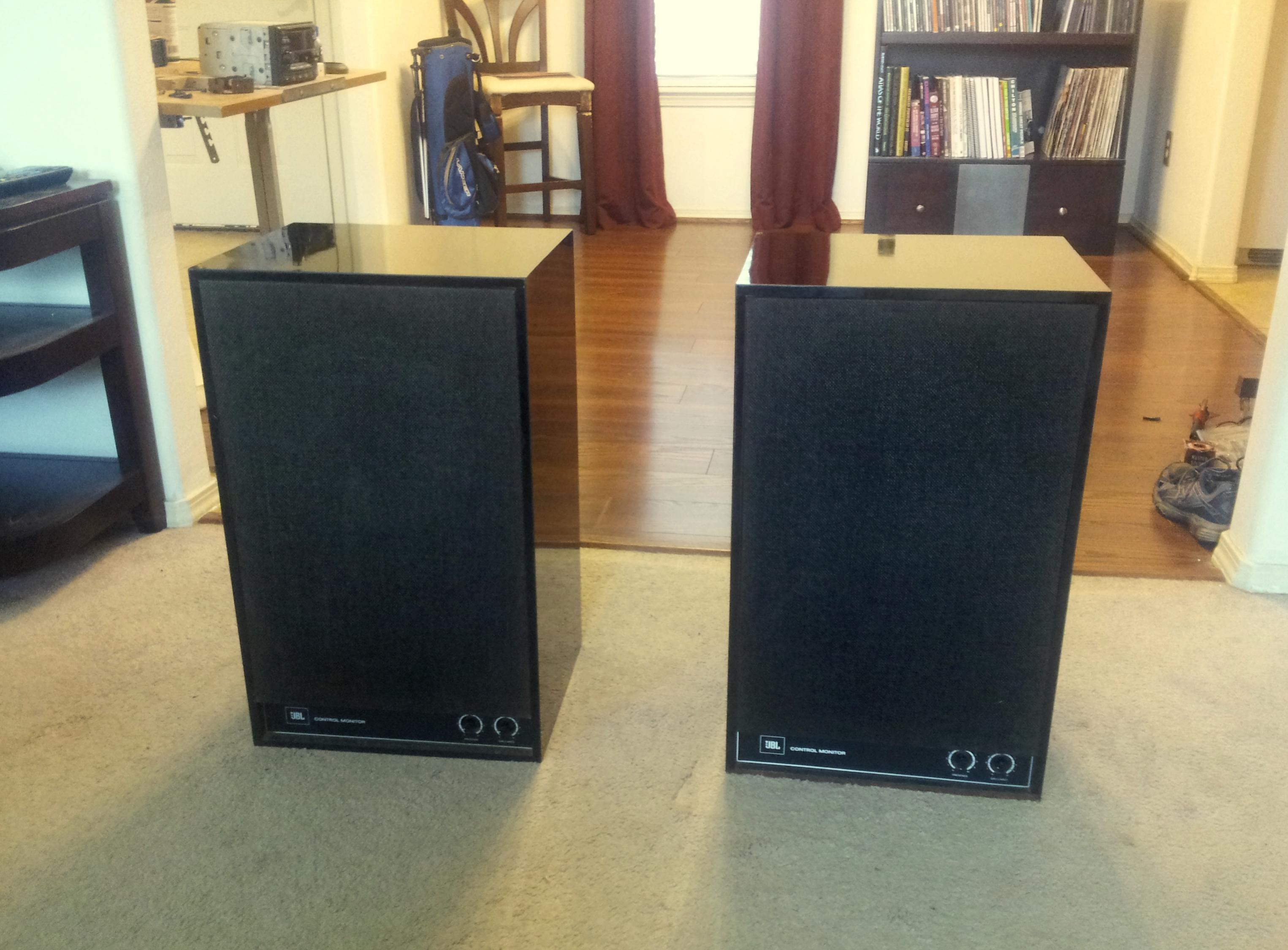

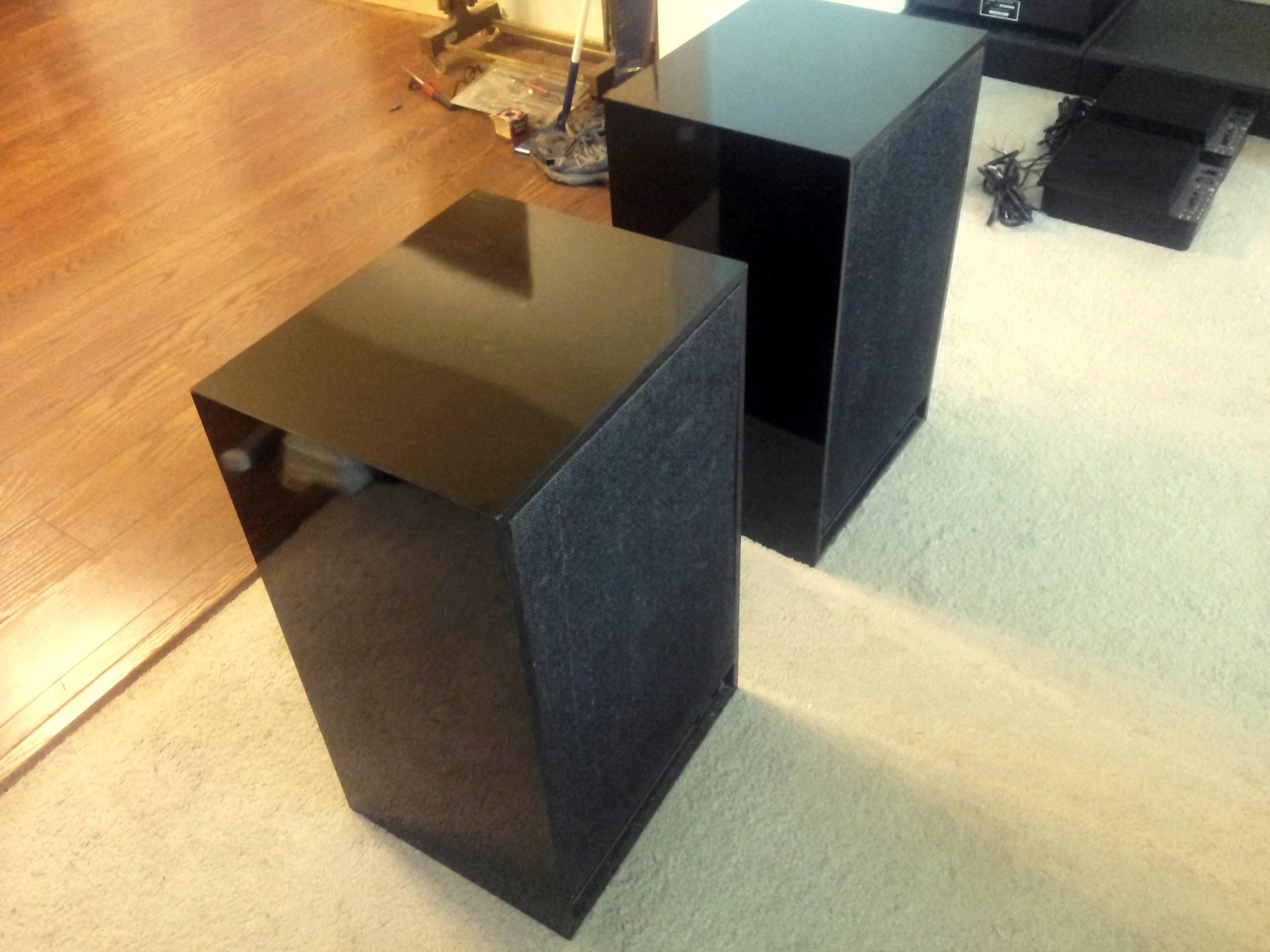

Hello all, my first post here on diyaudio! I just joined the site due to the fact that I too was looking for an answer to this question- I recently purchased a pair of 4310's which I found on facebook marketplace for $30!! 😱 They have a beautiful (IMO) gloss black finish. The finish appears to be factory to me, it is WAAY too nice to be a home job and there is no sign of overlayment or anything that would hint that it was done aftermarket (but I'm no expert.) I have included a few pictures here to show you. Hope someone can answer this for the OP as well as myself, since all the pictures I can find of these online appear to be either the woodgrain or gray finish. Thx!
