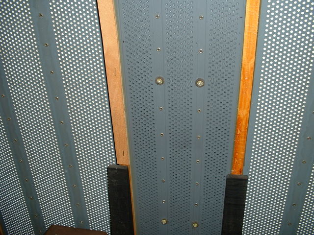

Hello,
Have attached an image of the back of the els57. What I am concerned about is there is no dust covers on the bass panels, but also look at the rivets. Doesn't appear to be bad corrosion but there is some leakage I suspect.
Was wondering if IPA would clean this up. With new EHT boards being installed I guess there is some leakage from the diaphragm to the grounded rivets!.
In the treble panel, the picture does not show the small ripples in the centre of the panel, but I may try a heatgun to smooth it off. Just start with low temperature at first. PS. there isn't any holes etc in the treble panel dust covers.
Advice appreciatted.

Hi Fanuc,
Looks like a bit of coloration around the rivets, I've seen it before and it's not necessarily a problem. I've seen much much worse.
First you need to find out if you have a problem. Vacuum it out, hook it up and listen for strange noises. If you have a high voltage probe check that the HT is up to where it should be.
Those rivets are not grounded, in fact there is a very high chance of them being connected to the bass panel HT which is +6KV.
The foto is too low quality to say anything about the treble panel dustcover. I do notice a small black spot on the the treble panel right in the middle which could be caused by arcing. Perhaps you can make some close-up pictures?

Hi Fanuc,
I also restored some Quad ESLs myself. As arend-jan suggested, have a closer look (and smell!) at the middle of the treble panel. Trebles go wrong frequently by arcing. Bass panels never. This is because the metallization of the treble stators is inside, so the diaphragm may touch the stator when it is overdriven. The metallization of the bass stators is outside.
If the treble has a burnt diaphragm, the only cure is to replace it.
Never use the bass panels without dust cover. A dust bridge will build up very soon (or invisible soot particles from the air), it will arc, and it is nearly impossible to clean the inner side of the stators and the diphragm.

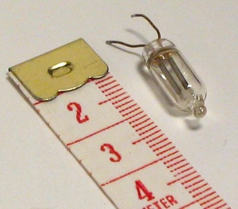

A simple method for checking the leaking is to insert a small neon lamp in series at the HV supply. I use separate lamps for both bass panels and one for the treble panel. If there is any leaking, the lamp will glow or blink. Some 80 Volt is falling on the lamp, which is negligible to 6 kV or 1.5 kV. I installed the lamps permanently - they improve the sound.

oshifis said:A simple method for checking the leaking is to insert a small neon lamp in series at the HV supply.
This is indeed a cheap and fine working leakage indicator, thanks for bringing that up!
Personally I have never noticed any change in sound with or without the bulb. Nor can I find a reason that it should. Some have argued that the bulb would 'disconnect' the HT from the panel which IMO is not happening. But I don't think it will hurt to leave the bulb in either.
Hello here, bit of thread necrophilia!
Could anyone show me exactly where to insert this neon bulb? A picture would be perfect, a sketch would be good, I would settle for an idiots guide🙂0
It is best to use three neon bulbs. Connect one in series with each HT wire that is going to the center binding post of each panel. I soldered one leg of the bulbs on the HT pins on the rectifier block, and the HT wires are attached to the other leg of the bulbs. If you wish, add some binding posts, becase the legs stretched by the HT wires break easily.
