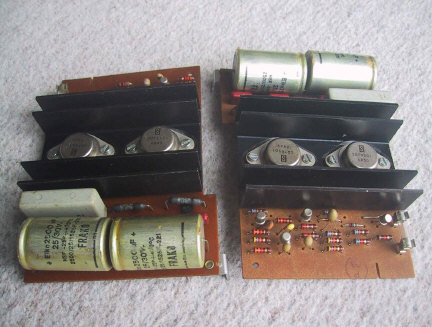

I've measured the tan-delta and capacitive values of many old electrolytics.The number of them which could be said to be bad is very low. The last ones tested were four examples coming from the 10 W power amplifier fitted in the Revox A77 recorder which is 40 years old. They were FRAKO Elko 2500 µF 35-30 V. They had no voltage across them since years. For the four examples, the capacity was higher than 2700 µF, two around 3000 µF. Tan-delta was 0.1, one of them 0.12.

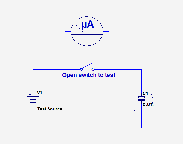

Measuring the leakage of E-cap is not difficult:
After some hours of reforming, use the following arrangement.
Note that a DVM in the 200mV range also behaves as a nanoamperemeter, 20nA full scale
