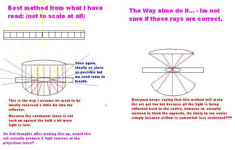

Hi there, I have a perfectly spherical ditronic/fs(is that it?) reflector out of a ELMO overhead projector, now they put the bulb arc at roughly 2.5cm away from the reflector rim... but from all the searching I have done, im under the impression that the arc is ideally ment to be mounted basically dead on the rim, even a little bit recessed to get the arc right on the rim(centered) if you know what i mean.
So whats the real freakin deal?
The second way is the correct way. The only reason that people say to put the ark at the rim of the reflector is because they are probably using a soup ladle, which is a half sphere. Most pro reflectors are less, more like quarter spheres.

The easiest way to find the R1 focal is to set somthing in the middle of the sphere until its reflected the same size, in other words the object reflected you shouldnt see any bigger or smaller then the actual object.
