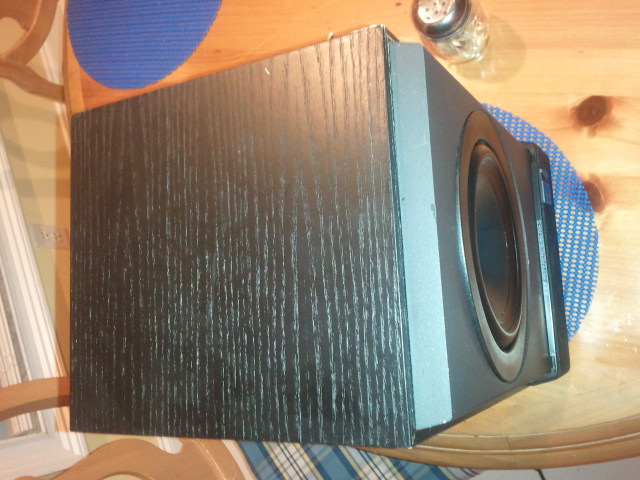

Here is the top of a KEF 101/2 that portends to be my first victim/guinea pig. As you can see it appears to be a paint more than a stain.
A word about this particular victim, I purchased a set of 6 - 101/2s without listening to them. 5 worked fine, but this one appear to have received a bit of a shock. The frame of the woofer is cracked and the center post has popped loose. The tweeter works well. The crossover seems good. The cabinet is in pretty good condition. Kef said they would sell me a woofer for $150, which isn't too bad, but that is half what I paid for all 6.
So, since I didn't pay too much for it I thought I would try this. If it works OK, I will do another, and move a working woofer into this cabinet, and have a pair of Franken-kef's.

From your picture it appears to be a paint over ash veneer. More than likely it is a lacquer finish that can be difficult to strip with consumer stripping products. The second problem you will have is that the ash has very deep pores, and no stripper will get in there to remove the finish. You can steel wool, wire brush and sand, but there is a very good chance that you will go right through the veneer trying to get the finish off.
I would first email KEF and see if they can tell you what the finish is and the underlying veneer.
If they were my speakers, I would either repaint using a Krylon lacquer if a painted finish is desired, or better yet would be to re-veneer the cabinets in the wood of your choice.

Natural Ash has a pretty light, even color. Grain texture is very similar to Red Oak. My guess is that the maker didn't use a premium veneer ... probably had brown streaks. Dark finish cures all ills.

Typically ash is left natural (think baseball bat), stained to look like oak or as in the case of speakers, painted.
I think it will be impossible to get the paint out of the pores and get a nice surface to work with. Veneer is really the way you want to go if you want a nice looking end result.

ever consider that it might be grained vinyl? these were a lot more common than you might think, in which case any type of solvent based product will do far more harm than good
I'm with vintagesound on this one - either repaint with a product specifically formulated for plastic, or reveneer - a process itself not without issues going over top of a vinyl finish. You'd probably want to scuff sand, bondo for pore filling (otherwise expect some telegraphing of pores) , and use white glue and clothes iron.

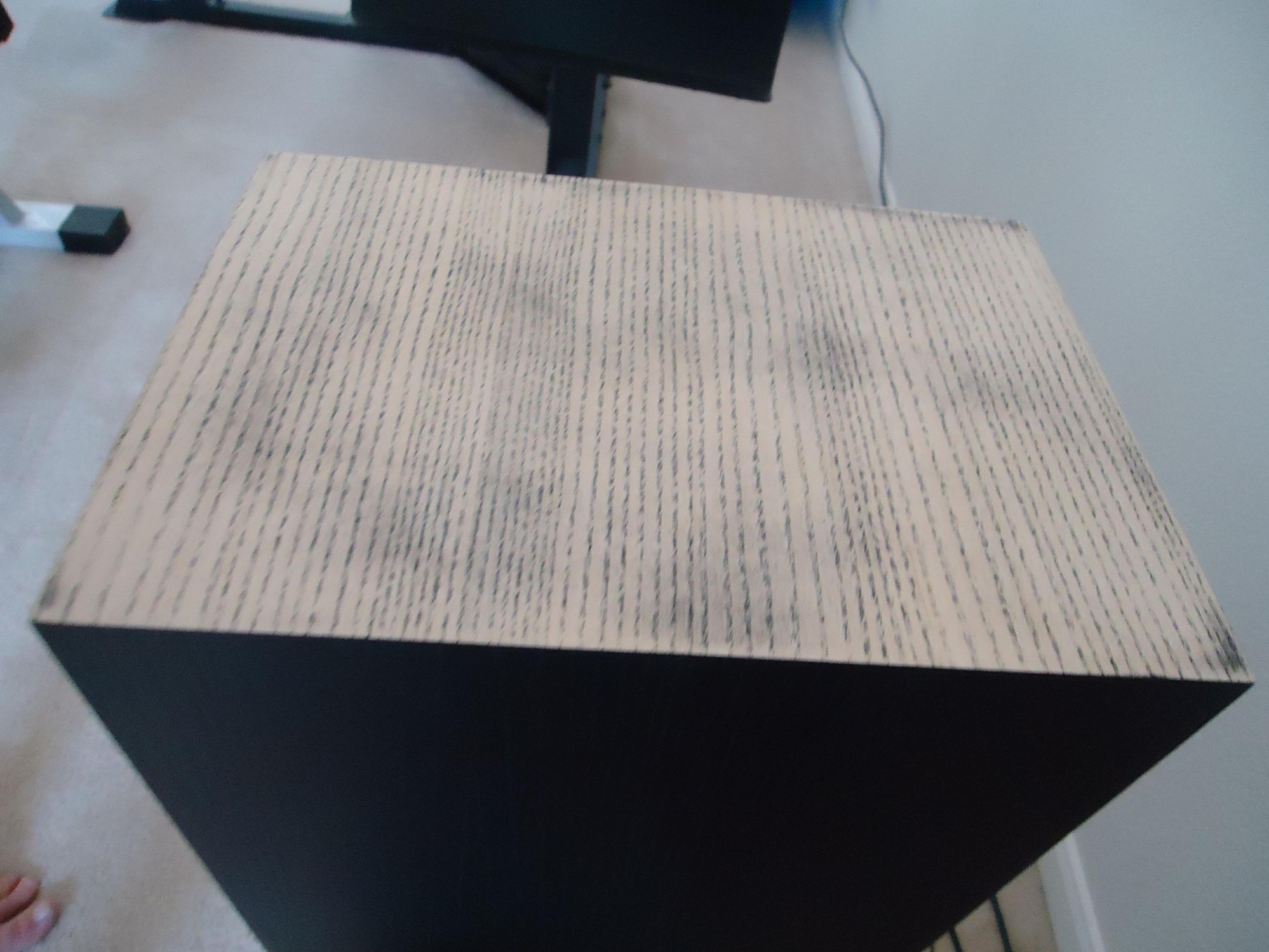

Don't use a stripper, imo.
It raises the wood surface.
I'd take the bottom, with a palm sander, maybe 600 grit max, quality dust mask or respirator (best), and sand part of the surface down until you see wood. See what it looks like. work dry, no water.
Ash is an "open grain" wood. so the pores will hold the black. Not all bad.
You can apply a variety of colorants, stains, and dyes to the result.
Stains usually contain a solid pigment that is designed to stick in the pores, clearish color.
Dyes, are just color.
There are "clear" coatings that have color and sit on the top, "varnishes" mostly,
urethane mostly, but have "stain" type stuff in them...
With the remaining black in the pores, you have something to work off.
I'd get some scrap ash or oak (similar enough). Paint black with a lacquer spray.
Dry thoroughly. (bake in oven at 100-125F for a few hours, then let cool for a day or so in a dry location). sand that off, then you will have pretty much the look that ur wood is likely to show on the KEF boxes.
Now you can test away! 😀
