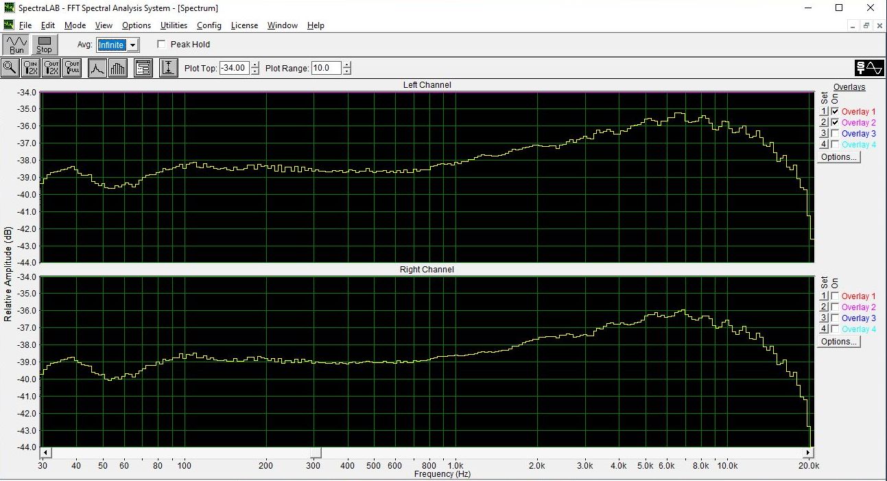

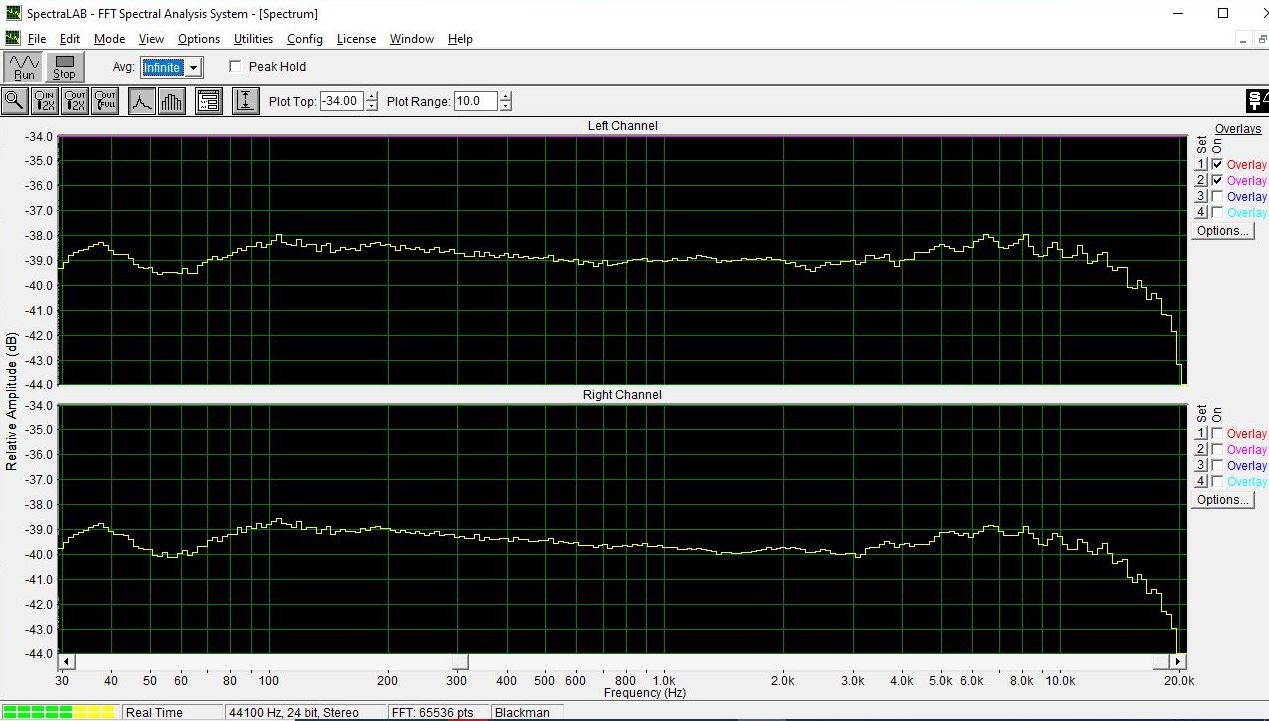

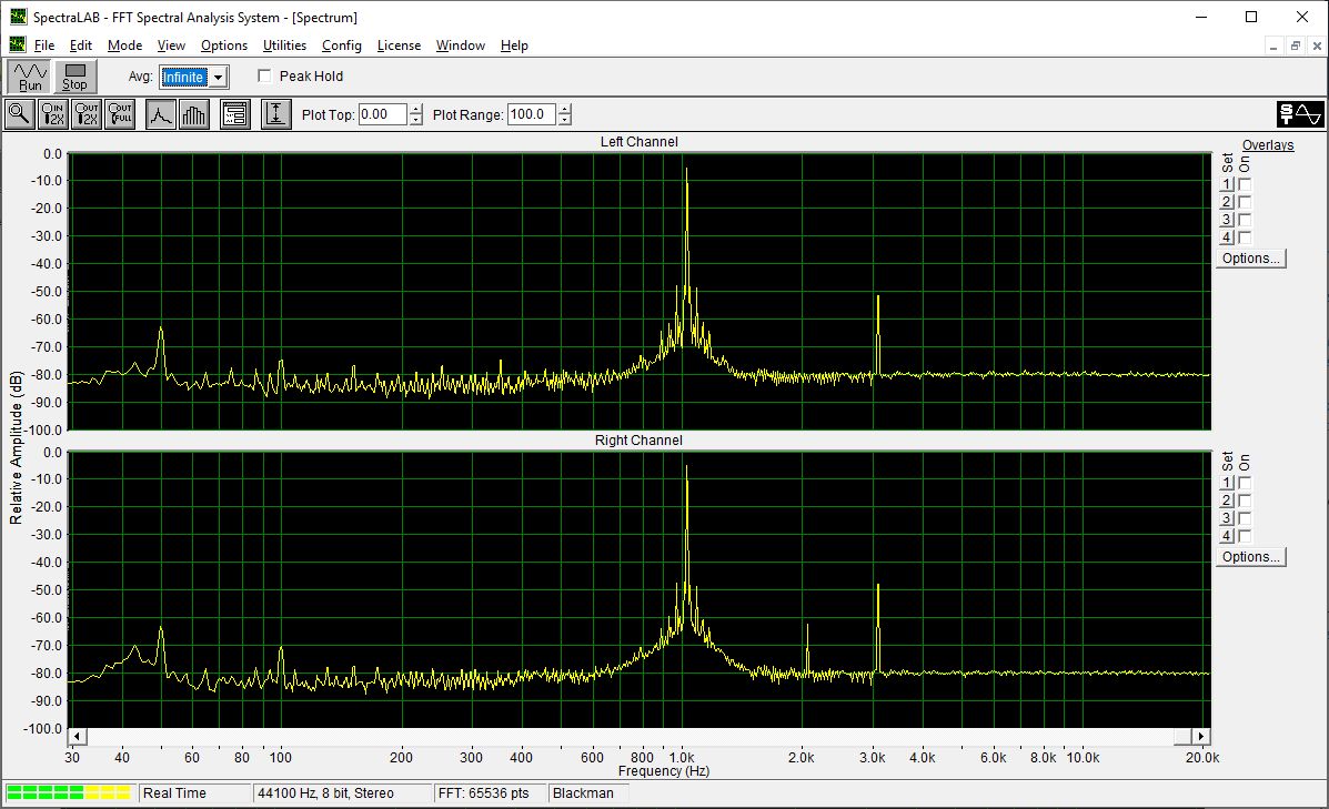

Now came the tricky part: the recording bias. I fed a low distortion 1kHz sine to the line input, and monitored the output with a distortion analyzer. I fed the residual (distortion+noise, i.e. the 1kHz filtered out with a notch filter) o the oscilloscope. Then I adjusted the bias until the distortion (mainly 3rd harmonics) and noise were the lowest. The VU meter showed increasing level when I increased the bias, and then dropped by about -0.5dB. This setting gave the lowest distortion.

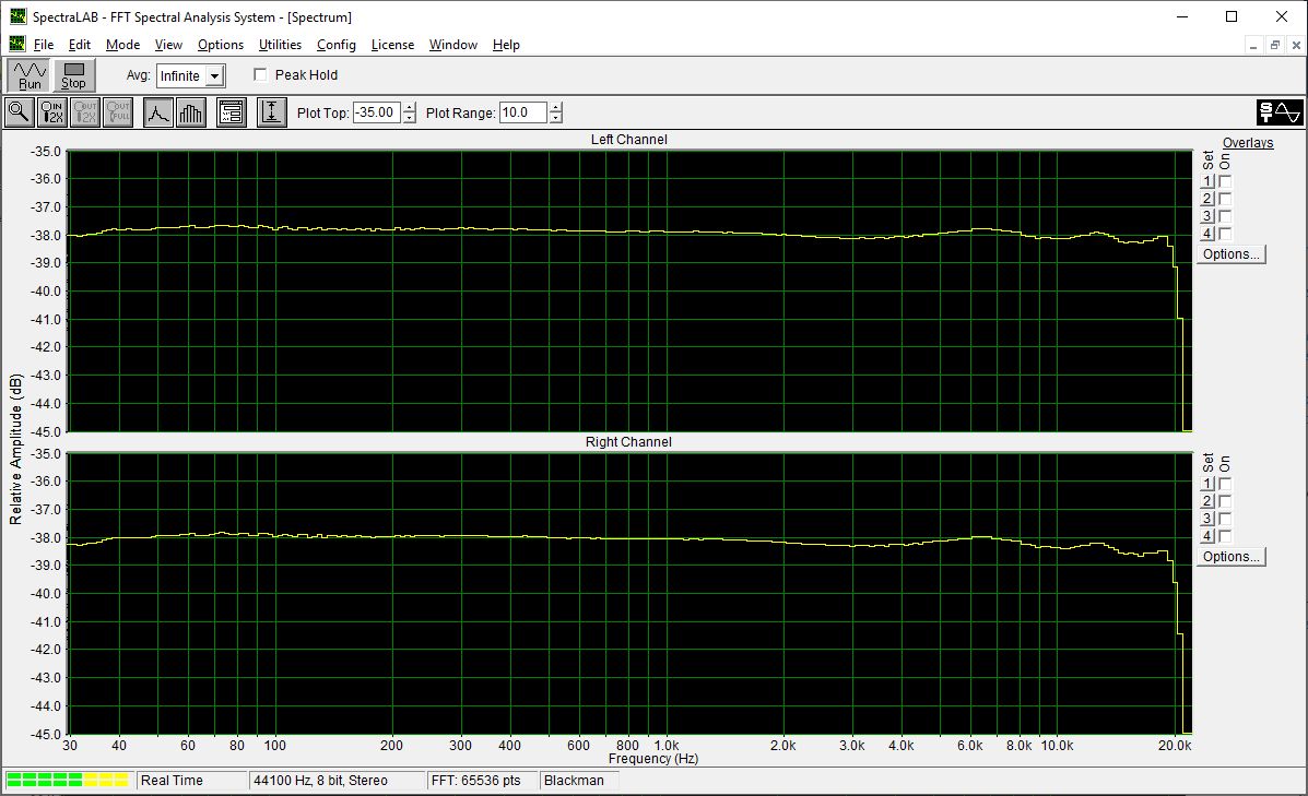

I checked the frequency response with a pink noise generator that I originally built for loudspeaker testing. It is basically a PRBS (pseudo random binary sequence) generator in a MM5837N chip, and a subsequent -3dB/slope R-C filter. The first picture shows the frequency response after having done the above adjustments. I did not like the 3dB rise in the high frequency region, so I adjusted the playback EQ a little bit back. The second picture shows the result. The recording level was around -20dB.
If the Play EQ is per IEC Calibration tape, recording using maker-specified tape, level is not-high (-20dB may be good, though I would prefer sine-sweep to pink-noise), and bias is good, any residual error should be fixed in Record EQ. (Yes, you can't buy Sony 150 or SLH tape anymore, and modern tape may be a hair hotter than what we had in 1974.)

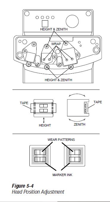

An issue I noticed is that the tape is wandering up and down at the playback head. This can be observed with a magnifier glass and a torchlight. It could be 0.05 to 0.1 mm deviation from the steady run. What could be the reason and how could I eliminate this wandering? I suppose this is the reason the Lissajous pattern is showing some phase variation at high frequency.
Old tape. Warped reels. Worn tape guides. If in-sync with capstan, pinch roller, or scrape-roller rotation, dirt/wear in these parts.
0.05mm is very small and may be normal on this class of equipment. Yes, it would skew HF phase; we did not worry too much about that in those days.
It could be normal for this machine, could also be a sign of a number of things in no particular order:
This is why analog sucks says the guy who owns 4 Otari tape decks. 😀
- Excessive tape tension
- Insufficient tape tension
- Tape head wear (contact area not uniform)
- Insufficient contact pressure capstan to pinch roller
- Incorrect tape wrap settings
- Bearing runout in the pinch roller
- Worn pinch roller
- Worn tape guides
- Misadjusted reel table height
- Warped reels

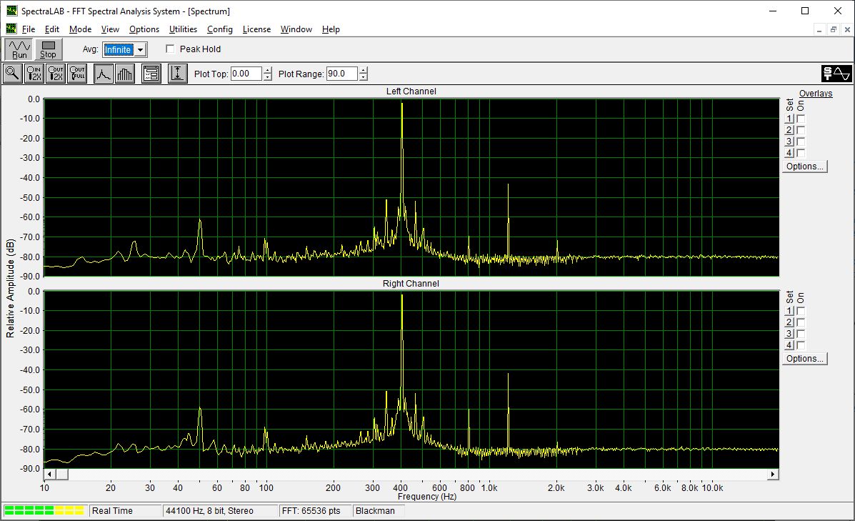

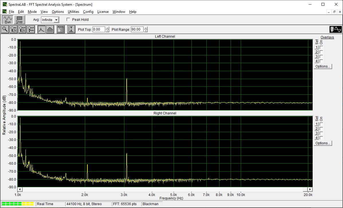

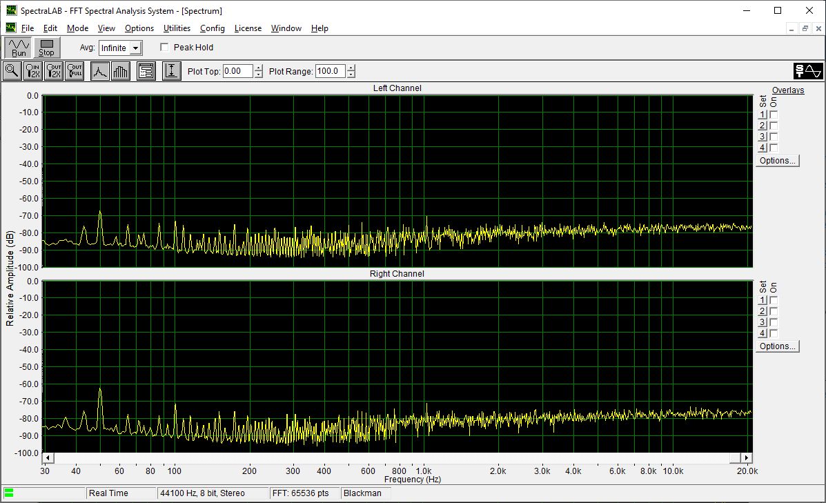

3rd harmonic @400Hz and @1kHz
What was the recording level, speed and EQ for these measurements?
Numbers look reasonable I just am not sure what the actual levels are - 10dB from standard reference level for the tape formulation and EQ you are using?
I calibrated the machine for 250nWb/m reference level, 0dB VU on the meters. Although the service manual calls for 185nWb/m.
I used BASF DP26 tape, recorded at 0dB VU @7.5 IPS. I don't have any more modern tapes. This gave about 56dB S/N (A-weighted) and about 0.8% distortion.
I really don't know what is my goal with this tape recorder, apart from having fun with its restoration. I don't have any plan to make live recodings at concerts like I did when I was younger. And there is no reason to record for FM radio, since there are no worthwile programs available. Perhaps borrowing some LPs? It does not work, obviously I wouldn't lend any of mines either. I still need to find the right source. Or just donate to them:

Your Sony is a NAB EQ recorder and for calibrating its frequency response with an IEC calibration tape, you need to apply corrections at test frequencies which are available in conversion tables below.
The 250nWb/m for 0dB may be a bit too hot for this Sony as it is effectively pushing it around 3dB above its specification. Thus, BASF DP26, which is an old, low output tape, was exhibiting 0.8% distortion on Sony at +2.6dB.
Try setting it as per service manual:
- set the playback level to -2.6dB (573mV on VTVM, don’t use VU meters for calibration) with 250nWb/m tone
- using your IEC calibration tape, frequency response section, set the frequencies using the following corrections (0dB=-10dB on your calibration tape):

This should get you a flat frequency response.
Overall performance will depend on the condition of your machine, primarily on heads. Tape skewing might be due to bad roller, misaligned tape tension, and so on. You need to go trhough the service manual before measuring what your deck can do.
