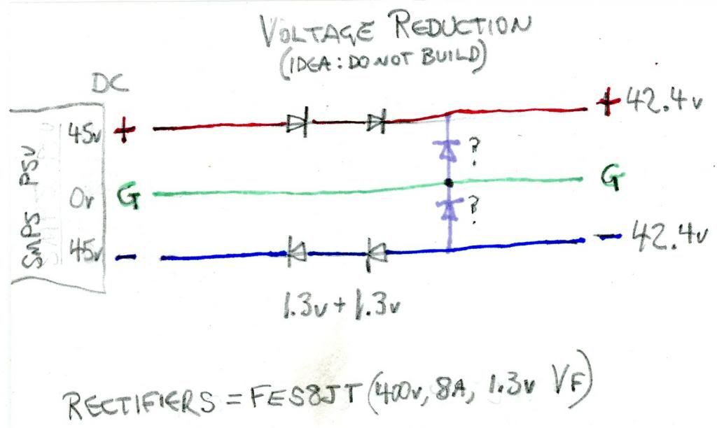

My SMPS PSU is very near the voltage limit of my LM3886 chipamp. +84v (42,0,42)
I assume there will be some voltage sag, even when idle. I tested the PSU under various resistor loads...it does sag, though not greatly.
I'm not sure what the idle-load will be of the amp circuit.
(Datasheet says quiescent is "50mA typ. / 85mA limit"....I think this per LM3886, using their test circuit #2)
If I wanted to create a slightly lower and safer voltage limit, is my drawing one way to do this ?
Are the violet rectifiers necessary at all ?

You could use a rectifier diode to drop ~600mV, or a string of diodes to drop more voltage. Or replace the string with a lowish voltage power Zener.
Or add a CRCRC filter between the SMPS and the Chipamps to clean up the supply to the analogue stages.
Note that 84Vdc is the absolute max for a signal present condition. If no signal is present then upto 90Vdc can be safely survived (and a little bit to spare).

You are right, the voltage drop of a silicon diode is between 500mV and 700mV.
I knew this was the typical value for such diodes, but I wonder why the datasheet would say Vf is 1.3v ??
Maybe I'm not understanding how they arrive at that figure.
I'm guessing it's because that's the "worst case"......The Vf spec says "Maximum instantaneous forward voltage at 8.0A".
....and I just tested these rect. diodes.....indeed, a 0.6v drop.
So five of them in series would give a 3v drop.

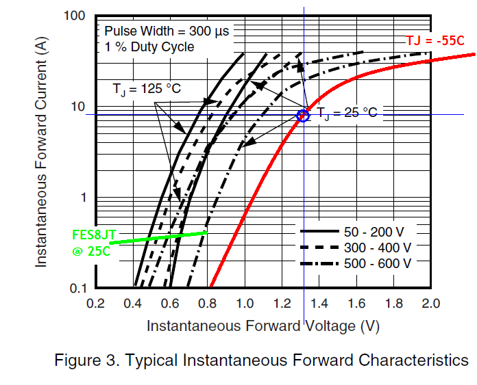

Take a look at figure 3 on pg. 3:
Vishay - datasheet pdf (opens PDF)
Vf = 1.5V maximum (for the FES8JT from the table on pg. 2) is what happens when you hit it with a 40 amp pulse for 300 microseconds at 1% duty cycle. 🙂 Lower forward currents produce a lower Vf, as per the graph. 8 amps is the maximum continuous (non-pulsed, average, DC) current for the part.
On the FES8JT datasheet, the Maximum Ratings section says that junction temperature (operating) must be in the range -55C < TJ < +150C.
They give IF versus VF at the upper end of the temperature range but not the lower end. Shifting the curves over by a distance that looks plausible, I get the red curve shown below. At IF= 8 amperes, VF is 1.3 volts, for the 600-volt rated FES8JT when TJ = -50C.
Good point, that 40A (probably 35A more accurately) pulse is with a 125C = 257F junction temperature.
