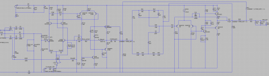

This was a fun and easy mod. You don't have to drill much and there's plenty of space to add the few new components.
I only modded the flat amp, I didn't touch the tone amp or the phono amp.
The factory flat amp simulates at a -105db distortion floor. With mods it simulates at a -120db distortion floor. Both sims used a worse-case source impedance of 25k.
The mod works like this:
- Replace the FET input stage with degenerated bipolars.
- Modify the input network to be AC-coupled to work with the bipolar's nonzero base current.
- Remove the Miller compensation cap, use lag compensation instead.
- Add a capacitor to the factory cascode to strengthen it. This allows for good distortion performance with high source impedance. Without it, the Early-effect nonlinear base current in series with the source impedance will introduce an error that cannot be NFB'd away. This cap must be large enough to work at LF.
- Adjust a few other component values (C706, C707, R715.)

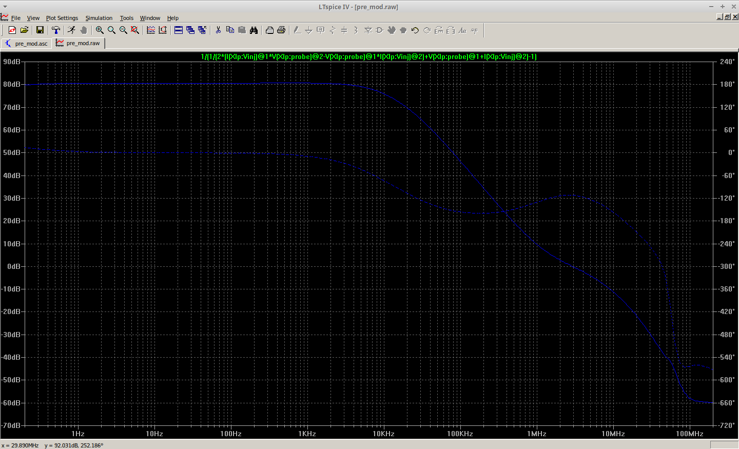

Why the compensation change? The R-C pair at the tail of the input stage interacts less with the lag cap than the miller cap. This lets us give the overall loopgain plot a deeper phase dip and allow more NFB in band.

A possible criticism of this mod is that the output stage transistors don't carry balanced currents anymore. Maybe it could be further improved by bringing them into balance.
From the factory, you were supposed to adjust a pot (which the mod removes) to get the output DC offset to zero. I don't really understand the need to zero the offset when the output is AC coupled anyway, it seems like an odd design choice from the factory. Maybe it was supposed to be DC coupled originally and then the design changed.
With the mod, there's always a DC offset at the flat amp output of about -3V. The AC coupling cap, which is a bipolar electro from the factory, could be replaced with a polar cap (or just go for film.)
Honestly, I would have left the FET input. Now you have a lot of input current noise to contend with. Going by output DC offset, input bias current appears to be the better part of 13 µA, that's 2 pA/√(Hz) in terms of shot noise alone. This is not a power amp, where such matters would be secondary and/or you could rely on lowish source impedance.
What transistors did you use for Q703a/b, the 2SC1815 indicated? Beta comes out to under 300, you really want a type with some more. 2/KSC945, 1845.
You're lucky that the cascode bootstrapping worked as-is - I generally had to add a few hundred ohms in series for things to remain stable in sim.
It may have been a good idea to take some measurements in "one channel modified" state at realistic levels. Anything audible should definitely show up there.
Since the input stage is not exactly drowning in current sources / mirrors, the power supplies may be worth investigating (e.g. potential shared ground returns between audio and bypass caps). I would also assume any small electrolytics that are not low leakage types (e.g. the orange Elnas) to be in need of replacement.
@sgrossklass: Good call, thanks for pointing out the noise increase. Spice predicts the original circuit makes about 135nV/√(Hz), the revised circuit is near 220nV/√(Hz) with worst-case 25k source impedance.
I used 2n4401's on one channel and 1815s on the other channel. This was done out of the spare parts bin...
A possible avenue would be to swap the FETs back in to reduce noise floor, remove the degeneration on the input stage, and add a cascode below VAS transistor Q705. The cascode decouples the lag cap's effect from the effect of C706 and approaches the ideal 12db/octave loopgain roll-off. Then with a couple component values adjusted the circuit can make >75db of loopgain in band, for -130db distortion performance (wow!)

Latest schematic is attached.

Here's the latest schematic. There are a few diffs here from the last one; at some point I adjusted the compensation for broader stability margins too, and added a current source in the LTP tail for the 2nd (tone control) stage as well, to improve its PSRR.
This project turned into a Frankenstein somewhere along the way; this C55 needed more changes than average to get it performing at par. Quite a contrast to the Onkyo A-5 preamp whose TA7136 opamp -- a part known for noise and radio pickup -- was possible to tame with a few compensation changes and no drilling.
