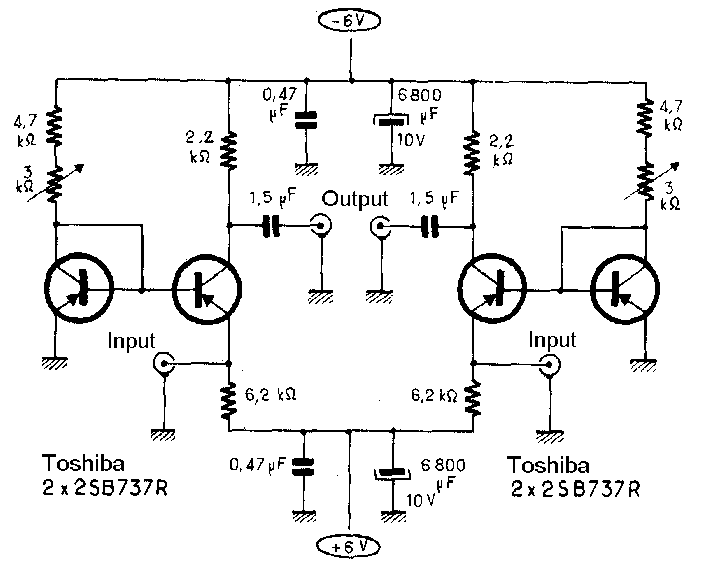

I was asked if it's possible to reduce the gain of a Hiraga pre-pre. The reason for doing this is that the gain of the following stages is too high (could reduce the gain there, but....)
I attached the Hiraga pre-pre schematic for those who are not familiar with it.
Any suggestions, ideas, comments?

What DF96 said and also the collector resistors in the current mirror as well - try to keep approximately the same ratio range between the mirror and amplifier collector resistance.

Ok -- how far can I take this? And how will this reduce the gain?
Why change the current mirror? That is just a bias source, with perhaps some degree of thermal tracking. Changing the collector resistors will shift the DC collector voltage but that doesn't matter as the output has coupling caps (although no ground leak resistors).
The gain is just gm x Rc, so halving the collector resistors halves the gain.

Ummm... And gm=Ic/Vt, so decreasing the collector current also decreases the gain. Now the bias current is (Vc-Vbe)/Rbias, and the voltage in the collector is Vc-Ic*Rc=Vc-(Vc-Vbe)*(Rc/Rbias) and the gain is (Vc-Vbe)/Vt*(Rc/Rbias). Therefore, if you keep the resistor ratio constant, the gain and the collector bias voltage won't change.
FWIW, this schematic, implemented with real life discretes, sucks in any way I can think of. For example, the common mode gain has zero dB PSRR, and any inherent asymmetry in the differential mode will amplify the common mode crap. Thermal tracking of four discrete devices is virtually impossible. Current through the cartridge is zero only if the gain transistors are perfectly beta matched and all four transistors are perfectly thermal tracked (not gonna happen). Etc...
Yes it is a spectacularly bad circuit. I was too polite to point this out.Waly said:FWIW, this schematic, implemented with real life discretes, sucks in any way I can think of. For example, the common mode gain has zero dB PSRR, and any inherent asymmetry in the differential mode will amplify the common mode crap. Thermal tracking of four discrete devices is virtually impossible. Current through the cartridge is zero only if the gain transistors are perfectly beta matched and all four transistors are perfectly thermal tracked (not gonna happen). Etc...

Presumably the input impedance depends on the transistor's beta, so will be highly variable.
With a cartridge connected, there's probably some very significant asymmetry in the frequency response of each channel due to this.

No. Emitter input impedance is just 1/gm so is set by current alone. This will be quite well balanced as it is primarily set by the negative supply rail voltage and emitter resistor values.monty78pig said:Presumably the input impedance depends on the transistor's beta, so will be highly variable.

Incidentally, this preamp can only be used with low to medium output MCs. For a BJT the %THD is about equal to the peak mV input at the base-emitter, so only SET fans will wish to put more than about 1mV into it.
