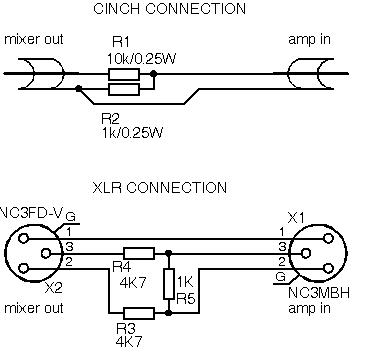

I have a Stereo preamp mixer which has a Line Output and is feeding into a Power Amp.
Can I somehow reduce the Audio Line output amplitude on the mixer using some sort of a attenuator, or perhaps inline resistors?
I'm finding that I have to have the amp volume controls very very low and still finding that my mixer output volume is set to half.
What I would like is to use my mixer volume controls to the fullest and not have the sound so load, but to do this I have to turn the amp to about one notch. What could be wrong?

If you connected the mixer to a professional PA amplifier, the levels would be OK. But, if you connect the mixer to a home amplifier then the overall sistem gain will be too high. The simplest method to reduce the gain is inserting an L-pad resistive network (for example 10k/1K inside a cinch connector).

I did look up the L-Pad as you've recommended, can I just put one resistor in series to each channel on the outputs? Will that effect the quality or anything else? The reason I'm asking because I would like to keep it plain and simple without inserting a sub PCB
Due to it being low signal I guess I would'nt need to use anything bigger than a quarter watt resistor? is this correct?

you need two resistors.
Look at the picture below (20dB pads).
All resistors are 1/4W.
Milan

This may sound stupid but why 2 resistors? Why not just have 1 resistor per output inline on the output connectors.

Amplifiers usually have 47kohm input impedance. To get 20dB attenuation with this impedance, the series resistor shoud be around 470kohm. This is the high impedance Lpad which is prone to EMI's and may inject noise, linear amplitude and phase distortion into the system. (in a nutshell)
