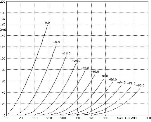

Yeah, My thoughts exactly! I made a quick guesstimate of where it is biased (-40V, 62mA 420 VP) THATS 26 WATTS!! The chinese tubes are probably BEGGING FOR MERCY!

It looks like you are at 53mA Cathode current w/Bias of -36V, according to the curves I have for a 6L6 that puts your plate voltage at about 380V.
So Power (watts) = I(current) X E(volts) or 380 x .053 = 20 watts just above the rated dissipation for that tube.
Now that is just a guess. Best bet is to measure the voltage at the Plate Terminal.
Plate terminal is #3, check DCV to ground. Do you have a set of curves and datasheet for those tubes?
post them if you do.

When looking at the recieving manual for the 6L6GC I see several columns.
Class A1 amplifier, Class A1 amplifier Triode connected, Push Pull Class A1 amplifier...AB1
If I look at the triode connected column, the design maximum is 450 Vp,
and 30 watts plate dissipation.
I should have been under 30 watts, even with my previous cathode resistors,
is it the 2 v. over plate that would cause the plate to glow?
