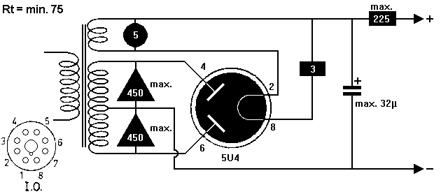

I need to use a 5U4G for a friend's preamp. The preamp needs a B+ of 330VDC. I downloaded the datasheet of 5U4G and looked at the pinout but can't figure out how to wire it. I was told this is a "Flaming Valve" and the output voltage is taken from the filaments?
Can anyone please give me a circuit that shows the wiring of this diode? I am so confused with this filament output scheme and I don't want to blow-up my friend's 5U4G.
Thanks!

fdegrove said:Hi,
This is a typical circuit using a cap input supply:
Cheers,😉
Thanks a lot Frank! I knew you'd rescue me! 😉
