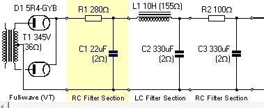

Rectifier plate impedance/resistors
Rectifier datasheets often specify minimum plate impedances, but can I get away with using one big resistor after the rectifier (but before the first filter cap) instead of putting two resistors on the plates? Like so:
