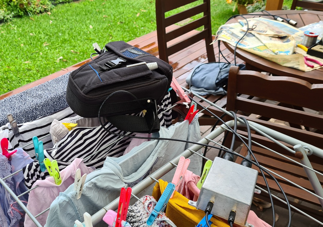

Here are a few recordings I did using Audacity on the weekend. I'm pretty pleased with how these turned out.
The mics are home made using a matched pair of primo EM-258 capsules.
Rrecording hardware is my 1st Gen focusrite scarlett 2i2 and the mic line driver I've been developing, which allows me to run the mic capsules off the 48V phantom power.
There may be a small difference between the channels in the very low frequencies. I think the left channel currently has 1uF coupling caps and the right has 100nF. Left channel the line driver is flat to 10Hz, right it is down about 0.3db at 20Hz. I'm probably going to modify the left channel to have 100nF as well.
I didn't have wind screens on the mics so there is some buffeting at points.
The mics were positioned either side of a camera snout bag to give some semblance of a dummy head.
There was a lot of low frequency noise and I've done a high passed version of the birds recording.
Things done in Audacity post recording were basically just cutting (I did three recordings of 30 minutes each!) and normalizing the levels. I think with the thunder I normalized to -1db and the birds to -3db. The second birds one I also did a high pass at 150Hz 24db.
A pic of my mic setup is attached as well 😉 The rain_and_thunder_3 one the mics were not in this position but were instead on the table in the background and I think oriented so that the left mic would have been parallel to the wall. You can see a spectral imbalance between the channels in this one, I'm guessing due to wall reflections.
