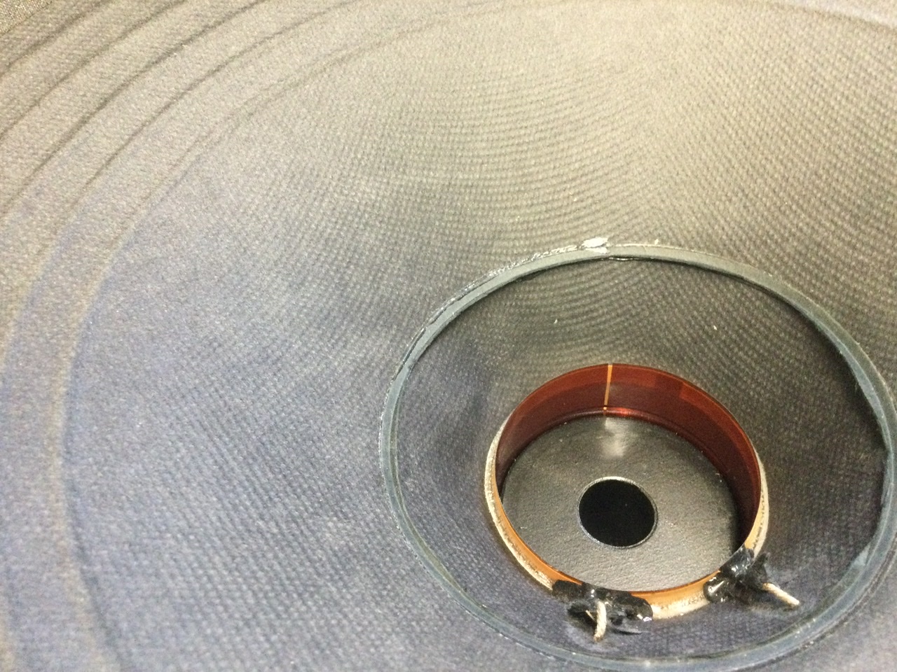

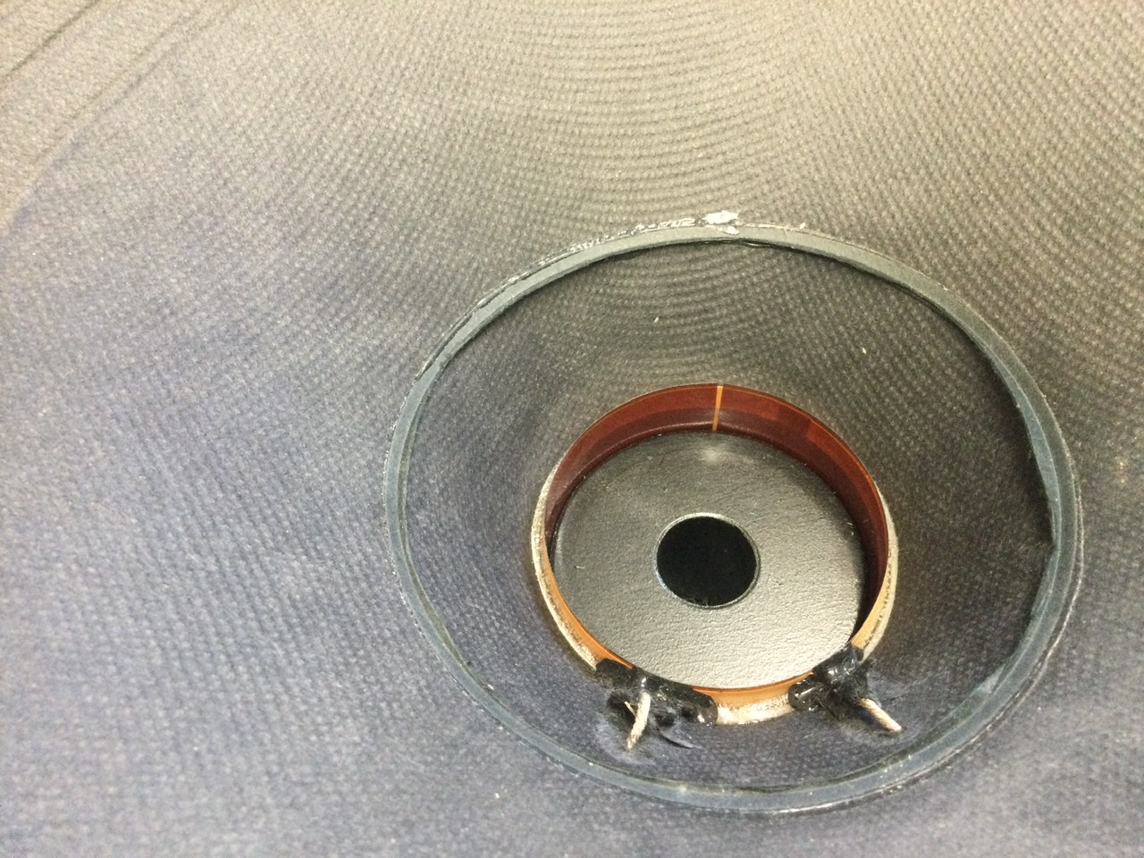

Anyone know where to get a recone kit for a Delta Pro 15? They don’t seem to sell them direct (OEM only). I had one just die open circuit the other day testing a tube amp - no sign of overload. It’s probably 15 years old, and only $150 to outright replace so it won’t break the bank, but I’d hate to just throw it out if there’s a cost effective way to fix it. No, I’m not taking it to a shop and paying $149 to rebuild a $150 speaker, but I’d buy a recone kit if it was reasonable.

That’s why I wanted to find out about getting the kit myself. I first went to the Eminence site, only to find they only sell thru reconers. My experience with repair shops is the price is double the kit price plus an equivalent amount in labor, adding up to the Parts Express price for a new one. Back in the day when I used to blow speakers all the time, places like Speaker Exchange wouldn’t sell you *kits* - spare parts used to be closely guarded. Just cheaper to get a new one from McGee (then MCM, Consolidated, and PE over the years). The reasons cited was that the manufacturers didn’t want their reputations soiled by hack jobs. I haven’t blown an LF driver in years, other than on purpose, and it certainly surprised me that one in a 2x15 cab just quit for no reason. I’m certainly willing to give it a go before just ordering a new driver - that system is not in the critical path. I dropped in a pair of Kappa15LFs that I had on hand for the time being. The grills don’t fit well with those, and I had another project in mind for them so it’s not a long term solution. It does let me test my new 6x6550 monoblocks with full music power. It’s loud, very loud, but very clean.
My last dead eminence happened where the tinsel attaches to the vc wire. It was a very easy fix.

That.My last dead eminence happened where the tinsel attaches to the vc wire. It was a very easy fix.
Jn
Was chiming in to say exactly same.
Given the "for no apparent reason" bit it might very well be a open tinsel wire (relatively easy to replace) *or* broken VC wire *just* reaching the tinsel wire joint which takes steady hands and very sharp eye to mend.
Check under good light, using closeup reading glasses (+4 diopters) or even jeweller´s loupes (10-15X)
An old trick to check tinsel wires is to apply some DC to speaker 😱 , say 5V from a PC supply, in principle it will not react (it´s open) and move it back and forth with your fingers, also move tinsel wires around.
At some point they might make contact again, confirming the suspicion.
Working in a darkened room will show the blue sparks where the break is.
IF Eminence used an eyelet as the joint, it´s easier to repair; if , like many do, they just punched through cone paper, passed tinsel wire through hole, wrapped voice coil wire around its end, soldered it "in the air" and glued/gooped the whole junction for stiffness, it´s way more annoying.
In any case, check it, you might even need no new kit at all , just lots of patience and dexterity 😱

The tinsel leads are well-gooped where they attach to the VC wires. First thing I did was pull the dust cap for a look-see. I would need something that dissolves goop without dissolving the cone in order to even check it. Moving things around doesn’t seem to help any - I already tried manually moving things to X-lim and pulling on the tinsel leads.
My most common failure in compression drivers is the lead-in wires fracturing, where the coil meets the diaphragm. The wire is subject to constant flexing, at fairly high frequency. Often I can take a turn off it and fix it, but it becomes even more prone to the same failure mode. It will often last until I can order a new diaphragm, though.
You should be able to scrape the goof off. In fact, just scrape a little off the vc wire insulation to check continuity.
My experience with compression drivers is that they fail exactly where you said. However, the reason I find is that the vc wire is not supported by epoxy, so is able to move, and it is still within the gap field. The current flexes the loose wire until if fails due to fatigue. Under a microscope, this can be seen as slip plane dislocations on the surface of the wire near the break.

The goop doesn’t exactly scrape off. I’m having a hard time getting it off at all - it’s sort of rubberized. Came off the cone in one piece with the wire still embedded. But taking a look closely I’m seeing something concerning, which might have been the reason for failure. It doesn’t appear to be built correctly in the first place. These drivers are supposed to be overhung coil. I’ve had dust caps off the 12” version before, and the coil overhangs the gap like one would expect. This one is offset the wrong way. I have to push the cone *up* significantly to see any coil. It also plays louder that way. First image is in rest position, second is with me pushing up in the cone. I may want to recone it anyway, just to put the coil where it’s supposed to be.
