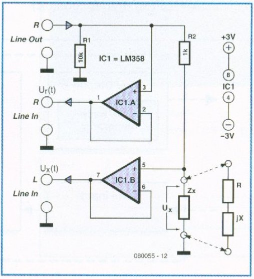

other things needed
a good lap top or desk top computer
speaker work shop program (free)
crossover designer 6.0 (Free)
crossover simulator (Free)
a very good soundcard
and a good spectrum analyzer program (might be found for free or inexpensive 40$
build a test jig very inexpensive
WWW.virtins.com
and download a acoustical electronics glossary
you can still get great sounding speakers and not have to use the latest and greatest components for the are so many things that affect the sound and most of the cost is the trial and error stages of building a great sounding speaker
so making jigs that have movable but sealible compartments is a plus.
