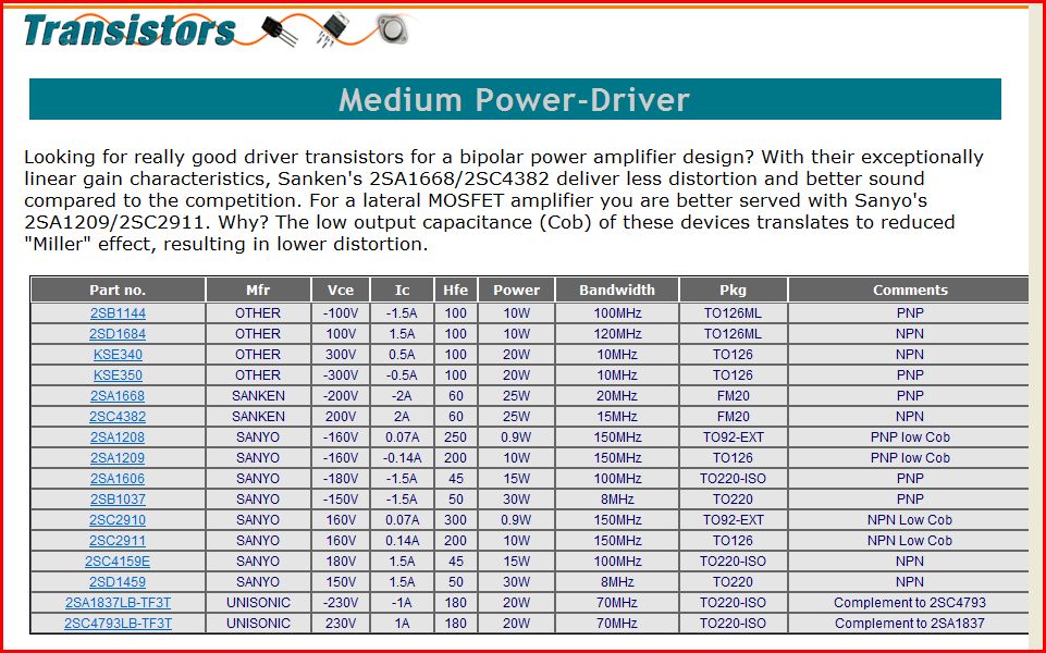

Some modern drivers here,
The ISC transistors are poor quality - there are a few threads about this. They are also responsible for cheap, unreliable clones of Sanken power transistors.
Fairchild do a whole suite of power transistors suitable for amplifiers - a good "one stop shop" especially as you can buy from them directly.
KSC1845/KSA992 - Small signal for input stages etc
KSA1381/KSC3503 - TO-126 Fast linear transistors ideal for VAS stages
KSC2690/KSA1220 - TO-126 Small driver transistors for driving 1 or 2 pairs of outputs
FJP5200/FJP1943 - TO-220 driver transistors
FJA4313/FJA4213 - TO-3P package 130 watt output transistors
FJL4315/FJL4215 - TO-264 package 150 watt output transistors, clones of 2SC5200/2SA1943
Onsemi also have good driver and output transistors - look in the "Audio Transistors" category of their site.
Sanyo also have some good ones, 2SA1209/2SC2911 particularly as VAS parts.
