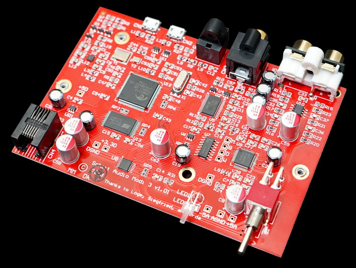

One thing a bit disappointing in the Modi 3, is that almost all components are tiny SMD ones:
In many DACs you see big thru-hole components,
probably because of an effect on the result..
IMO SMD is an advantage. If designed well, smaller means lower noise. SMD = continuous earth beneath the components. IMO the only exception are coupling capacitors where good quality cannot be small.
Interesting.
I thought Thru-Hole components are usually better for sound, because they are bigger,
there's more room to make everything needed, more room to separate what needs to be separate,
and easier to make them more accurate..
and I thought that's why in many DACs you see big thru-hole components being used..
Larger = larger area = more emitting and more receiving . What "room to make everything needed" do you mean specifically? Capacitors are a different story, they need room. But quality capacitors are made in SMD too, though the selection is smaller. Coupling and filtering capacitors make sense in TTH.
Separation is a question of proper layout.
If an SMD and TTH component have the same params, I would pick SMD, especially for a larger-series project.
