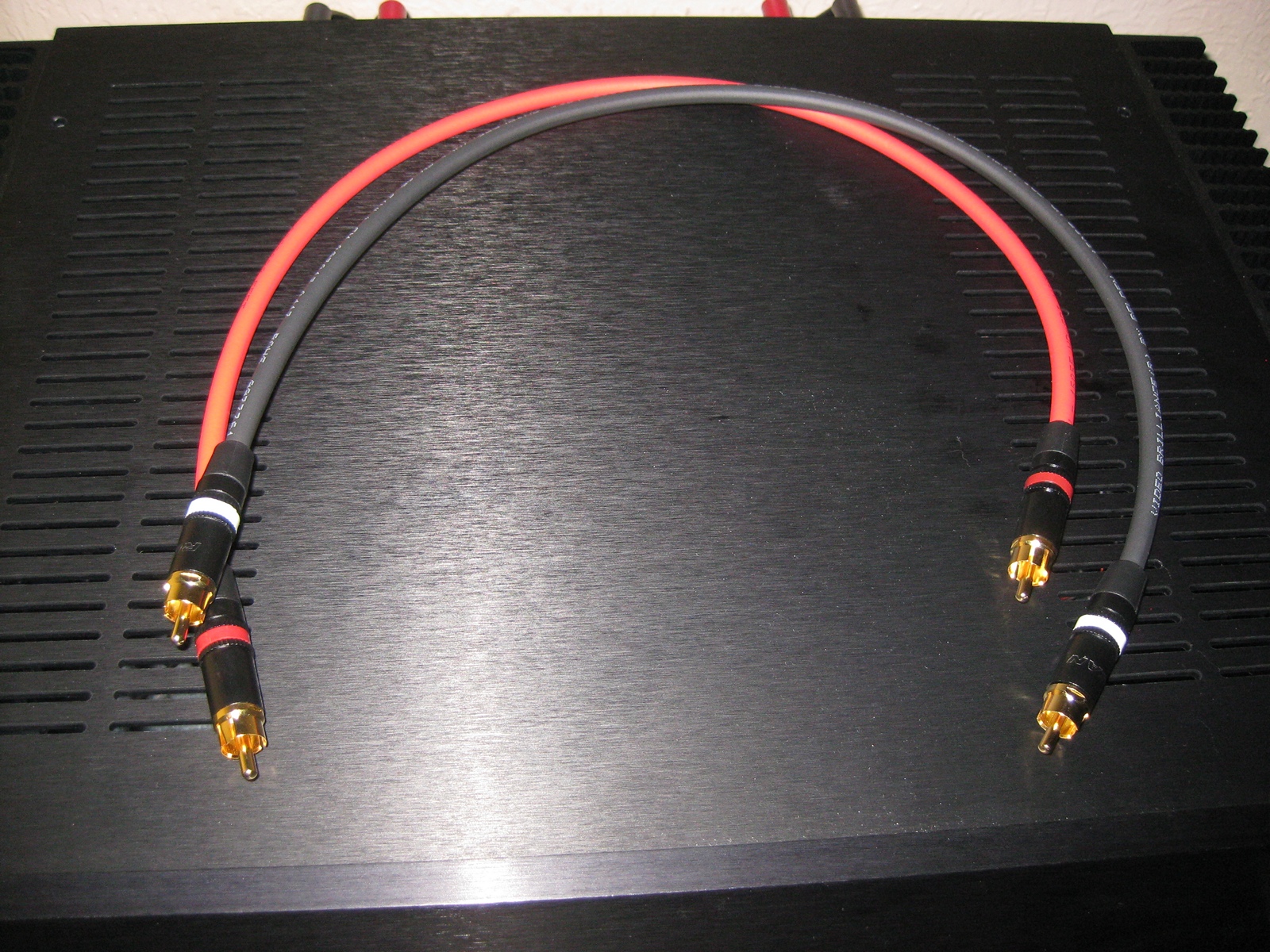

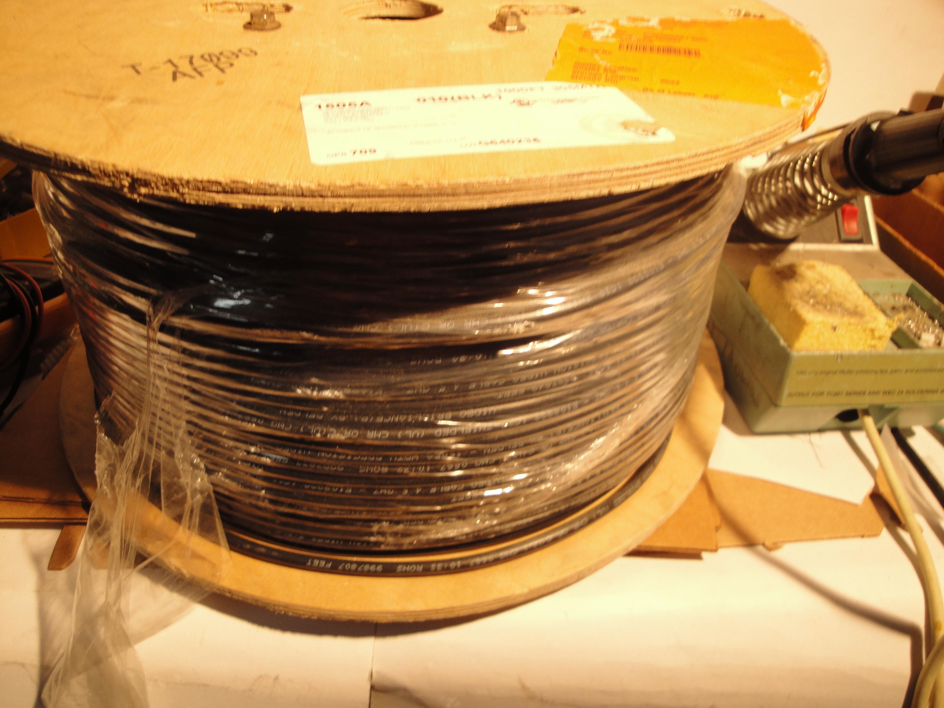

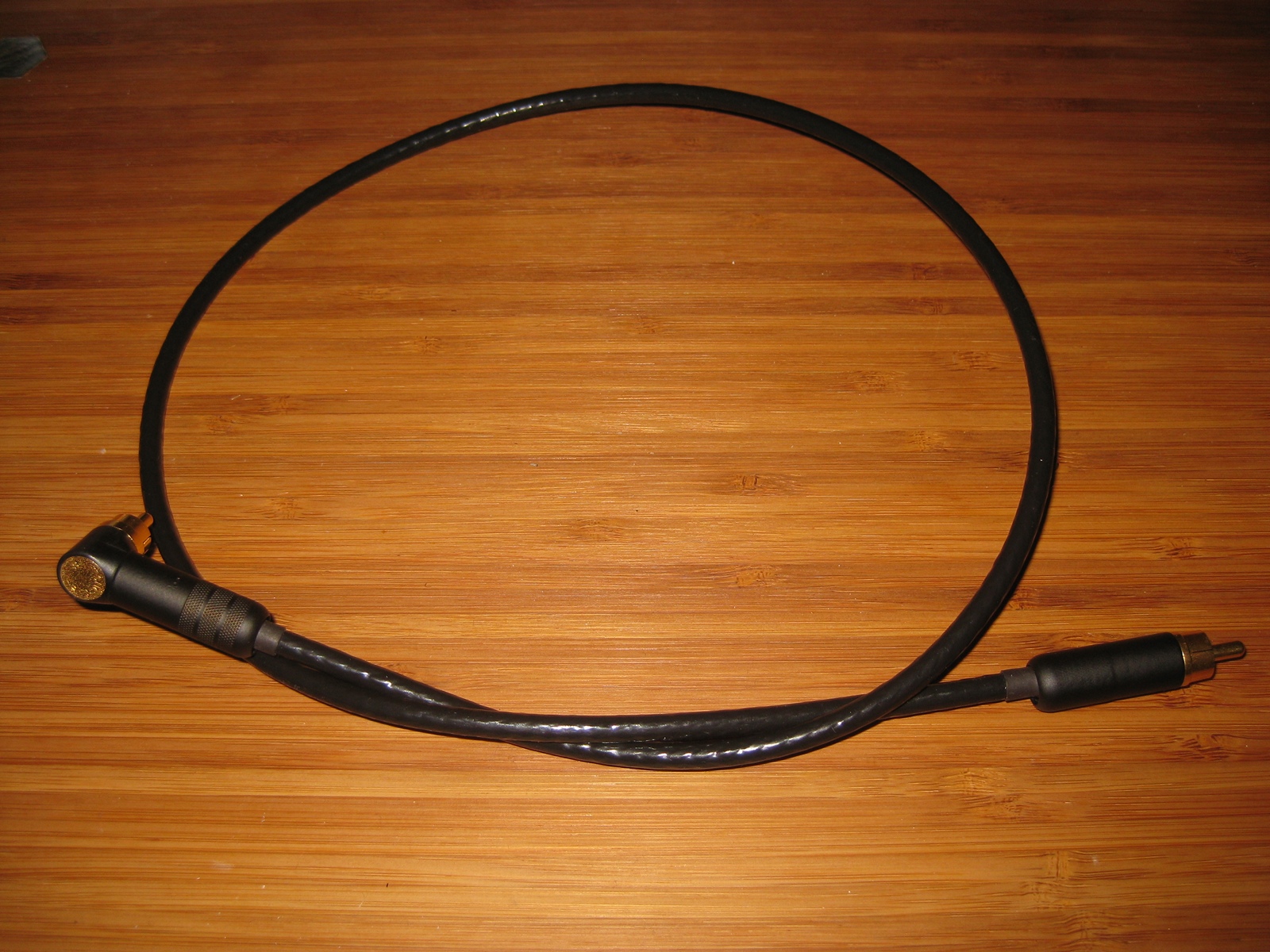

I can recommend Belden, the two types i have used are,
Belden 89259 http://www.belden.com/techdatas/metric/89259.pdf , plain copper shield and conductor, Teflon insulation, 4.9mm overall diameter, 56.7pF/Meter. Only downside is its fairly rigid and inflexible.
Belden 1505F http://www.belden.com/techdatas/metric/1505F.pdf , tinned copper shield, plain copper conductor, PVC insulation, 6.1mm outer diameter, 55.7pF/Meter. Softer and more flexible than the above, also available in various colours.
Attached pics of both types...

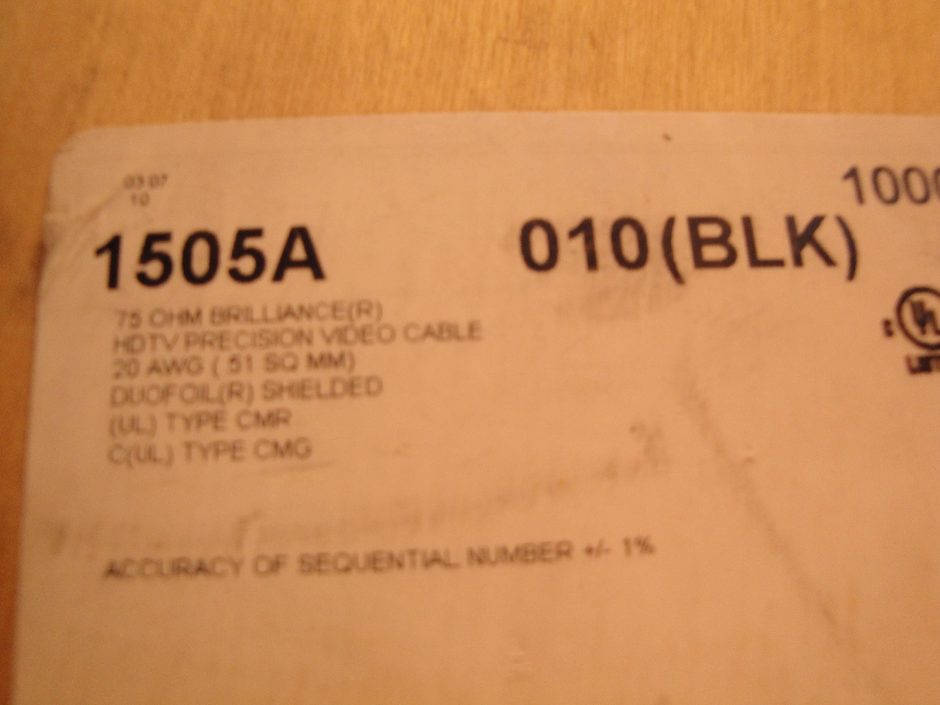

I use belden 1694a. I have also used belden 1505a in the past, but 1694a is my goto.
IIRC the 1505f mentioned above is very similar to 1505a, just more flexible, and 1695a is the plenum version of 1694a, but don't take my word for it.
