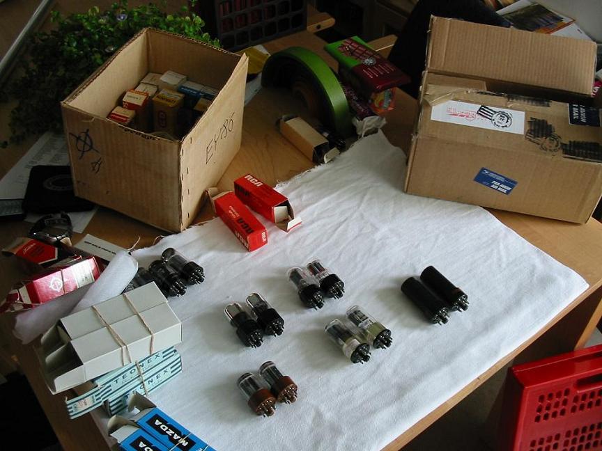

Hello fellow Dutch tube-addict !
i fully agree with swapping the Chinese junk to more fine-sounding tubes.
Sorry; i can only speak on the 6SN7. Tube-rolling was EXACTLY the reason why i use this type so often. By simply swapping the 6SN7 "A" to type "B" you can really change the musical presentation without touching the soldering iron. Now that is handy indeed !
The technical data of this tube is very versatile. I found someday a notice that: "the 6SN7 was the tube that the USA made great". Now there are of course always nicer choises but for versatility......
Besided that the 6SN7 is made by a lot of manufactorors and there is a lot to choose from.
I got more than 100 matched 6SN7-pairs here......collecting them for quite some time.
In my set (picture included) you'll find the 6SN7:
- as the input tube of the 833-amp;
- as the main tube of the headphone-amplifier;
- as the output device for the phonostage.
What sound are you look for. Every 6SN7 has of course it's different "sound", but that is obviously very depending on the schematic/components/complete system.
So here are MY remarks, based on MY set.
1. Top:
My advise: get some pairs and start finding what YOU like (which is quite depending of the rest of the chain).

Sorry.....was not finished yet !
Top of my list:
- Raytheon VT-231 (box anode)
- CBS-Hytron 5692
- Tung-So, VT-231 (THE roundplate)
- Sylvania 6SN7A
- Sylvania 6SN7W
- Ken-Rad VT-231
- Brimar 6SN7GT (oval plate)
- national Union 6SN7GT
Middle of my list:
- Hytron 6SN7GT
- Raytheon VT-231 (wafer-plate)
- GE 6SN7GTB sidegetter (green markings)
- GE 6SN7GTB sidegetter (Canadian manufacturing)
- GE 6SN7GTB topgetter (Japanese manufaturing)
- Sylvania VT-231 (chromedome)
- RCA 6SN7GTB
- RCA VT-231
- RCA 6SN7GT
- Philips ECC32
- Mullard ECC33
- Valvo 6SN7GT
Bottom:
- Sovtek 6SN7
- National (by Richardson....re-stamped Sovtek)
- Teonex (re-stamped Chinese)
- RCA 6SN7GTB (coin base)
Again: strictly personal. And every tube has it's fevourote settings. Try a 5692 at wrong voltages.....you're treated with screaming highs !
As told before: you're welcome for i will not photograph every different 6SN7 i got ! But i do know i got a lot of them and you're more than welcome to start some tube rolling set here.

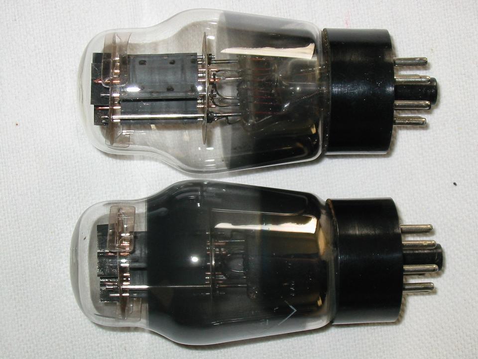

Hi Andy,
the ECC32 and ECC33 are octal 6SN7-variants. The ECC32 is a straight subtsitute (but note that these beauties gobble away a lot more filament current). The ECC33 has a somewhat more higher gain.
Oh....these are not really cheap.
Included a picture of the ECC32 (2 variants)
