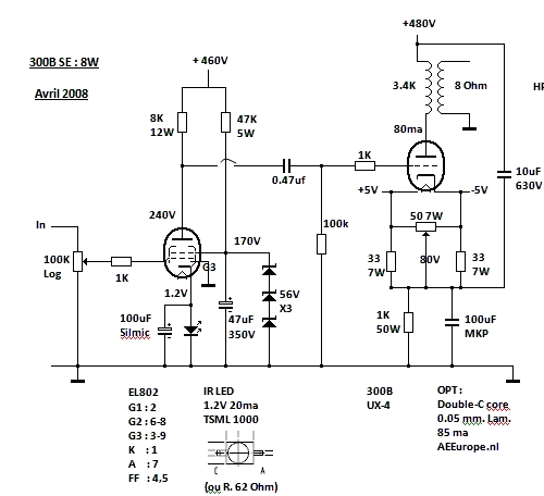

Best sounding in pentode mode (on my plan) : 12GN7, 12HG7, EL802, EL183E
why do you use 10uf Cap connected K to B+ of 300B ?Best sounding in pentode mode (on my plan) : 12GN7, 12HG7, EL802, EL183E
Yves07 advises to do with this explication :
It shunts some power supply ripple to the cathode to cancel the ripple on the output. The value of the cap from cathode to b+ should be [(C cathode to gnd)/mu]. I've found some fiddling with the final value necessary for complete ripple cancelation.

seems that I have read this item before... does it reduce hum ?
If the amp has no hum, is it nesessary to get this Capacitor ?
I wonder if C 10uf here is also the shunt some audio signals from Ka to B+ ?
Yes it reduces hum (b+ ripple).
You are right some audio signal will also go that way. Any alternating voltage, audio signal or noise signal will follow any path to a steady (non-alternating) node, either gnd or b+. In this case 1/10 of the audio signal will go to b+ since the cap to gnd is 10 times as large as the one to b+.
Isn't it Lynn Olson that has a good write up on signal paths and actually recommends bypassing the cathode to b+ and not gnd? In practice this only works when the b+ has extremely low ripple tho.

Could you give me the formula of calculation on ripple of PSU ? what level does need this C bypass ?
Many thanks.
I meant in the case of bypassing the cathode to b+ only and not at all to gnd, then the b+ must have very little ripple, or the ripple will get amplified by the tube and you will have loads of hum.
To calculate the cap values see post 12. (C to b+ should be 1/mu of the C to gnd)
1/Mu+1... In practice the ratio is not that critical until you over couple ripple from the B+ supply into the cathode.. You can achieve quite significant levels of ripple reduction on the output.
