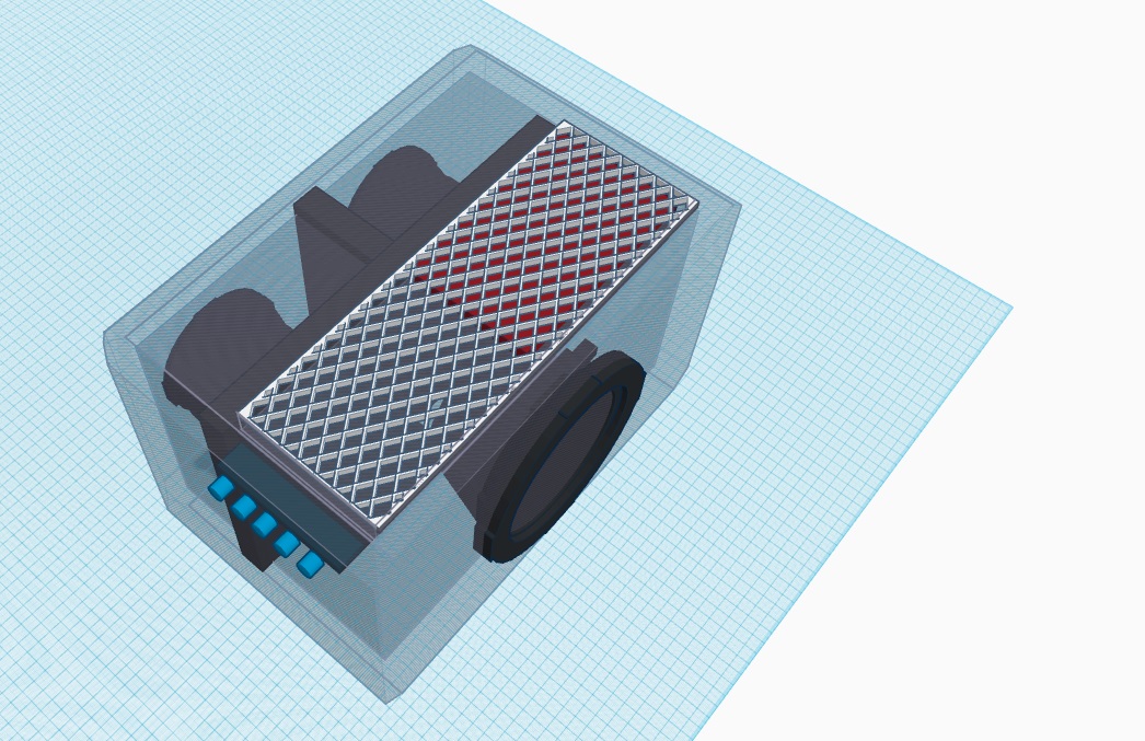

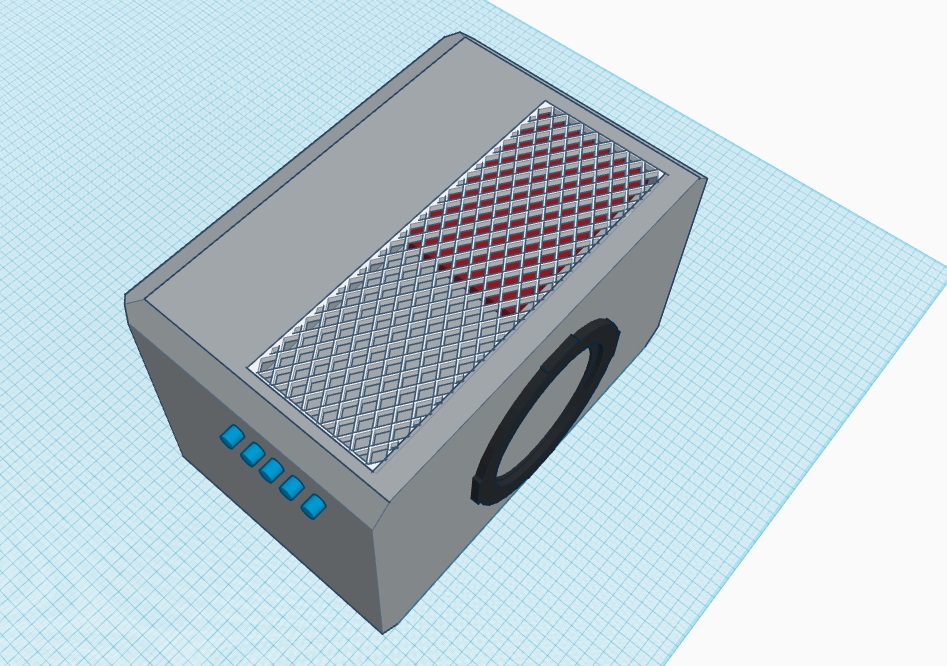

Re-Design option:
I should be able to find a way to place the power supply inside the sealed compartment but having it stick out at the top and have a mesh on top of the speaker (see attached images for an example, where the RED box is the power supply).
What do you think, I assume this should allow for enough heat dissipation?

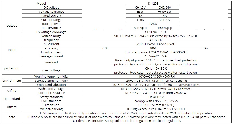

See attached image of the power supply specifications I was referring to. I'm not good with electrical and power supply, but I thought this one was rated for "CH1:5V 1-6A"?
To simplify, I might just end up with a single power output for the AMP requirements. Having dual was just an idea to have just the one power cable and have the end results nicer. This will also likely allow for a smaller power supply.
If only considering the AMP and Woofer/Drivers, would 100W suffice? For example this one, the MS-100-24 (24V 4.2A).

Re-Design option:
indianajo said:The supply you linked to also has a 5 v 15 A voltage...
You've provided a place for the hot air to get out, but no place for cold air to flow in. Cold air flow up to the PS only if hot air is pulling away from it. Cold air won't flow down if the hot air is pushing up on it. No convection, you need a fan. Or a heat pipe, which is a gadget with solvent in it and a wick to make heat flow through round holes, sideways or down even.
Be aware acoustic suspension requires a sealed box - whether it is the whole box or only part of it. Once you put in holes for the back side of the woofer to pump air on, you need to do bass reflex calculations to determine frequency response (or build it and approve or criticize the sounds). Based on experience, a speaker in a dashboard with about 2 feet path for the backside air to reach you, has a lot better bass than a speaker mounted on a hole in a board standing up in the open air. Even a cardboard box with four closed sides and an open back helps bass.
24 v only supply might work but don't expect 100 W out of it @ 24 v. Maybe 50. Still don't know if your IC is class AB (1/2 rail voltages maximum available) or D (closer to the rail) and I'm not going to read the datasheet for you.
