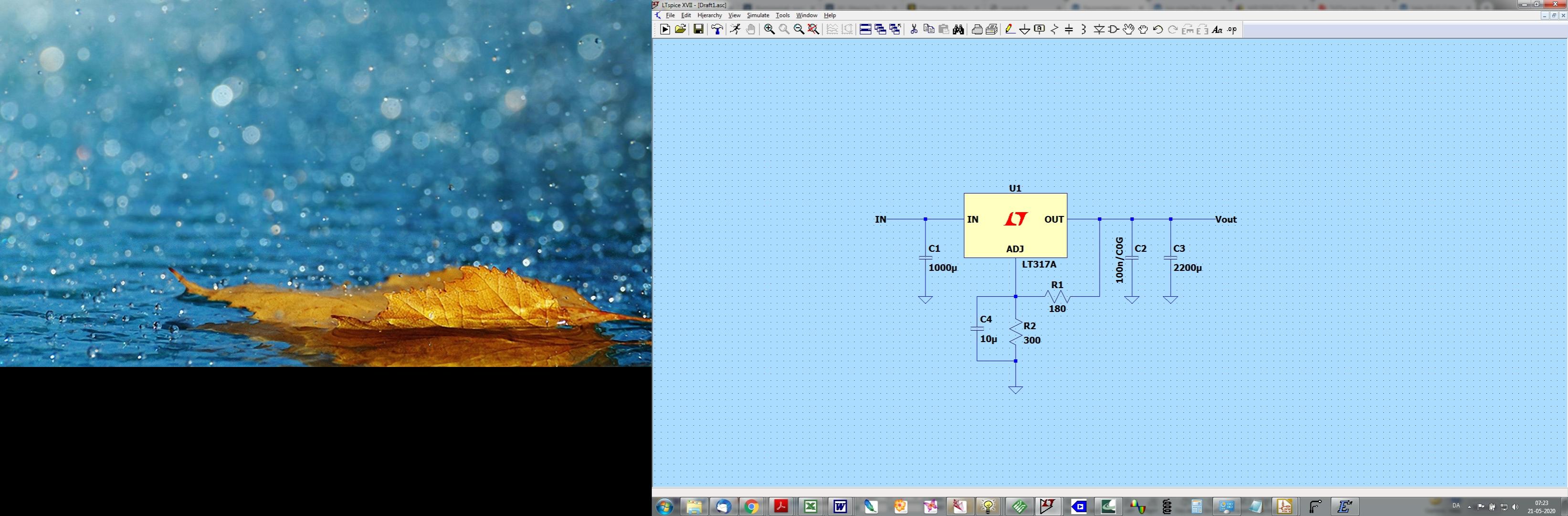

, the LT3042, or (again if it were me) wait until the batteries become available. FYI I have attached an LM317T circuitry that will sound reasonable (depending on the components you use - nichicon fine gold, KZ could be suggestions) - I'm thinking it could be used for a start. The extra leaf & rainwater drops are because I use two screens and my HD is currently full so that I cannot edit the size 😛
You may, of course, also use the PSU you linked to yourself (if you can get it?) - I would add some extra higher capacitance capacitors on the input and output.

are quite lovely and calming...🙂The extra leaf & rainwater drops
The AMS1117 ? I have this currently and your suggestions would be very easily made...You may, of course, also use the PSU you linked to yourself (if you can get it?) - I would add some extra higher capacitance capacitors on the input and output.
