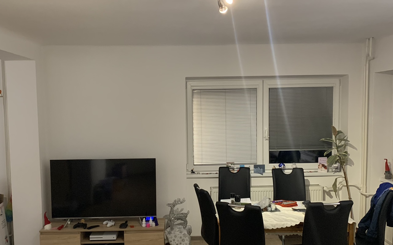

My living room arrangement is really speaker unfriendly. Its dimensions are 578 x 391 x 250 cm (L x W x H) and there are basically only two places for speakers on the front wall.
1. in the ceiling corners - max box height ca 33 cm - or in the middle for some kind of single box stereo arrangement.

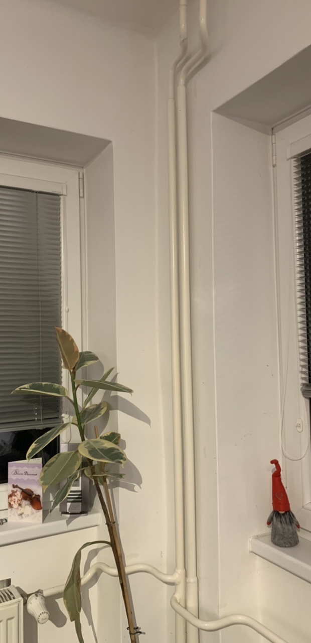

2. into the corners - line arrays 170 cm long starting at the ceiling, limited in width to about 15 cm or slightly more if built with angled baffle to avoid the heating pipes. Or small satellites (like Bose🙂 ) Or long thin DML panels masked as decorations...
There are some options for hiding subwoofers if necessary (TV table, lower right corner if made in a special shape to fit around the pipes somehow.

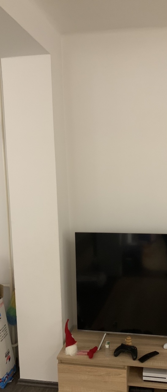

The listening position is ca 3 m from the front wall. There is an opening to another room on the left (ca 200 x 220 cm) and a window on the right of the corner.
The main use would be stereo music but they would be also used as TV speakers.

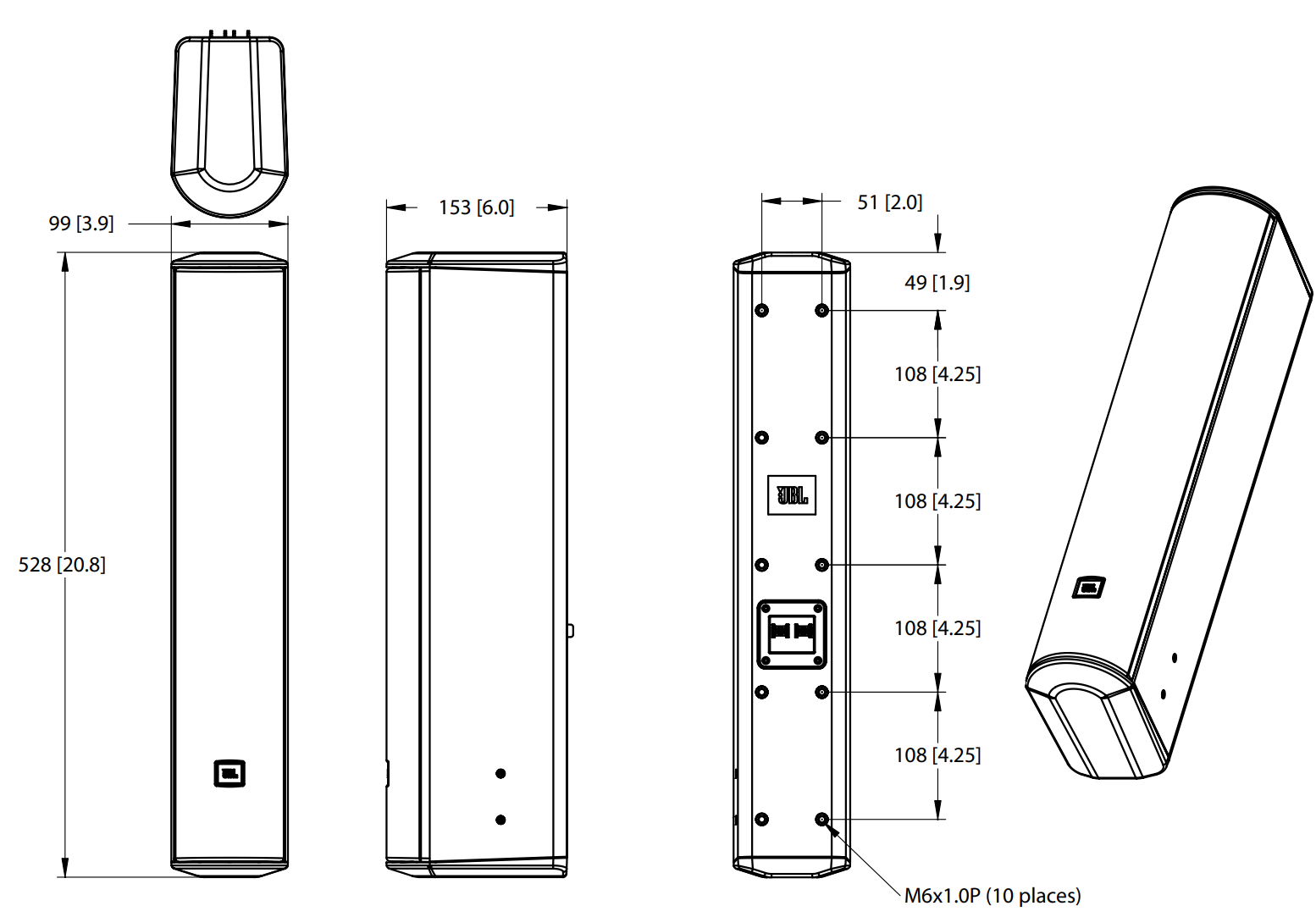

Line arrays look like a good solution. Maybe slightly angled so you get adequate vertical coverage when seated. 2" full-range drivers are a good compromise. Should give a nice clear big sound. And a sub as you mentioned.
I wonder if the line array would not be too short and if it is a problem that it starts from the ceiling. It looks like it is time to fire up VituixCAD, angled is what I would intuitively do, not sure if that will improve things or not.

that's a challenge because the layout of the room wrt the TV position is very asymmetrical
BUT there is a solution for You, and it is one with a very high WAF, just move the TV slightly to the right, then You can place a stereolith-like loudspeaker behind the TV and there You are - You have a "single stereo speaker with direct sound blocked", best solution for Your need - "for the family" listening to some music and watching TV
Yes, the TV can be (and at some point will be) shifted to the right to the window edge, the table will be replaced with another one. Any recommendations for a Stereolith-like design? Side firing woofers and up firing tweeter(s) pointed at an angle sideways?
