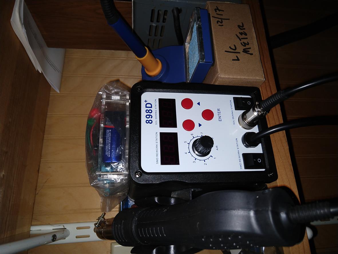

If you have not already bought a device ... I have also just started with SMD and bought an 898D station that works well and seems good value. Tips and replacement parts are readily available. These are about $50 USD on ebay.

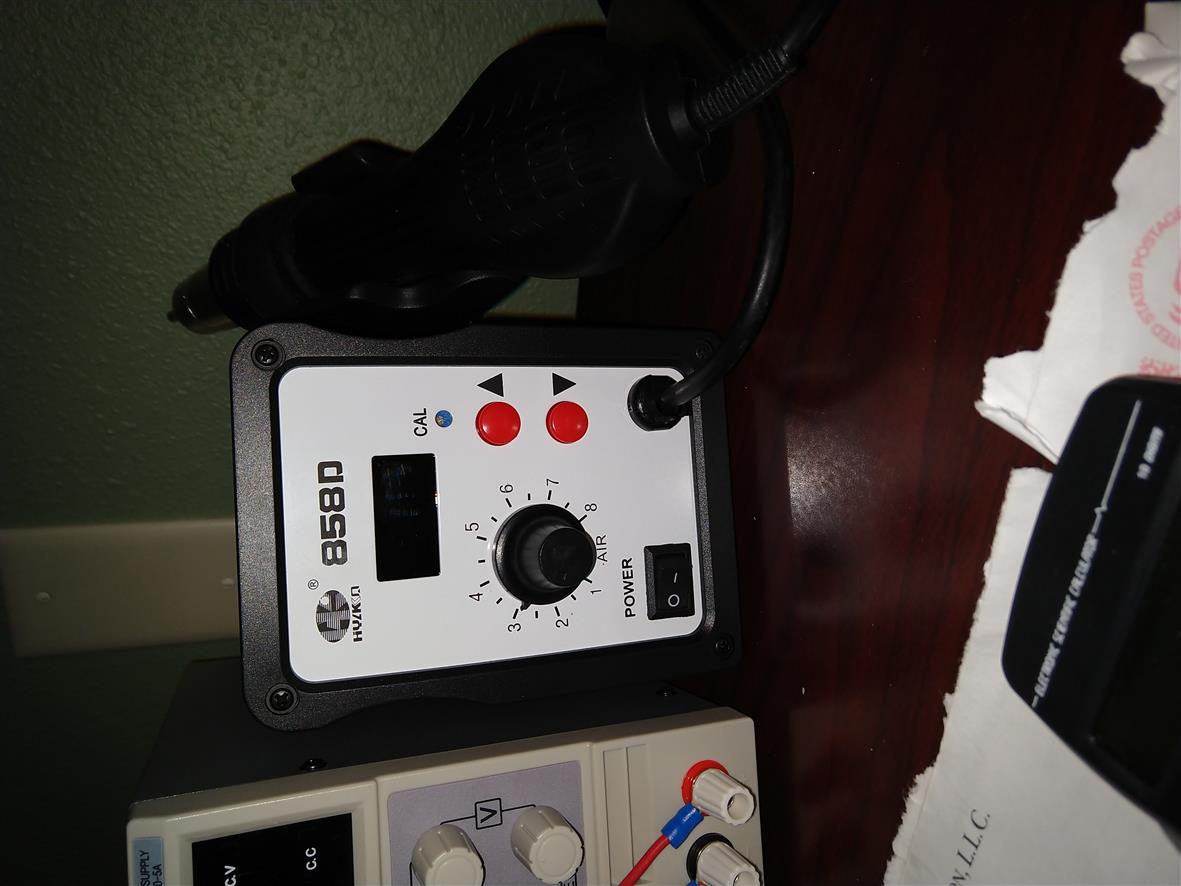

I also have an 858D, which is air gun only, in a modest workstation here at my office. It works OK, but I like the 898D better, as I think it is a better value to just get one with a soldering iron, whether or not you need it.
Hope this helps. I would be interested in what others are using.
