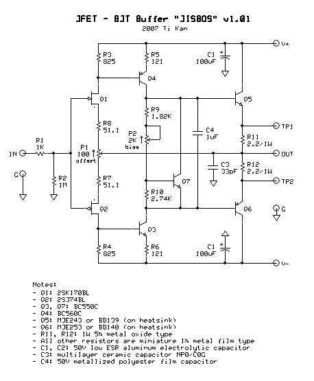

search for the JISBOS ?
Well documented design in the net

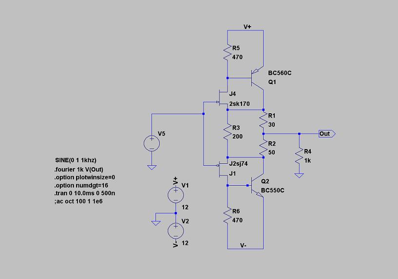

80 Euros is more reasonable, in some east european countries the minimum wage is below 280 euros. Adamus wants simple so I suggest just 4 transistors and excellent performance, a buffer used by the old master JL Hood. Wire with current gain, what comes in is what comes out and can even drive headphones pretty well. For 0 V output offset adjust R1 R2 values, R3 should be around 100 ohms. Thd levels of -130db mostly 2nd, attainable by tweaking resistor values for particular load. 😱
BTW the circuit shown by sharp is pretty good too. If you build them yourself they will maybe set you back 15 pounds or so for stereo. 😀

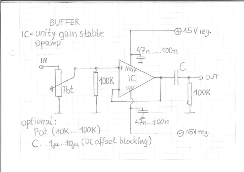

hello.
annother easy amp.
ic = ne5532(bip),opa2604(fet) or something else.....
you may test this circuit with a tl072.............
if you have a cap at the input of your poweramp you can c leave away (it is for safety,to block the offset from the ic).
47n.......100n nearby the pins of the opamp.
greetings.............

I can get parts for this from my local supplier. Any views?
Thats the JLH buffer I proposed, it will work, I built them with those parts back in 1992, the Jfets are not of the best quality though and the resistor setup I proposed takes out the adjustable one wich is noisy.
