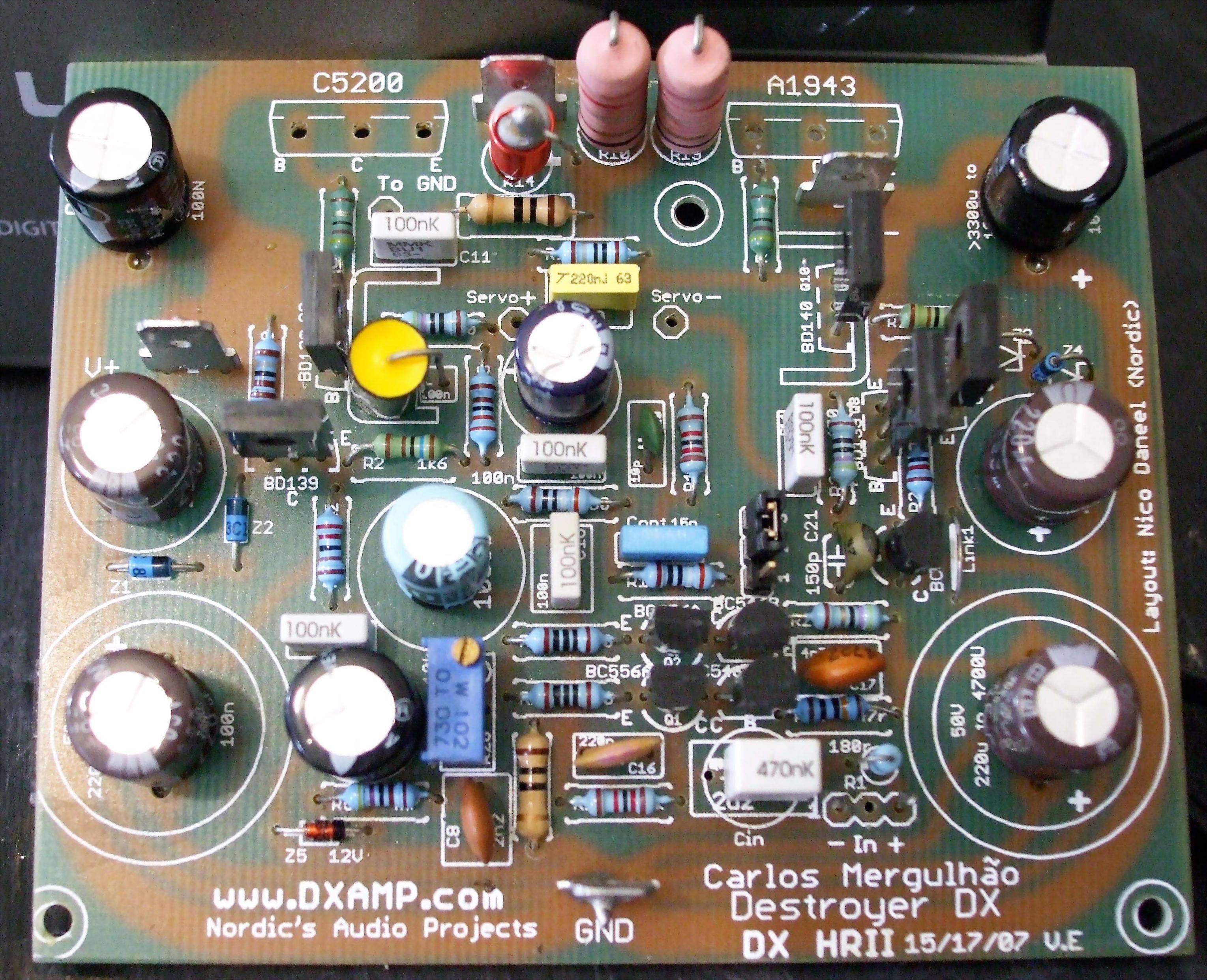

26 guys from your country have assembled Dx amplifiers
The only amp that forum that has soul, it brings a spirit of light, which provides sound divine and heavenly is the Dx amplifier, or any line Dx made ​​by an amateur like you, love like you, as a curious person and interested you, for advanced amateur ... by people like you used to listen to music, composing music and playing music as you, amplifier which was tuned using the ear to adjust, which was revamped, revised, re-calibrated, that suffered evolution, which was tested and tortured and survived, units that were assembled by hundreds of colleagues from that forum, who are playing good music around this planet, which received excellent evaluations and no complaints, it was explained, detailed, and had explained in his circuit minimum details, whose project was practically taught to those who quizessem make your own custom amp or drive ... the one that has hundreds of pages explaining details with diagrams, doodles, sketches, videos and photos ..... which has sites on the Internet showing layouts, cards, adjustments and details .... units that were made with love, dedication to the forum, made ​​with passion .... that lead from friendship and dedication to the community, amplifiers that have emerged from the projects of Aksa and Dr. Self ... something very special .... amplifiers that have a soul ... the others have only parts and components.....
to be continued.
regards,
Carlos
Dx amplifier designer, this friend you have...uncle charlie
is the one shows his face.... someone that has a face..... is the one that shows documents, pappers, adresses and so on without any kind of fear...someone that is not hidden behind a nick name or code name... a real person, a real human, a Brazilian, from the country of Samba, football and love.
.....Dx amplifiers bring joy, make you dance and make you cry with emotion ... something made ​​by you, from your effort and your hands ..... just the one that will bring you in touch with the divine, that said "love one another" ... and it was this spirit of love for others and the community that these amplifiers have emerged.
In special, your friend Dx has a family, has pictures and publish them, has videos teaching basic electronics, answer any message you send and use to help people to build, to adjust and to test...the real DIY guy.
I do not sell things, i am not a business...i do not use my amplifiers to tool or lever sales outside forum.... pirates are selling but they are not me..i am not hidden making sales using some fake adresses registered in other countries or using other languages as some bad people may imagine...i was here and i am here to help people without payment.
I can accept thank you...i can accept reviews about the amplifier and i can accept suggestions by direct email (to avoid haters to bother).
Build a Dx amplifier man.... there are many guys in your place listening a Dx amplifier.
Others will give you sound.... Dx amplifiers will provide you contact with the divine...the magic of natural sound..... music for anjos to dance!

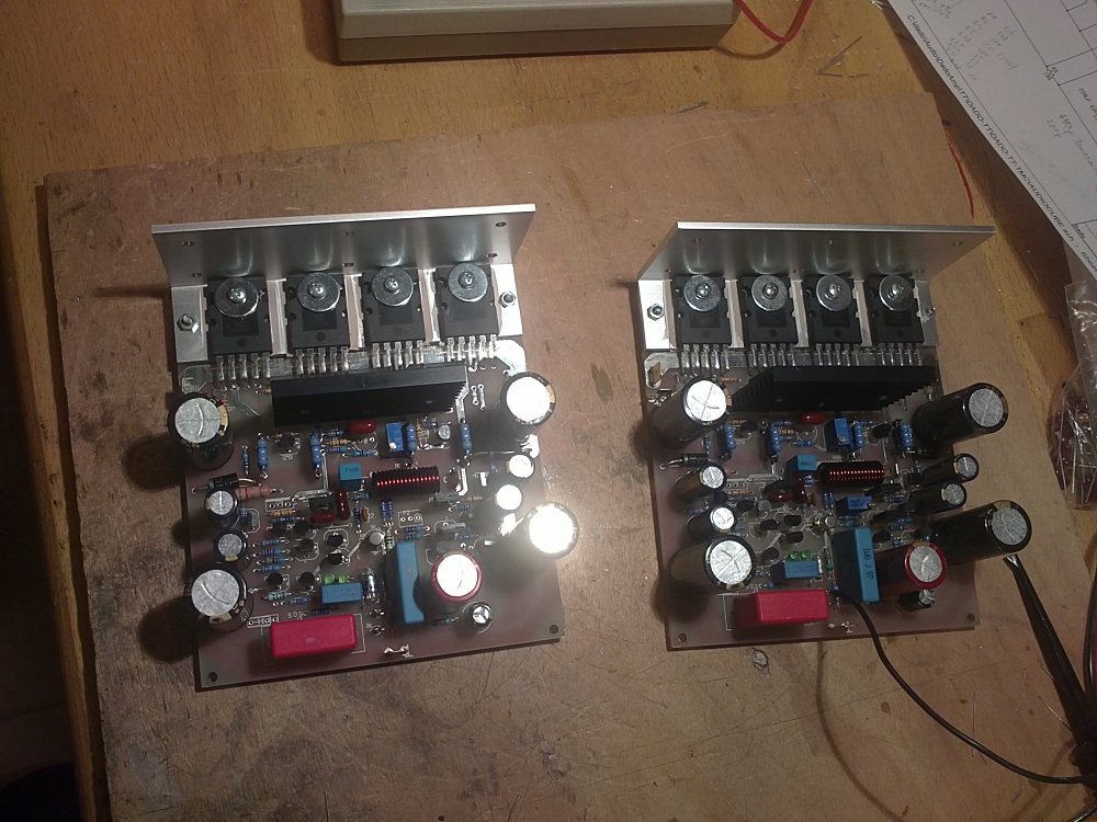

I think dadod's thread "ThermalTrak+TMC amp" has done a good job at combining several of the important topics from Bob Cordell's recent amplifier book into a design that simulates well. See post #48,
DADO-TT-triple-bufferedVAS.pdf
1) Triple T output stage
2) TMC nested feedback
3) improved cascode circuits for front-end diff stage
4) JFET input transistors
5) optional regulated power supplies
Since speakers make a larger difference in sound quality than amps.
Have you considered designing a multi-amp speaker with analog or digital electronic crossover? You could put multiple amps into one chassis, plus any necessary Xover circuits.
Now, two channels are ready for real life test.
dado
