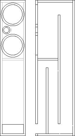

Ok.... so what if I wanted to build a Thor cabinet and use the drivers used in the 281s (2xshielded av8 woofers and 1x audax tm025f1). Obviously I would have to modify the TL design and the crossovers, but how could I ever learn how to do this?
I've been reading all, all, all day and still don't feel like I know anything about crossovers or the mechanics behind a TL design.

I have heard a few comments from people that built it -- it isn't bad. Probably designed using classic methodology, i wouldn't be surprised if more could be had out of the drivers. You would need to run some simulations using Martin's software.
I have a copy of the plans if you want to email me i can send you the pdf.
dave

Also.... I emailed you dave. If you didn't get it you can just send those pdfs to xxxx. I think I would modify the design in your picture a little bit, but they look nice.
