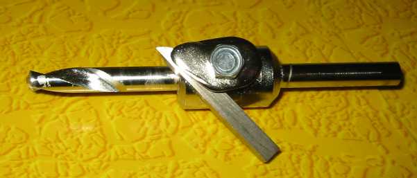

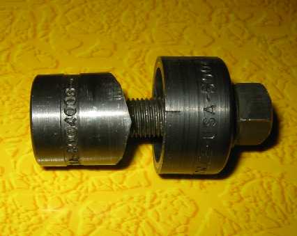

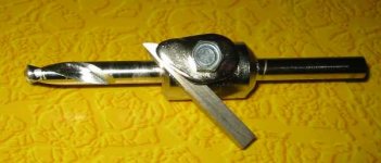

Here is what I use for large holes in up to 2mm thick panels.
